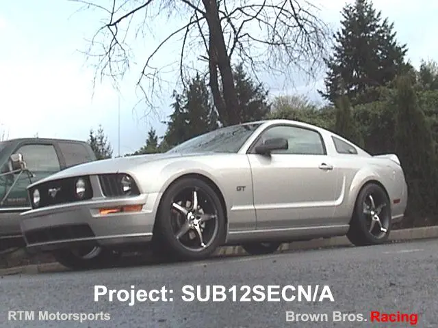

PROJECT SUB12SECN/A
Well it started actually back in Nov 04. But the Damm 05's kept selling before you could get them finished/ or even started for that matter.
This was what important.
1.The Best performing N/A Mustang using the parts that yield the greatest/best results.
2.Looks Smooth sleek and mean.
3.Your Grandma could drive it.. yet you could slaughter a C5 from a set of corners to the 1/4.
4.Using this recipe when it breeds efficiency and keeps costs down.
This will help you as we will disclose "most" parts and results to help you..

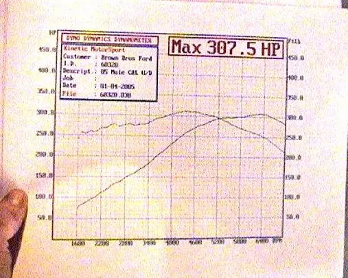

started with CAL: File for C&L from Dialbo.
Wayne then made numerous Pulls.. Datalogged and refined the program.
Next: Out came the Laptop..this is where I am in ahhhh on the guy! Tweaked and tweaked.. was able to create and flash his own custom program.
I was again so impressed. He yanked out about 5 more rwhp had a better A/F lowered the timing a touch and yanked out the valley in the powerband.!
OK the Mods! 4.6L 3V
Steeda U/D Pullies
C&L CA Intake Kit
Diablosport Pred.
Custom DynoTune with revolution software by SVT Tuner Wayne Johnson.
Chev 94oct.
Results with Stock OEM Exhaust. (dammit)
307.5 rwhp
