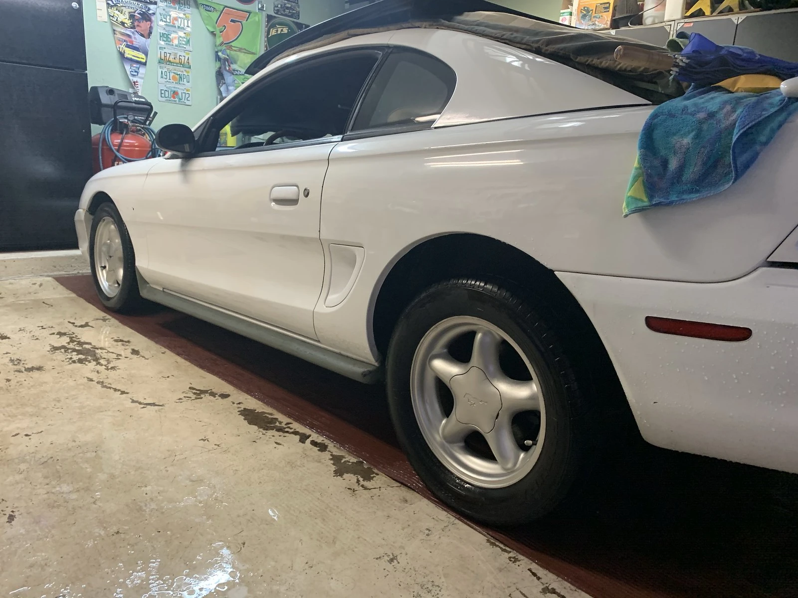

Thought I post a funny picture.
My friend who bought me the FRPP 5300-C Springs and Sub-Frame connectors, well I gave those parts back to him. In case I sold the car I would have felt bad if I profited on parts he gifted me. He has 3 Mustang's so he could use the parts anyway.
As a joke and for the meantime when taking out the 5300 springs and putting the stock ones back in I cut 2 coils off the front. Figured who cares. Problem is I didn't cut the backs.
So here is my low rider, slammed in the front.
Hey, 1977 van with chain steering wheel called......they want their stance back.
Untitled by jpjr50, on Flickr
Hey, that looks pretty good! Now you need to get some 15x10 cragar ss and a pair of g50 supercharger tires and it's 1975 all over agin! :nice:
Yes, Cragar rims with Coker tires, Chain steering wheel, Skull shifter, curtains for the windows and some side pipes.
I'm going to cut the rear springs this week to equal it out.

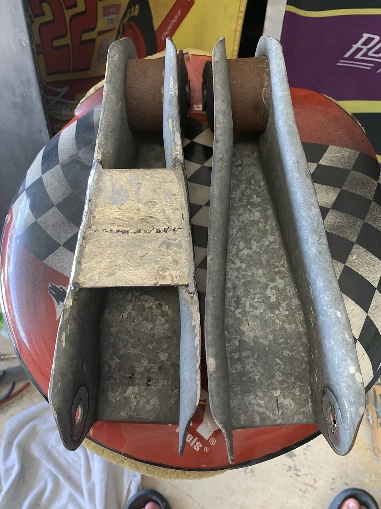

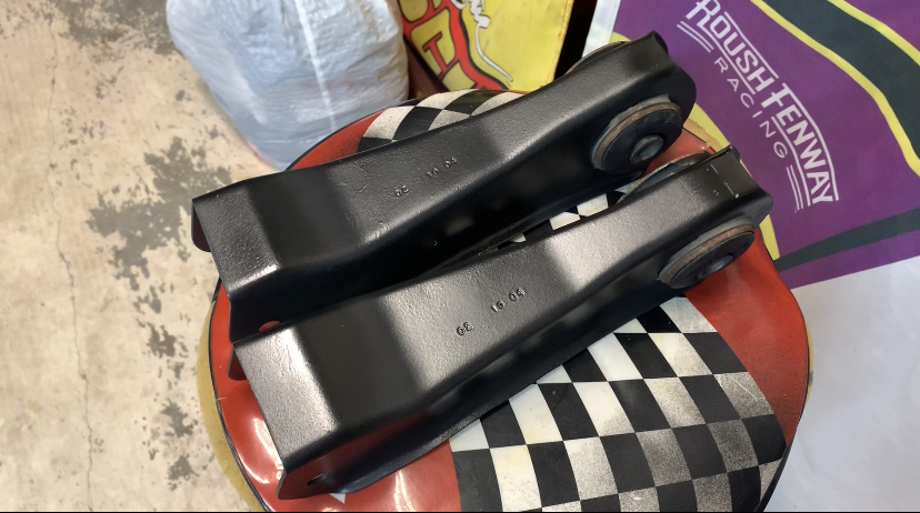

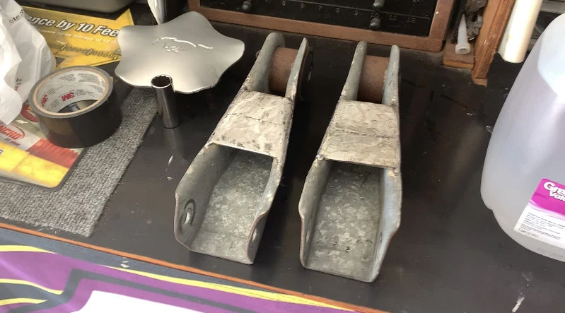

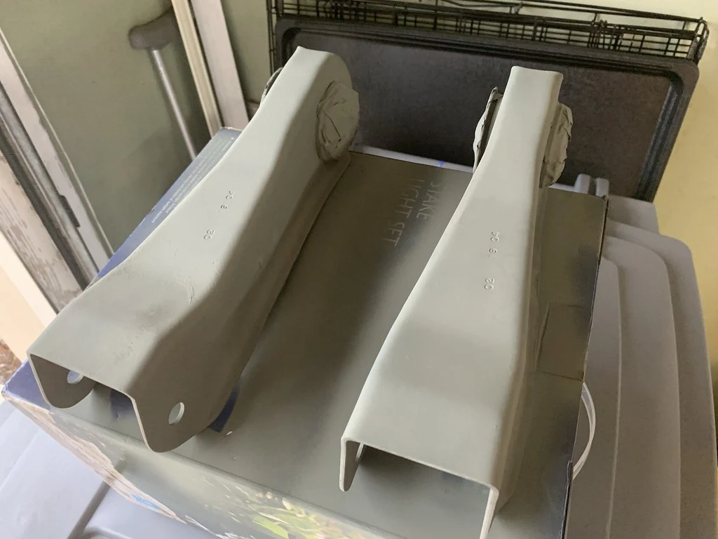

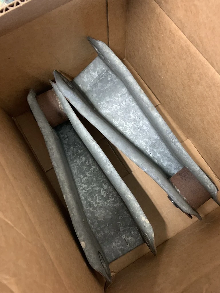

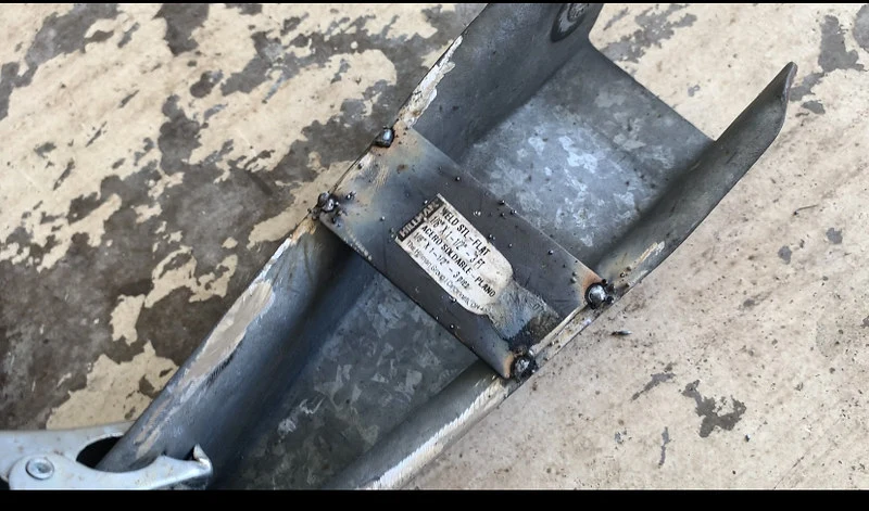

Ready for some old school mods. How about boxing the stock upper control arms. I think BBK still sells this style for $139.
I'll be adding this homemade upper control arms. Anyone have any stock lower control arms for a 94-95?
Here is the work. This will all be in the next Episode.
We used to do full plates. A buddy of mine used to box them for everyone in the late 90s- early 2000s. Would change the bushings while we were there. That's a cheap way to help stop flex.
I have new bushings for these. Now I just need to find some stock lowers or a deal on quality aftermarket ones.
