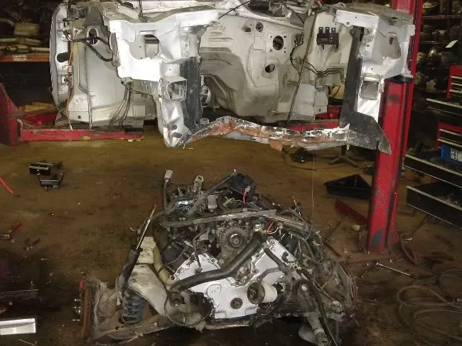

What did he do - buy a wrecked '01 for donor parts?
im pretty sure thats what he did..im pretty sure he said it was a 01..may of been a 02 i dont remember

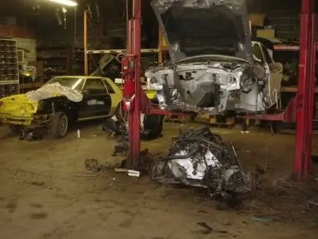

I bought the whole car for a donor. The 81 will have auto-down windows, ABS, traction control, 4 wheel disc, 2001 radio, 2001 air conditioning...most of the 2001 interior.

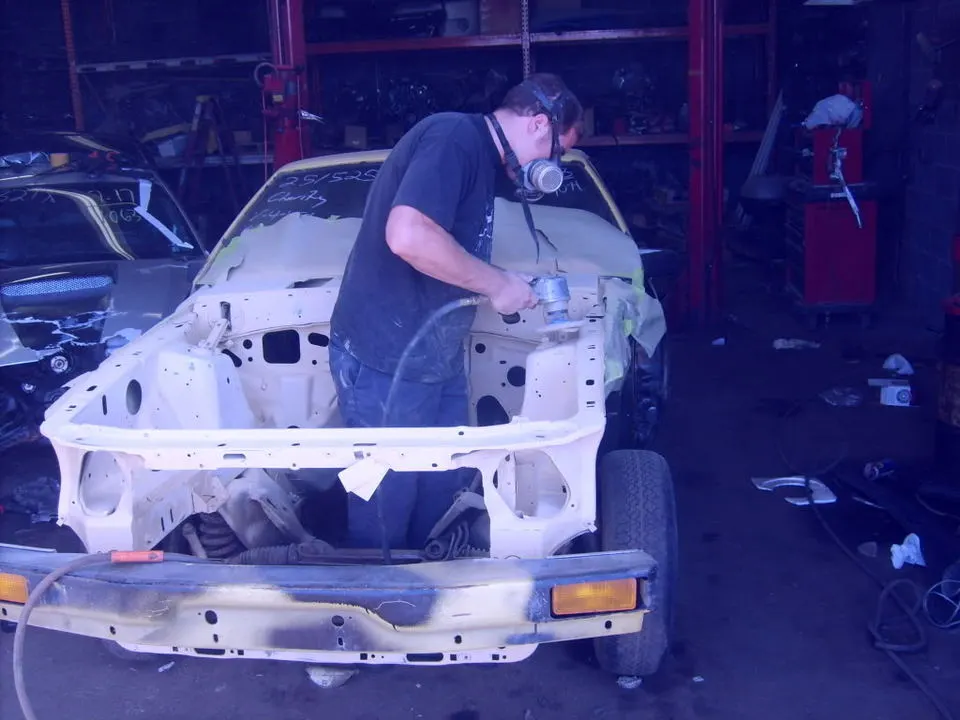

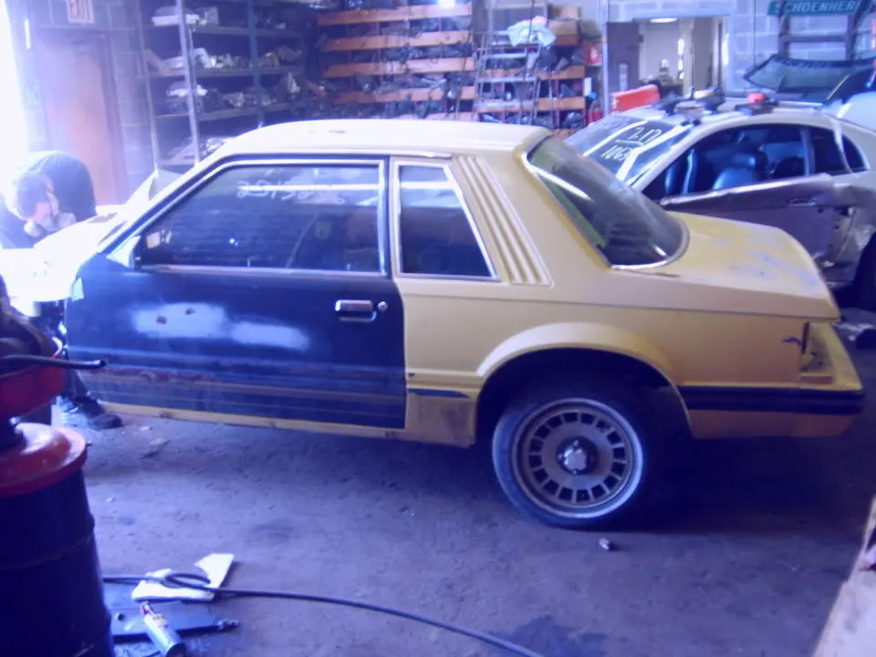

Here are never seen before photos of Project 81 Hack Job. MY buddy came over the 2nd day I worked on it....yeah the 1st day I took the car from a total driving running car, to what it is when I was painting it....I was a workhorse.
Notice the 2001 in the background drilled in the front and the left side.

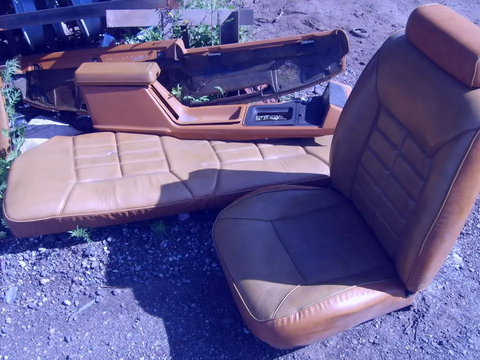

And...the FUGLY interior from the 81!!!!!

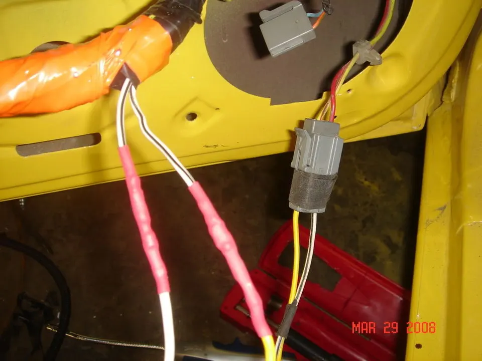

Aaron----Thanks!! This morning I took a quick hour before work and taped up the passenger side door harness, and fished it through the door. Tonight I am gonna cut and splice the plugs like I did on the drivers side....but this will be much easier as there is no master control for the mirrors. If it doesn't get too late I will tackle the tail lights harnesses and figure out what I have to do to get them to work.
