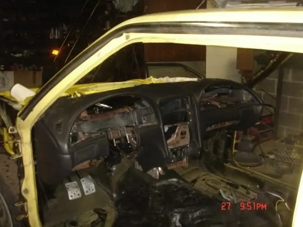

Blue Blazes----As for more pics of the dash, I don't have anything too close up, or in detail, but here you are.
Notice the center of the dash, where that tab sticks up over the body....That is now different. I had to cut about half of what you see off. It is also sitting under the body, not above it. Everything else is the same. I still have defrost, but I have yet to install the defrost vent trim. I have to trim it up, and fit it with trial and error. Not a big deal, this whole car was fabbed up. I also, trimmed the area of the dash where that little dip is (under where the defrost trim will go. That is why I still have defrost. I moved the defrost vents back after I grinded that dash pad area out of there. It got tricky, but I need defrost here in MI in Sept, and Oct. I wanted this car to have all options.

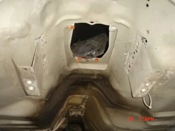

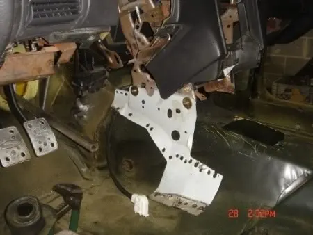

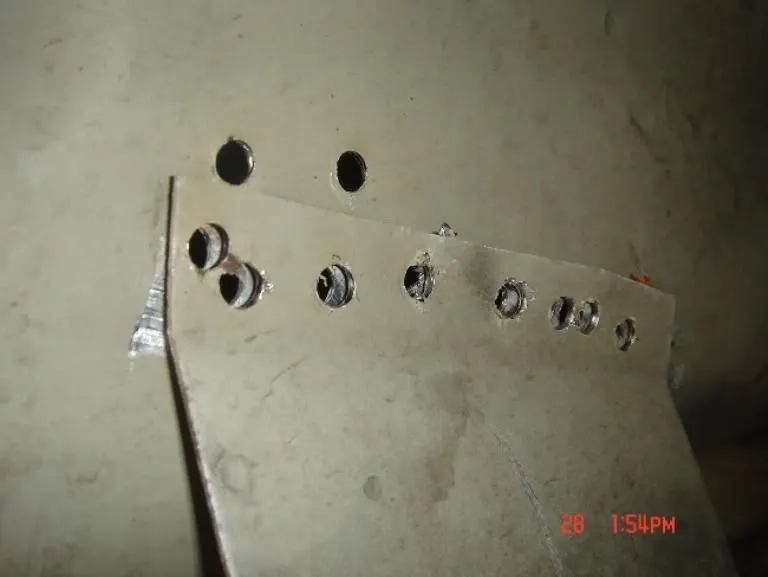

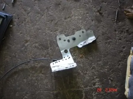

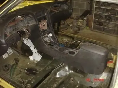

BTW....that white bracket I installed in the fox is from the 01. Notice these last two pics are of the transmission crossmember brackets. These are welded in the exact same spot as where that dash bracket is welded to..(in the trans tunnel) When Ford spot welded the crossmember brackets, the dash bracket was then welded at the exact same time. When I installed the dash brackets and those trans brackets, I made sure they were in the same spots as well. This later proved to be 100% necessary for proper fitment on the shifter in the center console.

It will also be a challenge if you choose to try and keep the fox heater/ac box and wiring. I'm not saying that it can't be done that way, because it can, but it is just harder because you need to figure out how to make stuff work. With me, I just installed the 01 heater/ac box, then, made a couple brackets to hold it in. The only thing is, you must strip the wiring off of the 2001 dash to cut and trim it. This makes it much lighter to move around, and plus you won't cut through wiring on accident!!:mad: That would suck. Anyways, after you have it fully bolted in and secure, you gotta pull it out again, and reintall the wiring, and then reintall it again. I must have had this dash in and out of the car 20-30 times. The fitment is crutial. Everything must be tight, or else you will have rattles and squeaks. Mine seems good so far. I haven't driven it yet, but nothing rattles under idel or 3-4K revs. It should be fine. The windshield also hides any ugliness at the cowl area, so don't be too concerned with that.
