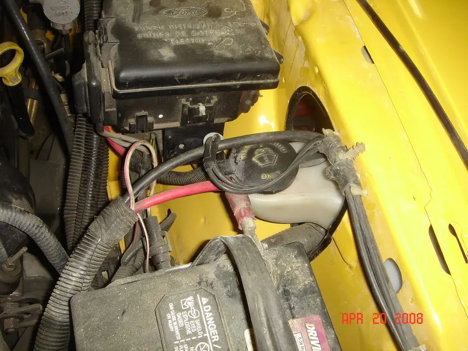

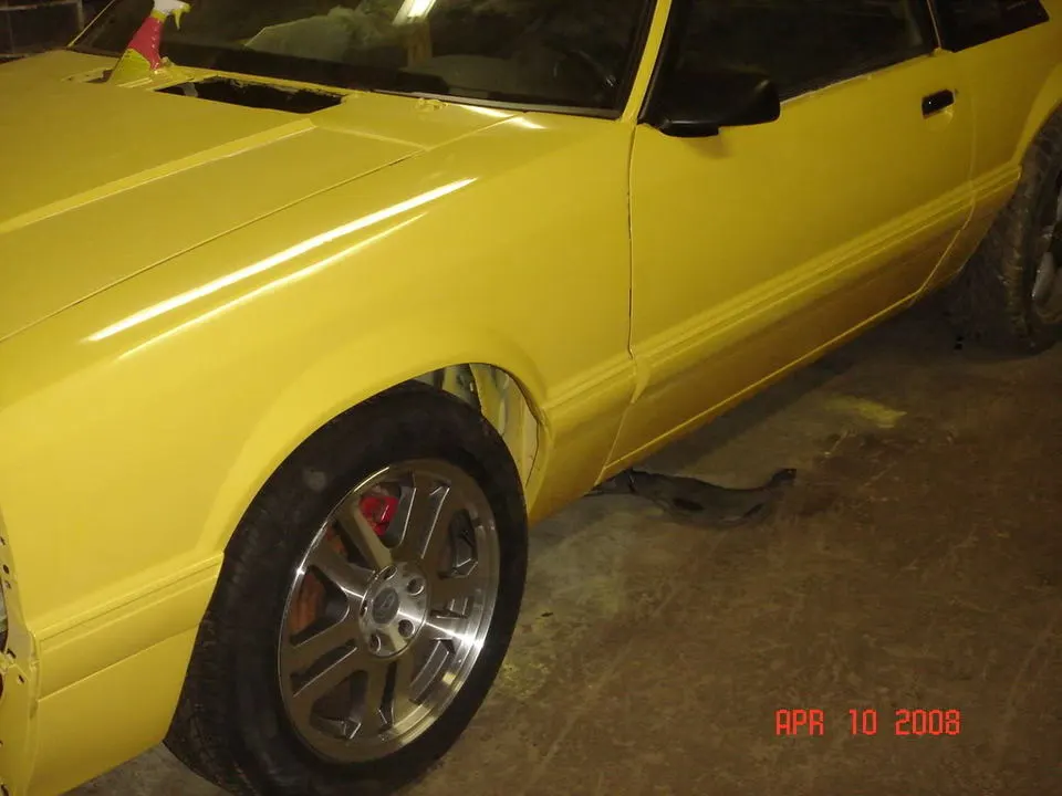

Washer bottle and lines to cowl screen installed.

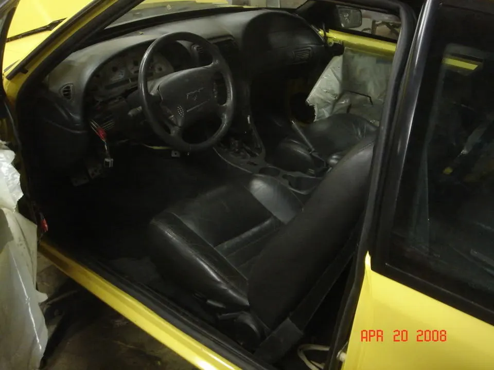

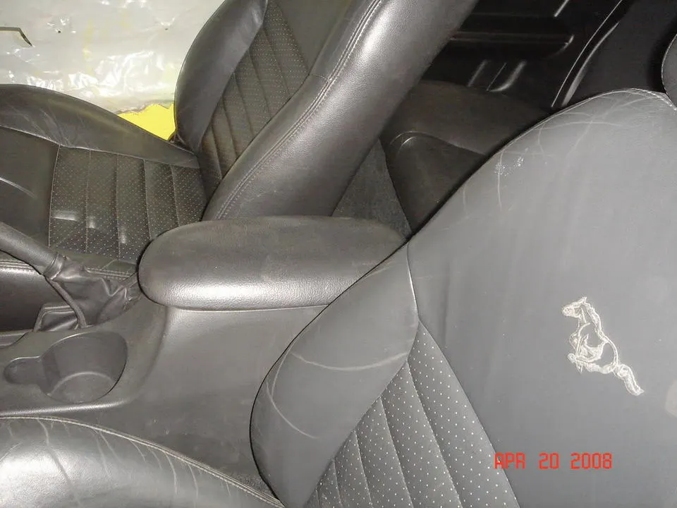

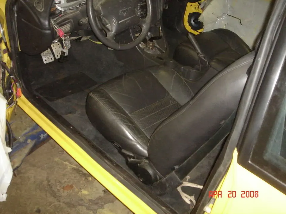

Interior shots....Yes, its dusty, don't worry, it will be cleaned. I get my new door panel hardware kit from resto wednesday, so the panels will be on soon. Also...the seats look bad in the pics now that I see them. They are not that bad in person. Those creases aren't that noticeable.

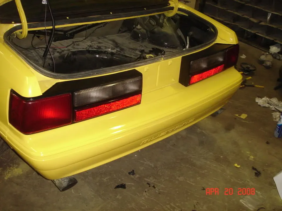

I polished the tail light lenses, and I repainted the trim in flat black between the lenses.
I also got the license plate lights working and the trunk popper. The car will not have the orange blinker as all Fox bodies. The outer red brake light is the turn signal....just like the 2001. It's different, but cool.

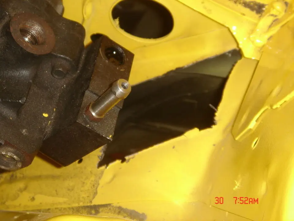

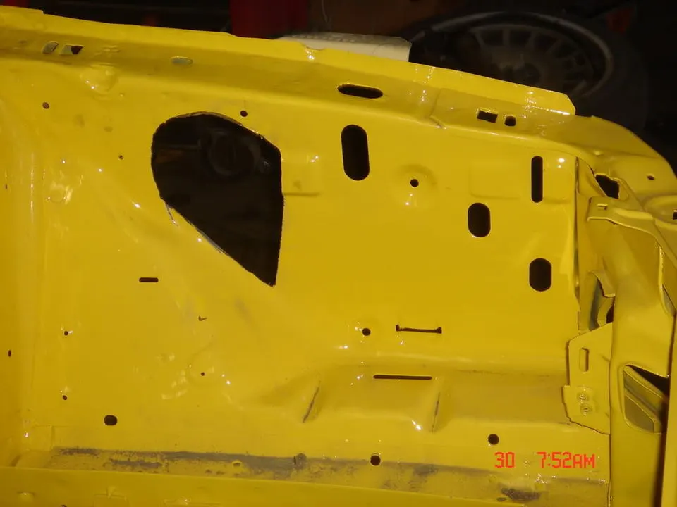

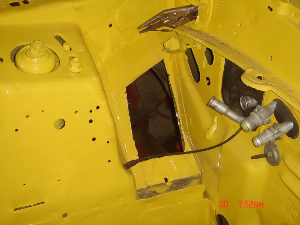

1. Start with a fox that was fuel injected. 86+. There were so many mini projects that took all day because my car was carbed. I didn't have any holes in the fedner aprons for air tube, washer bottle, fuel lines, and 1 other rather large hole for random wiring and cruise control cable.
2. Find a car that needs less body work, and or no body work. Say, I did this to my 91 notch that the body is good on. I could have the car swapped over much quicker, but I still would have to repaint the engine bay after the change over was fabbed up.
3. A MAJOR hang up was welding in a section of firewall from the 2001 into the 1981. This was because this section holds the bearing that the 94-04 steering shaft goes through. Without this, forget about using the new style column and dash.

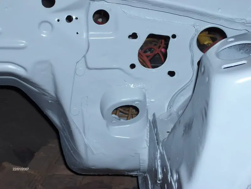

(THIS IS NOT MY PIC, it's one I saved from a site I found...but this is what I had to do.) ( You can also see where the holes had to be oblonged for the hyrdoboost to fit in the fox)

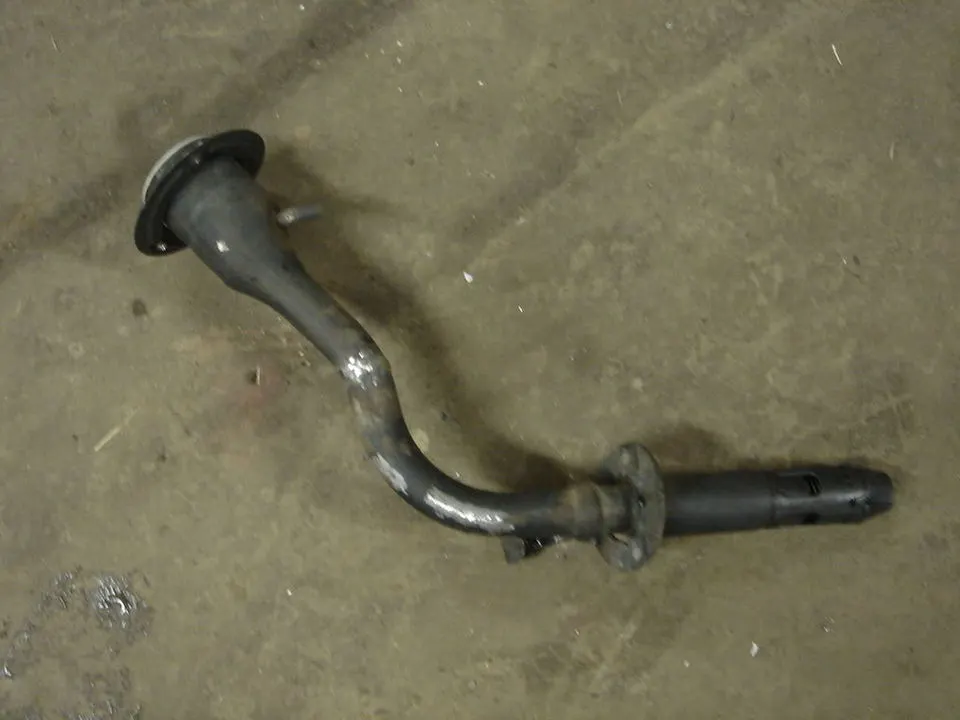

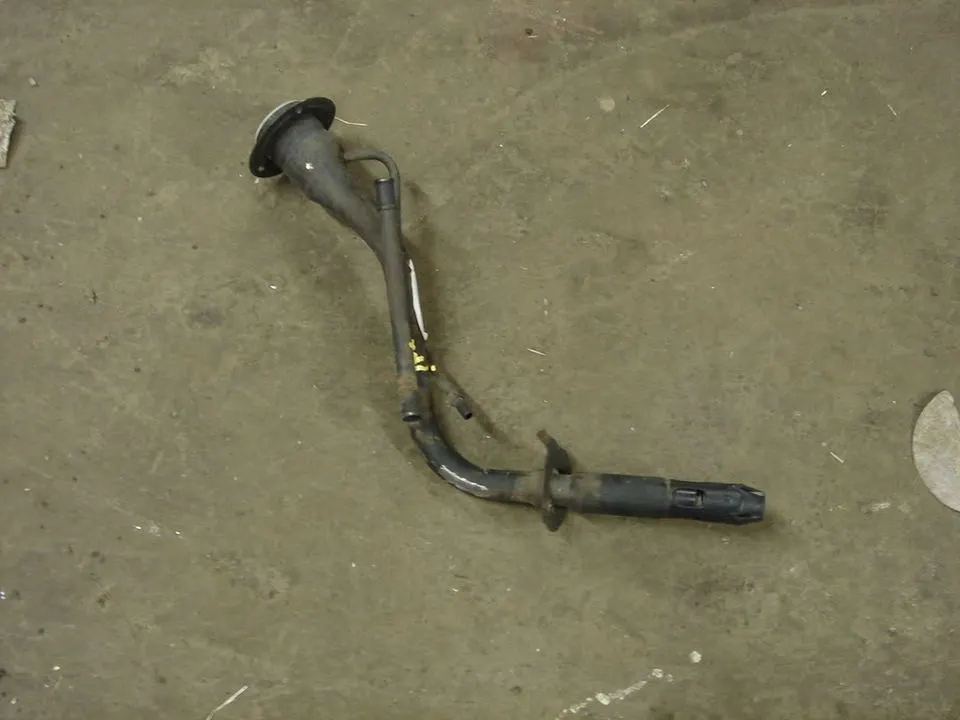

4. Another MAJOR hangup was the 2001 gas tank neck and gas tank. The neck is longer than the fox, so I had to cut that, shorten it, and then weld it back together. I did 2 practice necks I had laying around, wasn't happy with those, and the 3rd one I did, I used. I kept welding them at the wrong angle making the grommet in the tank stretched.
BEFORE: stock 2001
AFTER: 2001 made to fit 81 car.

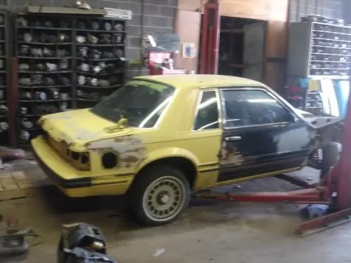

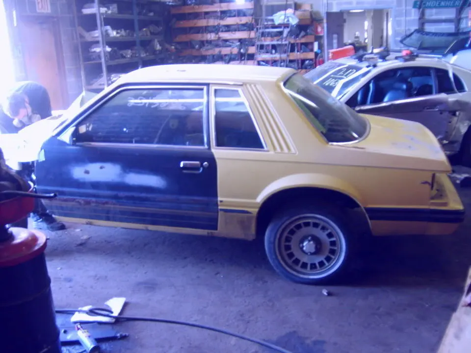

Remember this??
And now:
You can get the amber turn signals to work in the rear. Not sure how interested you are in doing some wiring at this point, but if you follow these instructions (meant for wiring in export taillights on an SN95), it'll tell you how to separate the turn signal from the taillight.
Thanks for the site. What I did was use the 94-95 tail light harnesses as they plug into the 2001 body harness, and twist into the 87-93 tail light openings. I didn't have to cut anything, but I did have to lengthen the reverse light sockets.
