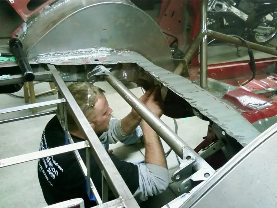

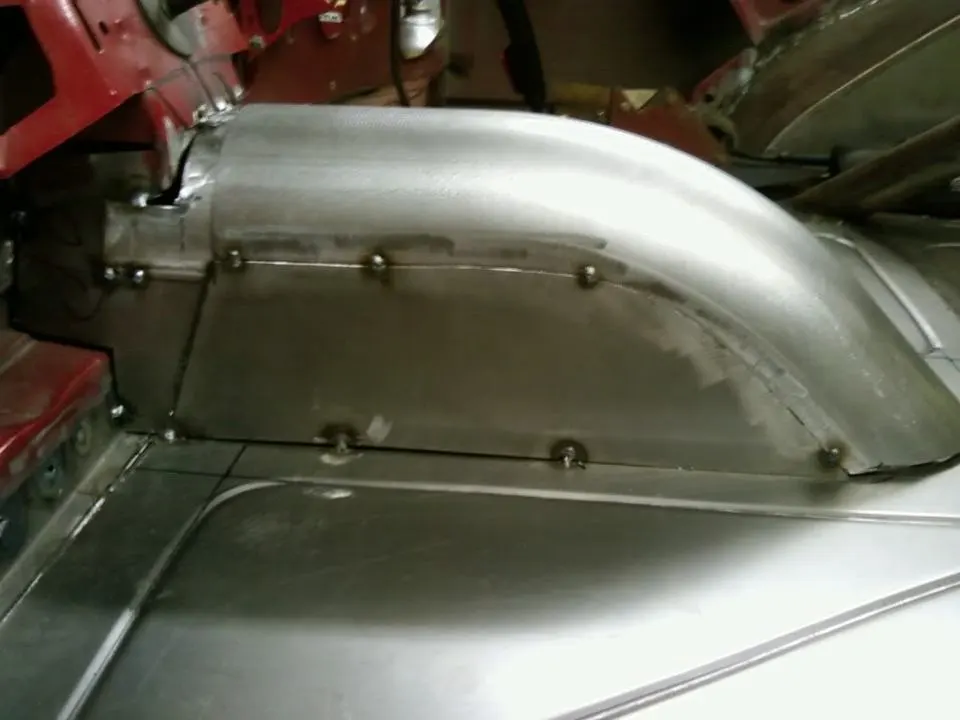

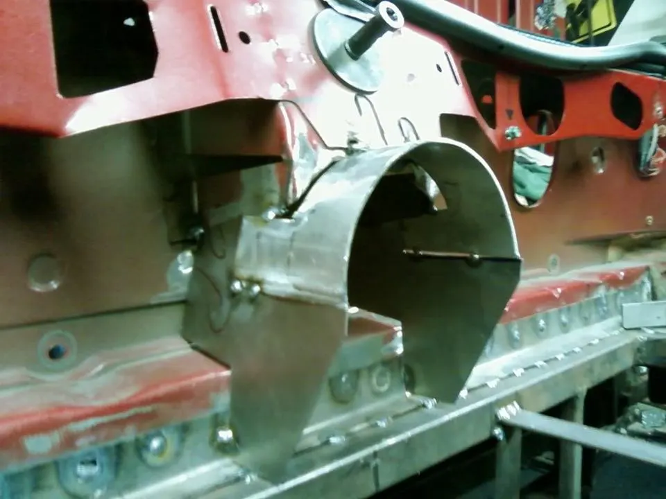

working on reinforcing the lower battle box.
almost all welded up, need to grind and smooth up all welds still

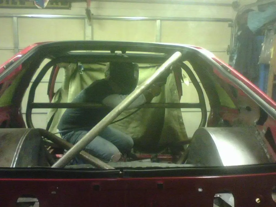

Thats the owner of the car
and here is me, welding away

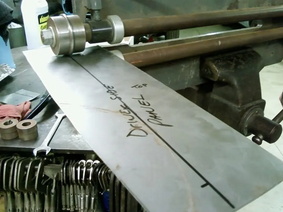

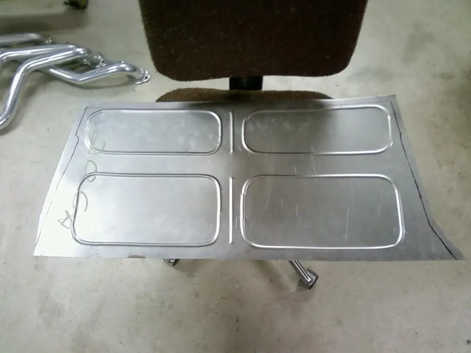

doing a little bead rolling
Before
After

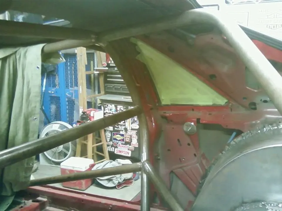

That car is going to be awesome. I love seeing pics. Good to learn off of. I can't wait to see the finished product! Keep up the good work. I'm especially impressed about the cage and how well its integrated into the whole structure of the car and how you hid it in the upper fender apron section.

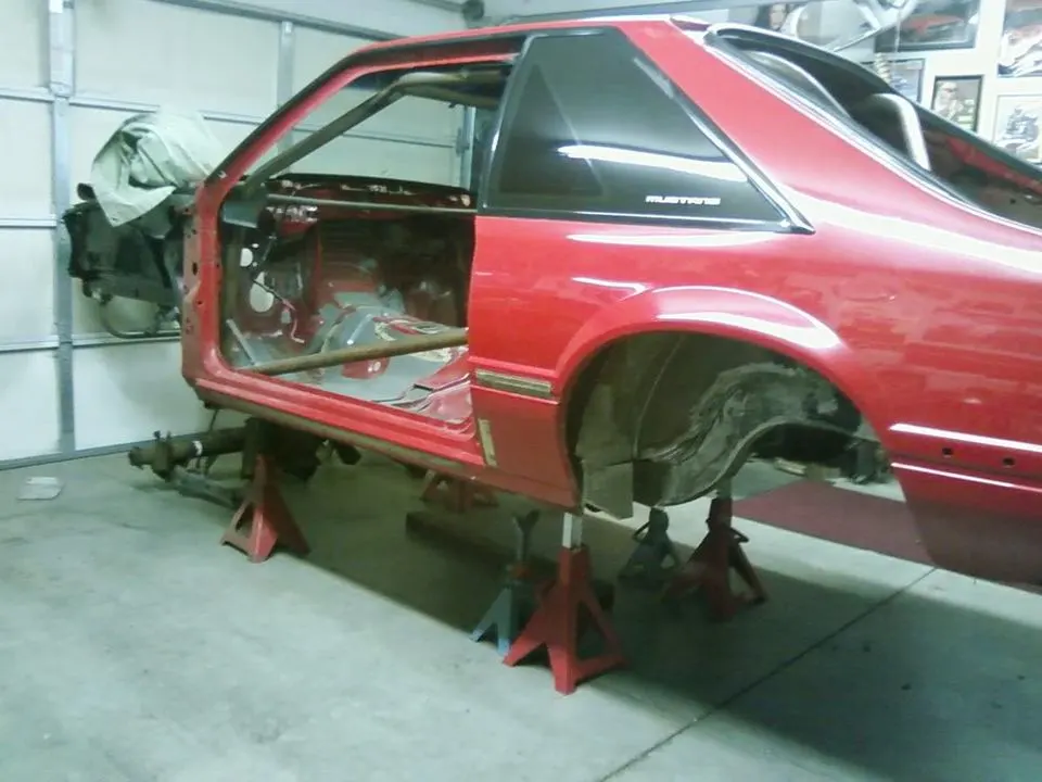

Here are some answers for ya.
The cage is all built by us. we have bent all the bars, did all the thinking about how to put the bars. i know its not the cookie cutter cage that most people out there have, i understand most people don't have the tools or know how to build something like that. like i said before, the cage is way overenginered, but that is for the visual impact.
The paint on the car, it will stay red. the paint on it now is actually in really good shape, so it won't get painted this time around.
The rear tire on the car right now is gonna be a 315/30/18, i think. and there is room to grow. i would think a 345 would be no problem to stuff under there.
This has been a project in the works for quite awhile now. we work on it when we can. as of today, we are just about done with the welding, i have one bar to finish putting one, and just some small places to finish welding. then comes the fun part of grinding and smoothing everything up. we still have a lot of work to do. we are actually gonna try to get it together with the old motor and trans to drive it this summer. then pull it back apart next fall/winter to do more work.

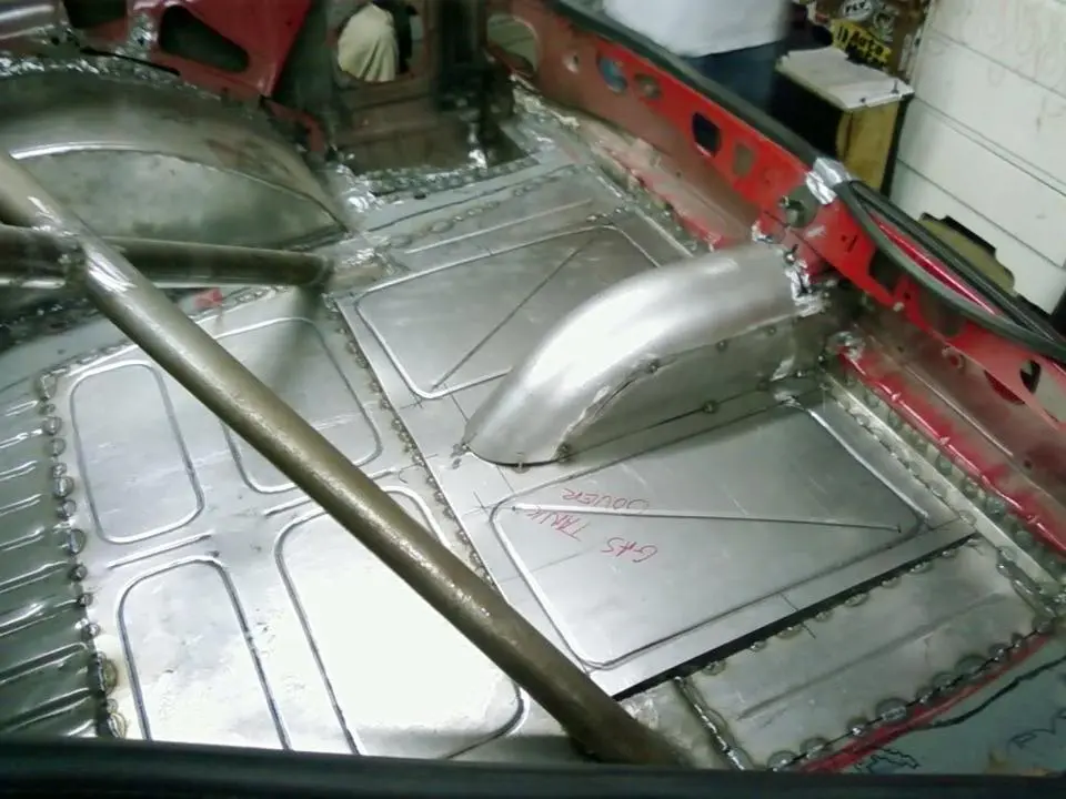

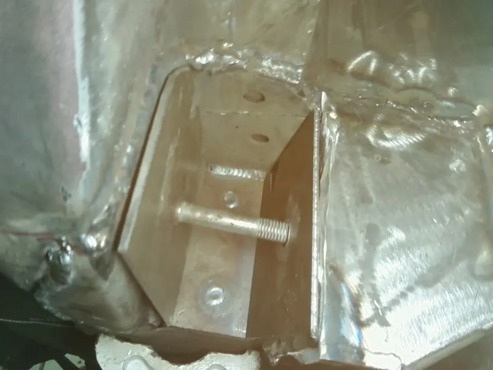

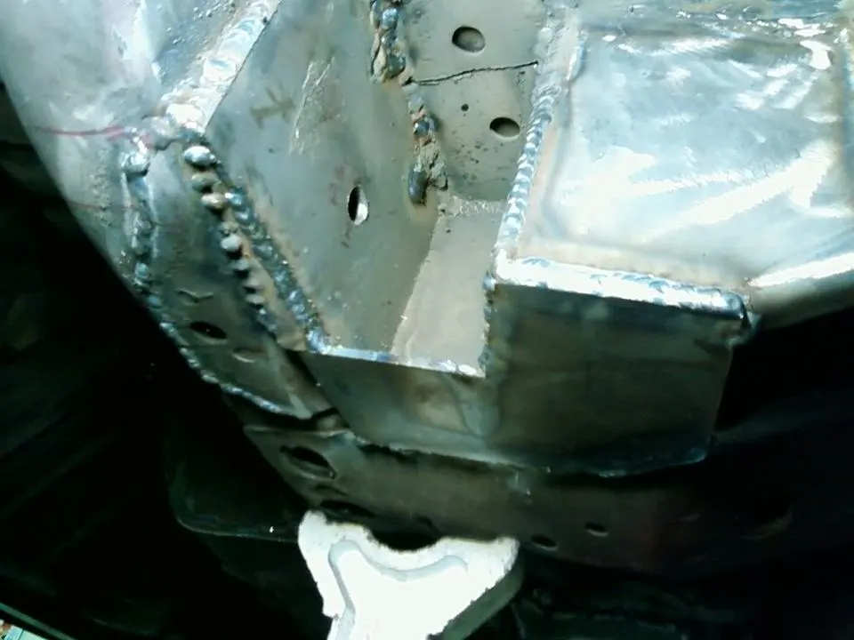

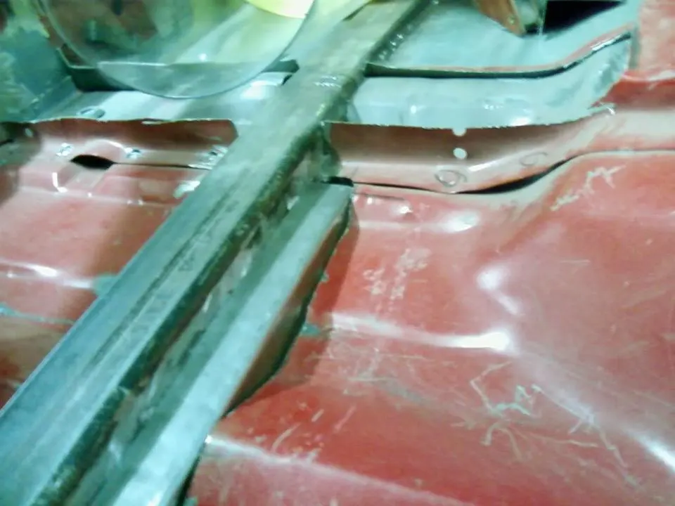

The front and rear subframes are tied together with a 2x4 frame rail and the cage is tied in with it. i can't seem to find any real good pics of it i will take a few next time i am over there. but here are a few i could find.
thanks for the questions:nice:
The small channel next to the frame rail is a little tunnel for the brake line and the fuel lines to run through. there is a channel on the inside of both frame rail.
