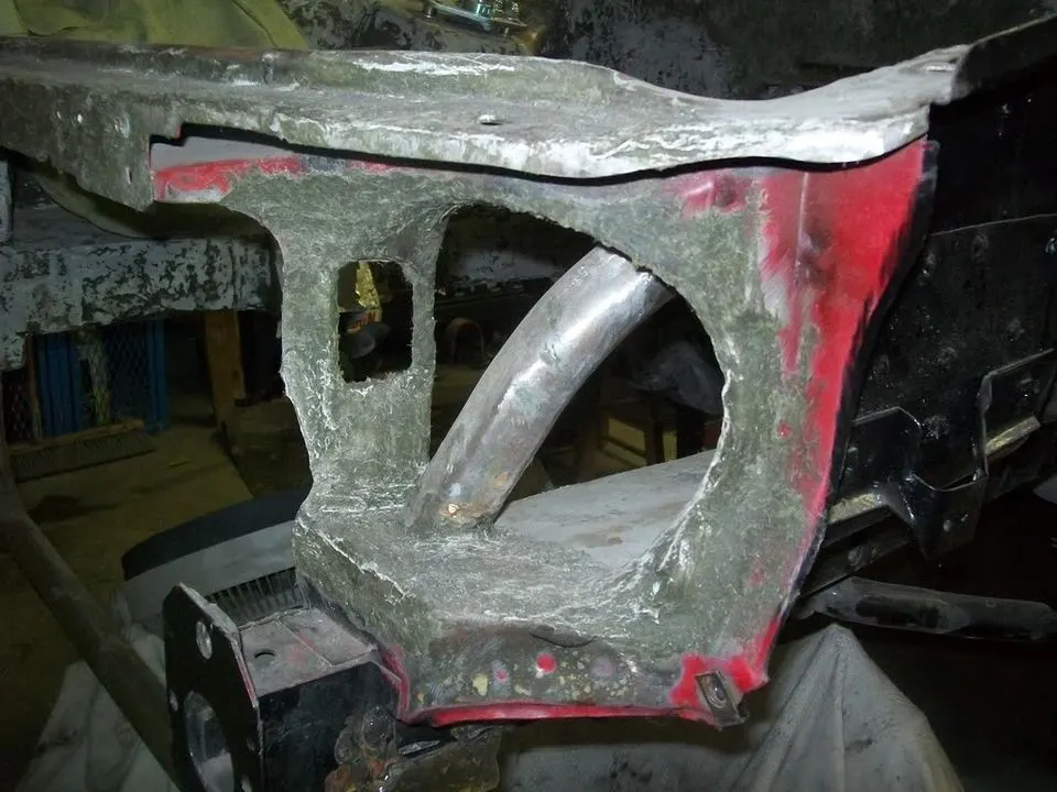

Here are some of the details people were wanting to know. motor- going to stay in the 5.0 family but will be building a 331c.i. dart block motor, with a F-1C procharger. shooting for around 900 horse. realiable horsepower as we want this car to be a driver. Transmission is still kinda up in the air. we want a 6speed but not sure yet. rear is a narrowed 8.8, posi, moser axles. Car will have coilovers on all 4 corners.

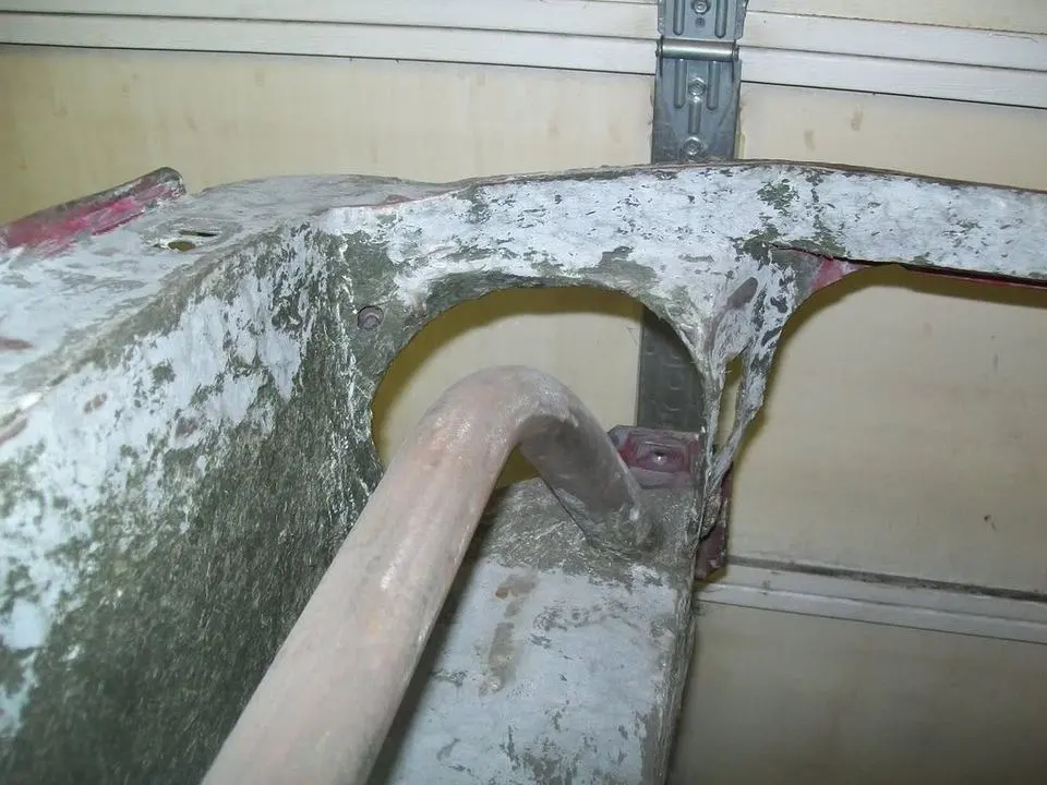

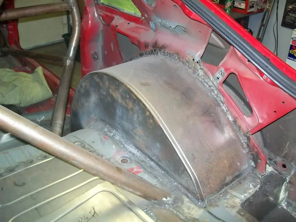

The car is definately built to be overkill, its for that visual impact for when the car will be shown. the stuff on the engine bay is indeed duraglass, kittyhair, we filled and smoothed all the holes, the pinchweld, and whatever else wasn't needed. Did as much metal work to get everything flat and smooth, then we did a skim coat of the duraglass over the whole thing to even it all up.

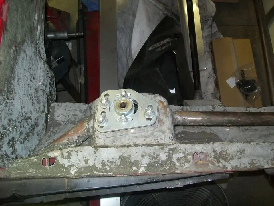

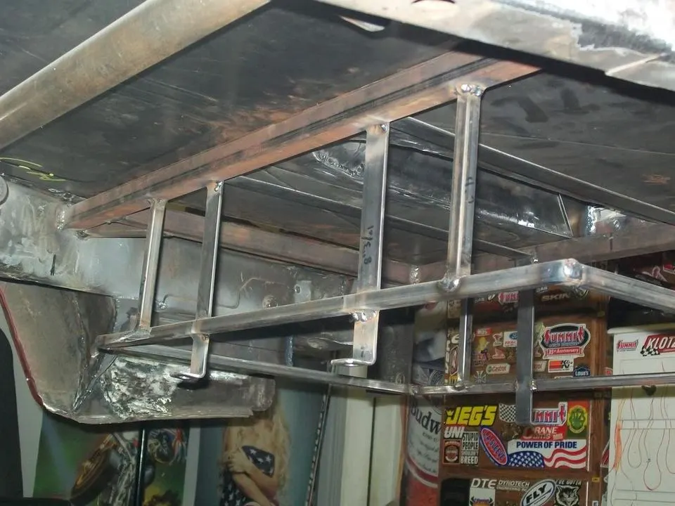

When we started, we did the frame rails first. we made sure the car was well supported with jack stands. don't have a jig, well not yet. once the frame rails were in, the car was actually pretty stong. none of the unibody was cut out, which kept the car stong. then the car was supported on the frame rails and the cage was built on top of that.

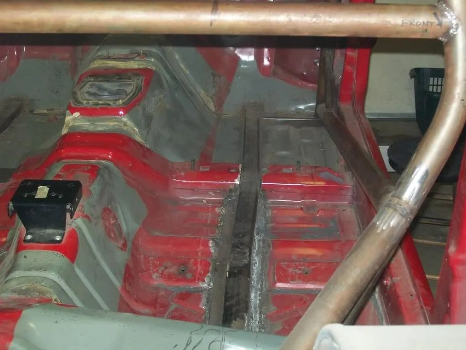

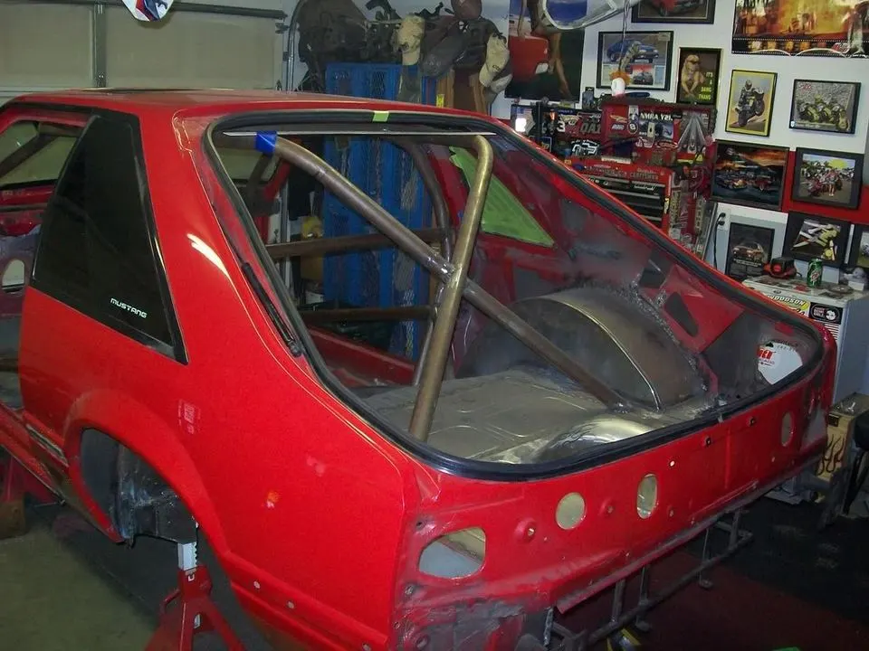

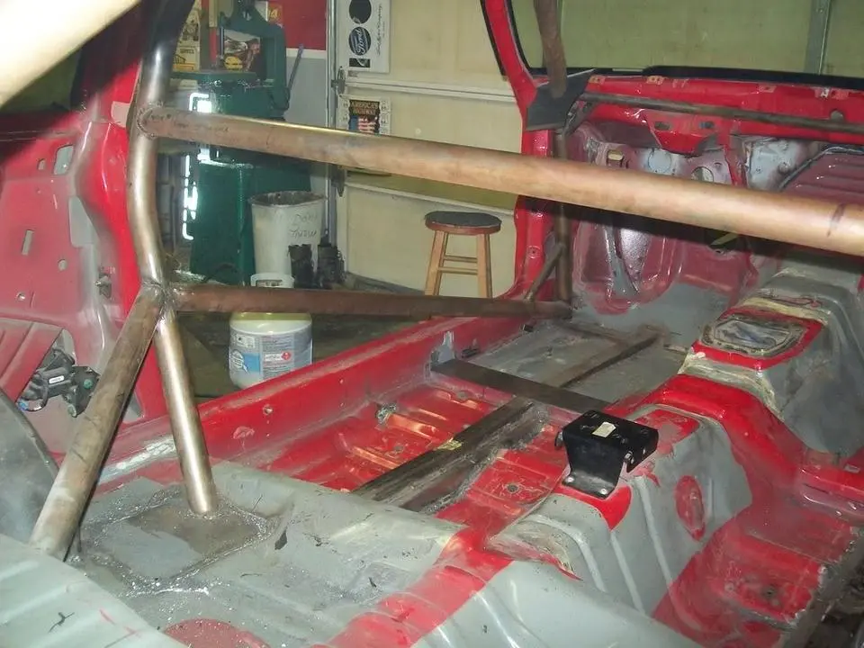

Well guys, the roll cage is offically all in. got two small braces to put in, but the whole main structure is done. Thats a good step in our build. Next on the project plate is to get everything all ground down, smoothed up and get some primer on all the bare metal. Once we get it all primed, we are going to seam seal the tubs, the frame rails, and rear floor area. We are going to use the product know as lizard skin after we get it all primed and sealed. Going to use their sound control product on the entire interior and their ceramic insulation on the underside of the car. Well just wanted to give you guys a update on where we are at. and here are a few pics to look at.

Looks like 1 heck of a project, and you are doing a great job. 1 thing keeps messing with me though. It looks as though the side bars on the cage wont pass NHRA inspection unless there is a secondary removable bar going in. I was working with the guys at C&D Race Cars to figure out what I could live with and what I needed. Unless Im wrong I thought the intersect between high and low mounts had to run through the area that would be between the drivers sholder and elbow as a rule of thumb. Does the owner plan to run the car at the track. Im not knocking anything, I would love to have the skills that you do, but that side bar just looks wrong.
great job.
He didn't want the door bar being up that high. He knows the chassis won't be certifiable. This is being built to be more of a show car/driver than just a all out race car. His next project will be the all out race car, bet you guys can't wait to see that. I know i can't wait to build that one. I think you could still take this car to a track and run it, i don't think it will be a 8 sec car, so i don't think they will get too mad. but yes it will not get certified. just a show car
