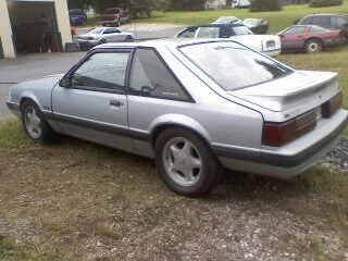

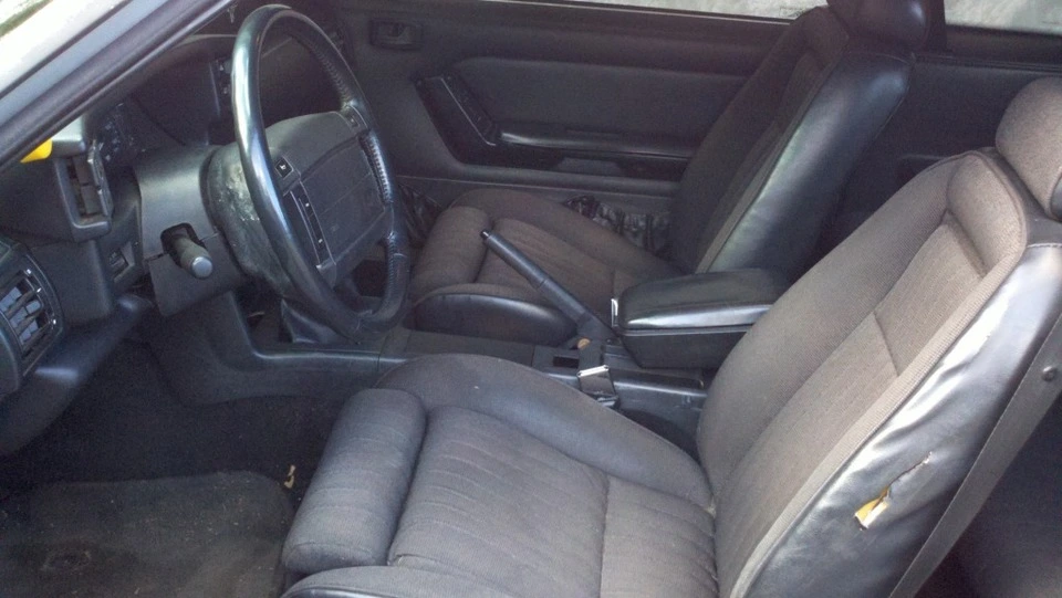

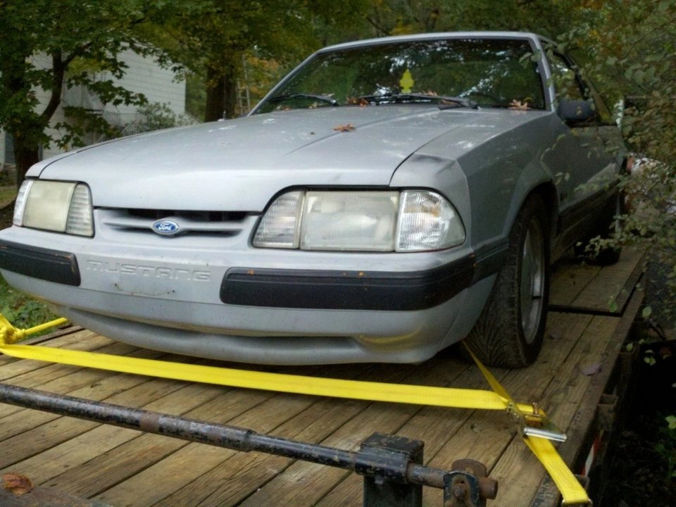

So i found my 91 lx up in sykesville maryland for $3800. Not a bad deal for a car with 5000 miles on a rebuilt motor and a car with very little rust. so some before pictures of when i first picked it up.

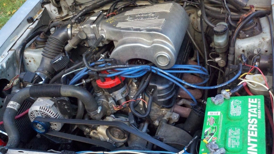

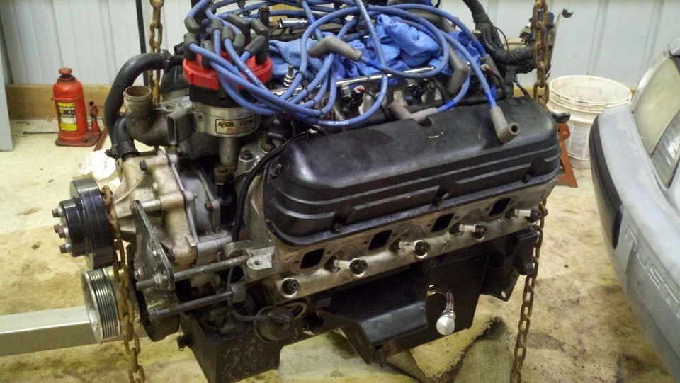

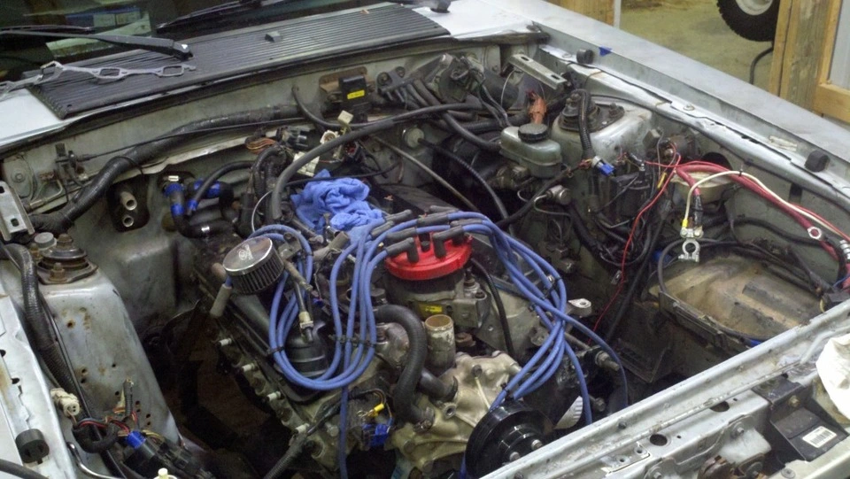

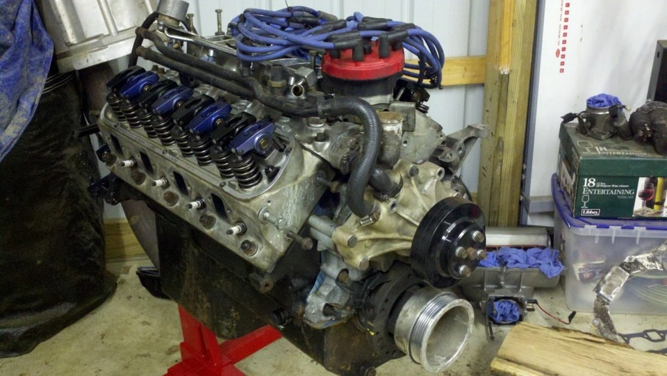

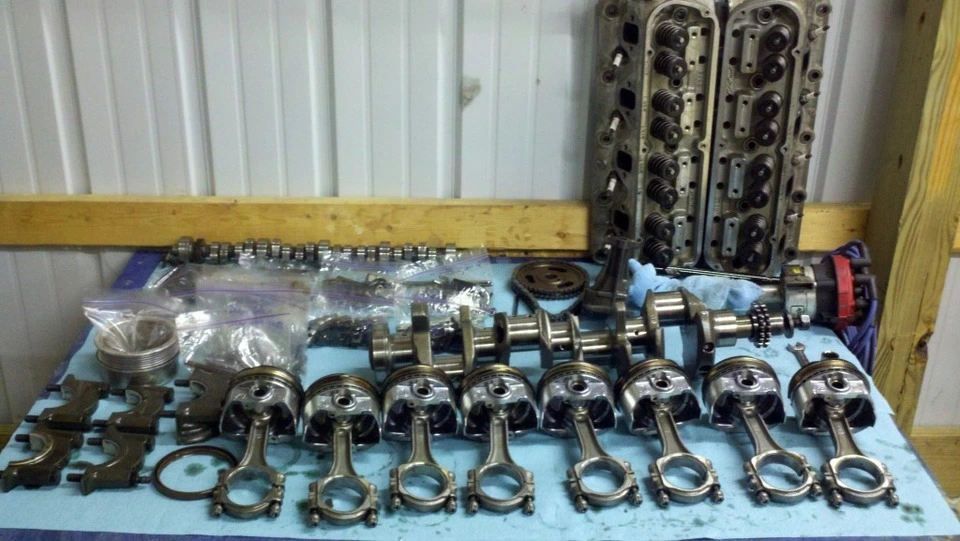

Motor specs are a 306 motor with stock crank
Eagle h beam rods
Keith Black pistons 10.6 compression
Edelbrock heads with 1.6 roller rockers and dual valve springs
Holley Systemax upper and lower intake
Mac headers, off road h pipe and tailpipes ( all will be gone because i do not like mac products)

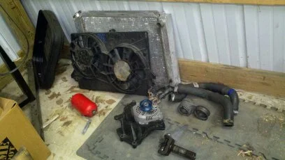

Electric Fan and mishimoto radiator

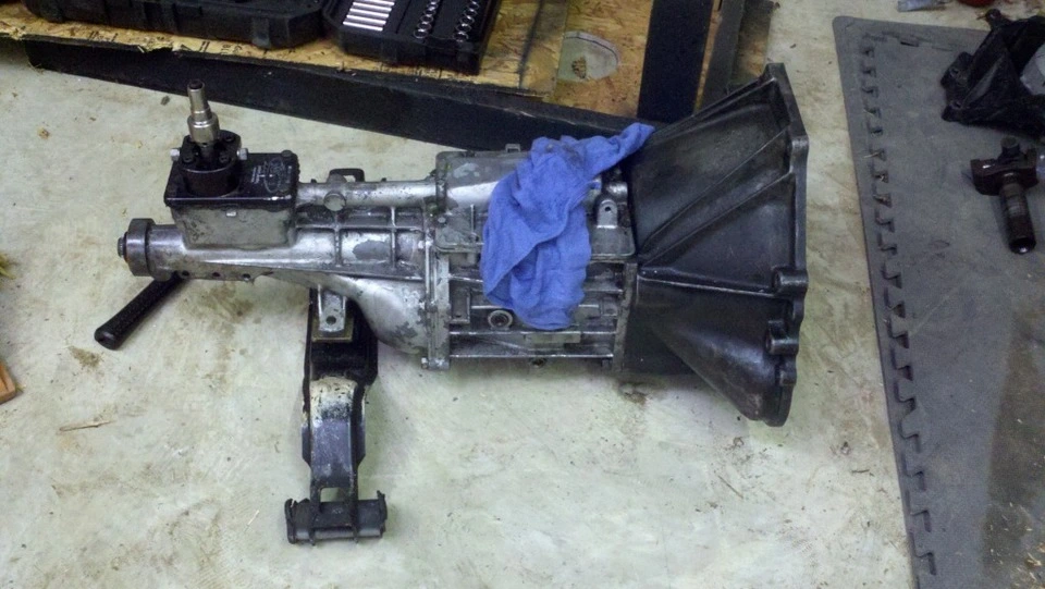

MGW short throw shifter
Stock T5 trans
Aluminum driveshaft
4.10 Gears

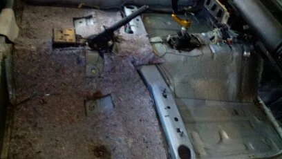

So first was motor and interior removal

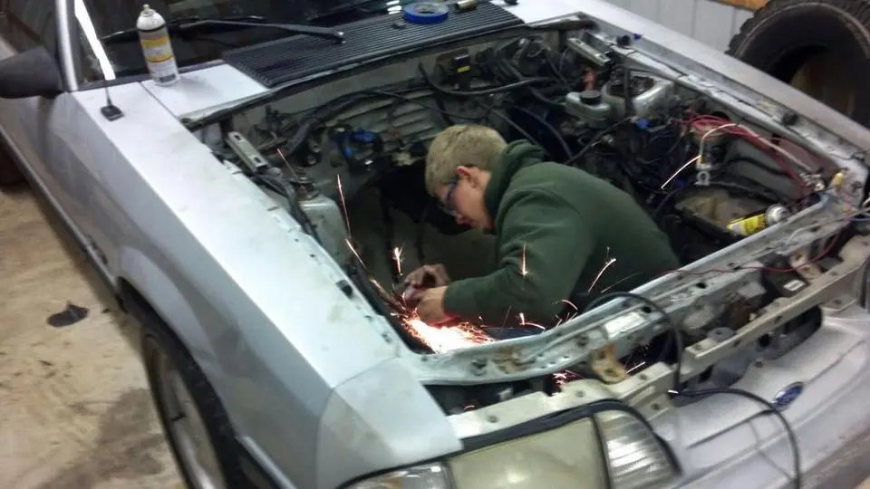

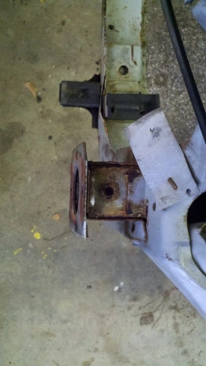

A motor mount gave me some trouble so a pic of me grinding it off

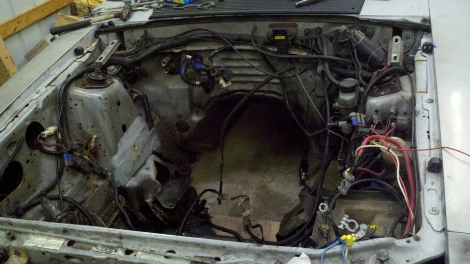

NO MORE MOTOR

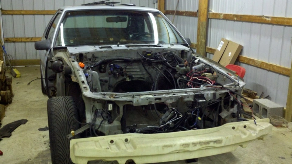

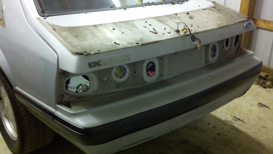

More removal of parts bumpers 1/4 windows, etc..

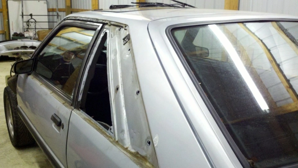

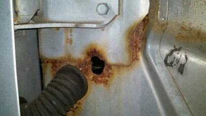

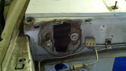

Upon removal of parts i found a few rust issues that im gonna have removed
NO MORE WIRES!! also a pic of before rust and some body work

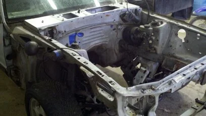

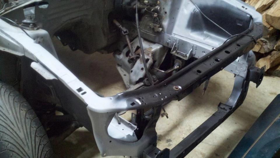

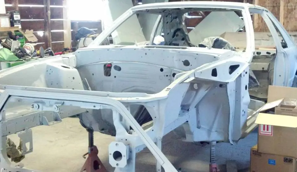

After rust work, new radiator support, and new smooth fender aprons

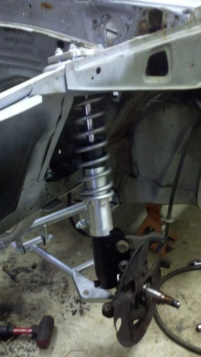

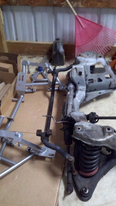

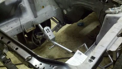

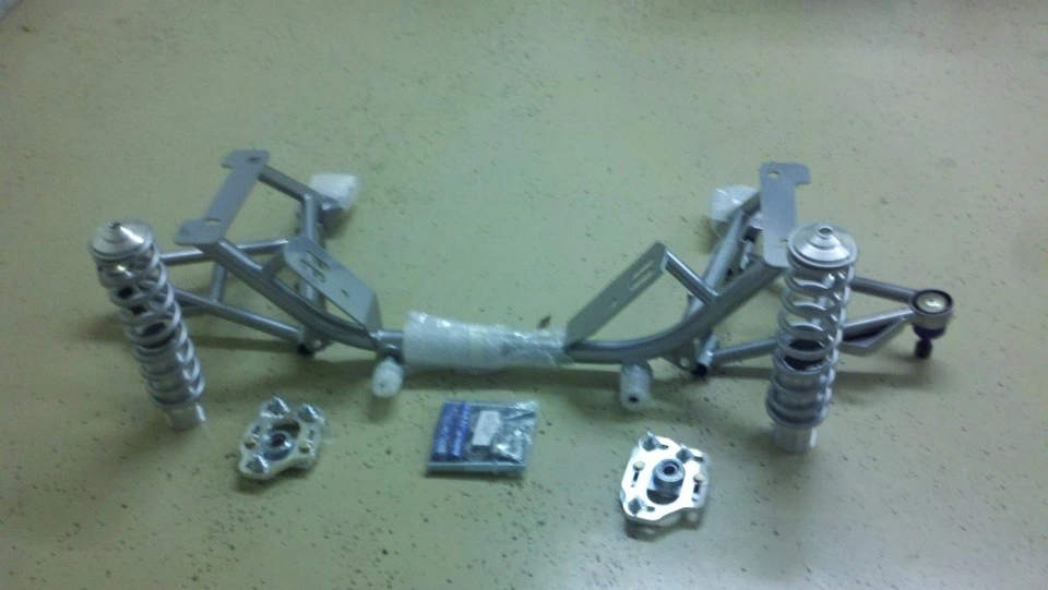

Got my upr k member and also the coilover kit with strange front struts
This thing is tiny compared to stock

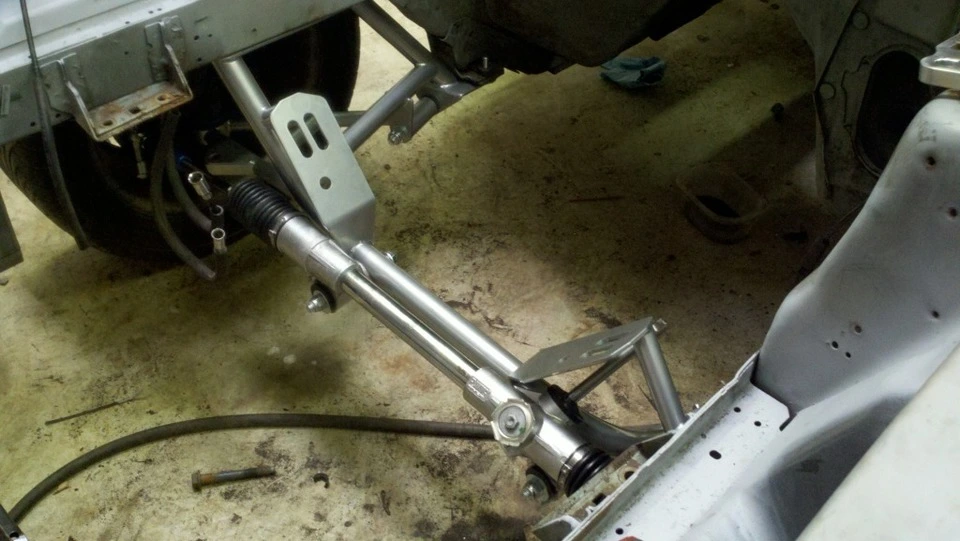

K member installed and manual rack ordered
view of struts and coilover kit
Picture with rack installed

Off to paint we go

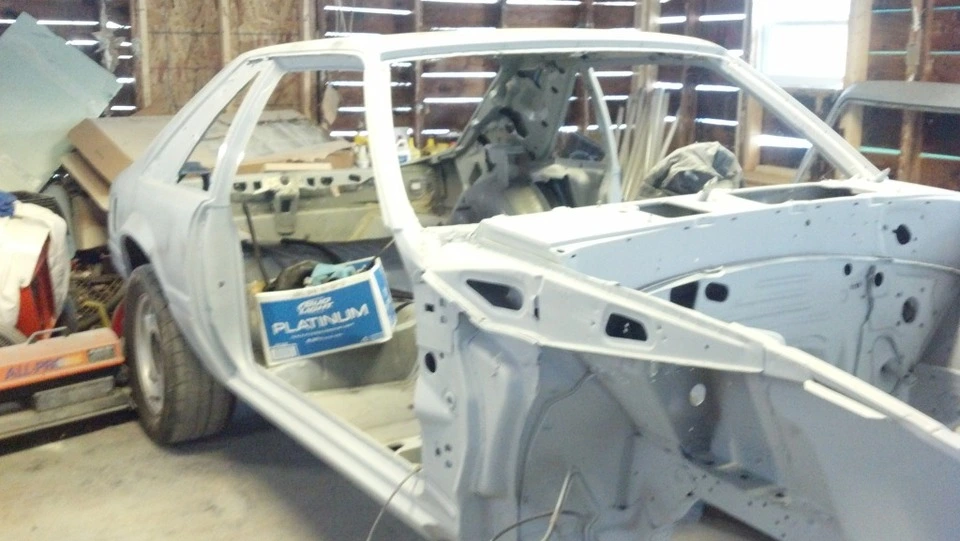

Primer on car hope to have it back in a few weeks
notice anything? no more hood hinges or mounting for hood hinges!!

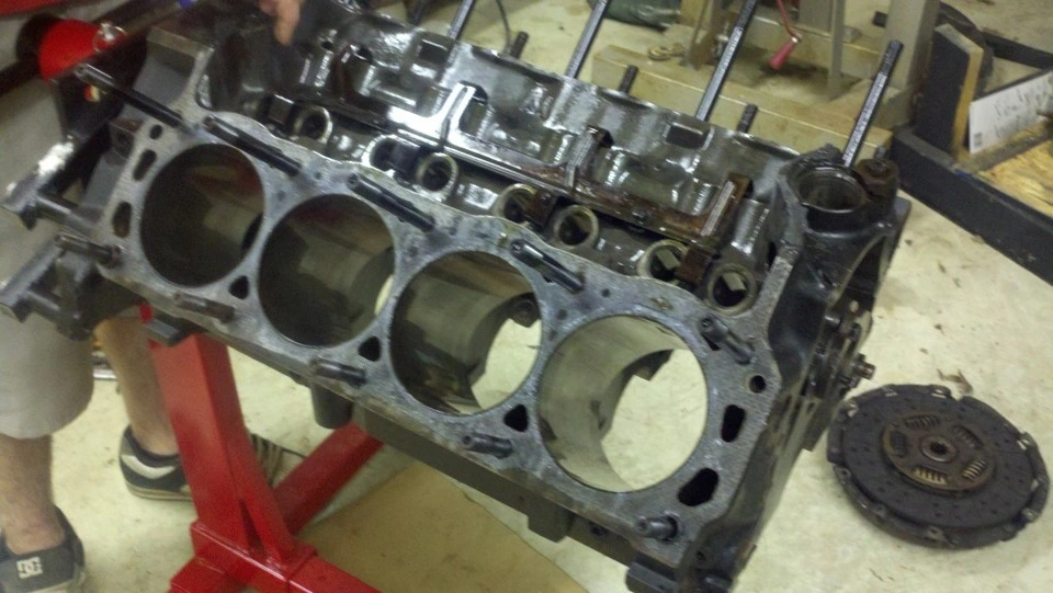

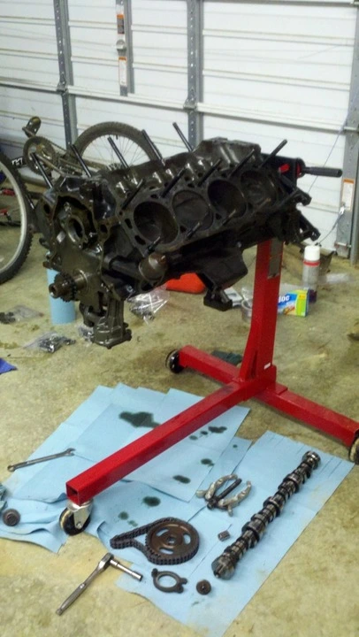

Now to disassembly to have mckeown motorsports to fit my 306 with a 347 stroker kit

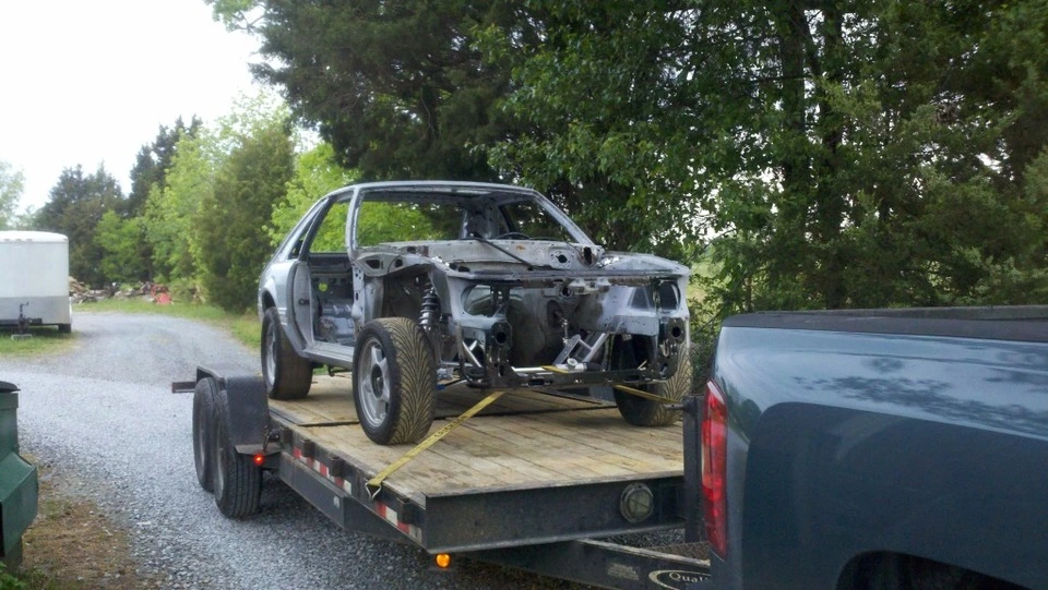

Final product before shipping out to mme racing
Now just waiting on getting the car back as well as the motor to start reassembly of my car, sad to say im missing my car and i didnt get to drive it much i dont even have tags yet. but check back soon and i will try to keep this thing updated.

Why are you deleting your hood hinges? It looks too late now to change anything,...but a lift off hood is gonna be the easiest way to absolutely, flat out F U C K up $350.00 a gallon copper House of Kolor paint.
You look like you've been busting your ass so far,....Good Job!
Yeah well it might all go idk what imgonna do i do know the stroker is gonna be a scat crank with scat forged rods and ross pistons and my compression ratio goal is 9:1
I deleted for lift off hood and it will be held by dzus fasteners and sit ontop of rubber mounts
Taking the hood off and on will most assuredly make a mess of the mating surfaces of the fenders, and the hood edge. Then theres the "where am I gonna put the hood now"? after you remove it, where most people just put foam under the hood to allow it to sit on the roof w/o hurting it. (don't work)
