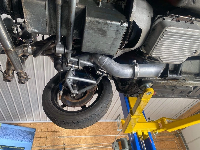

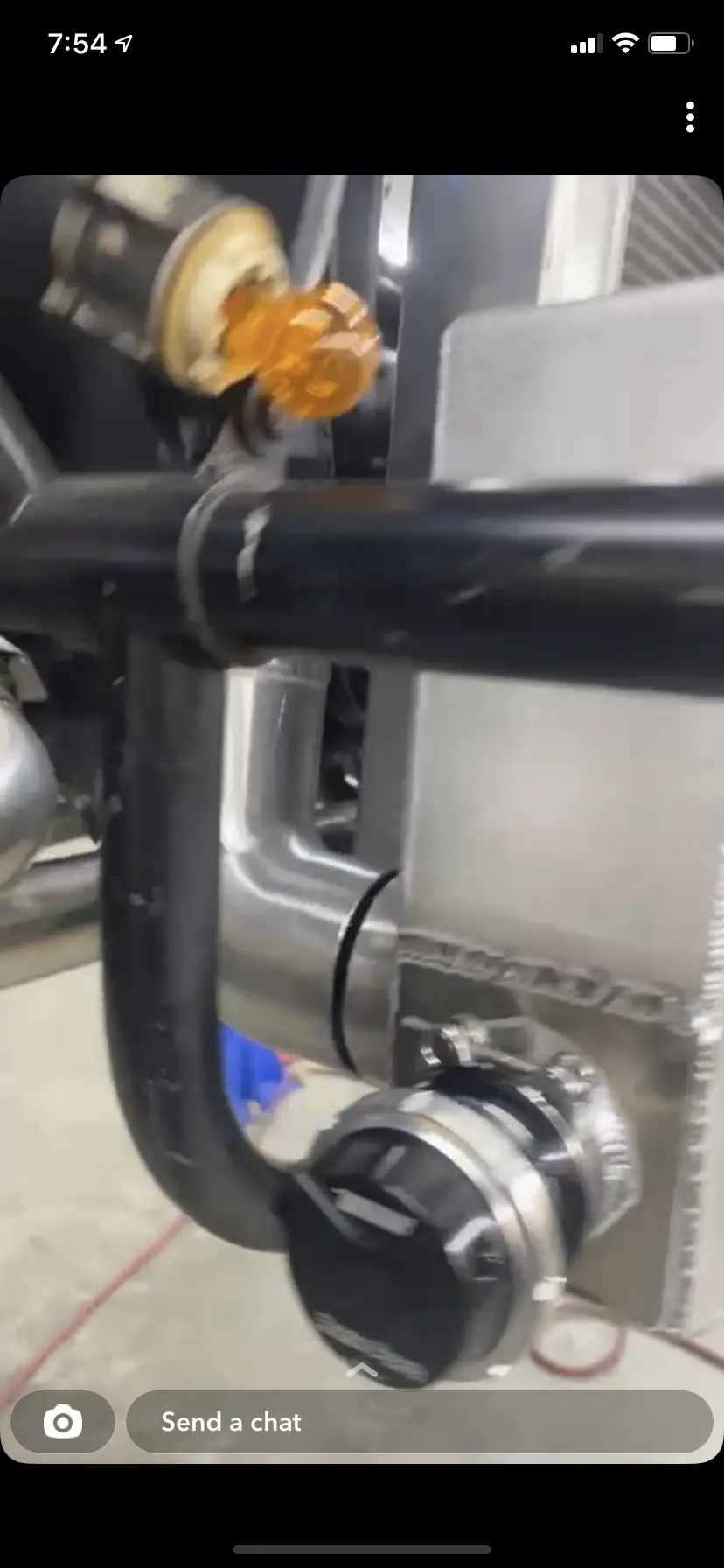

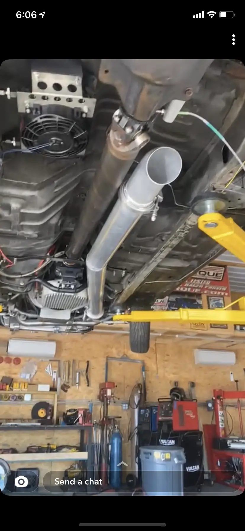

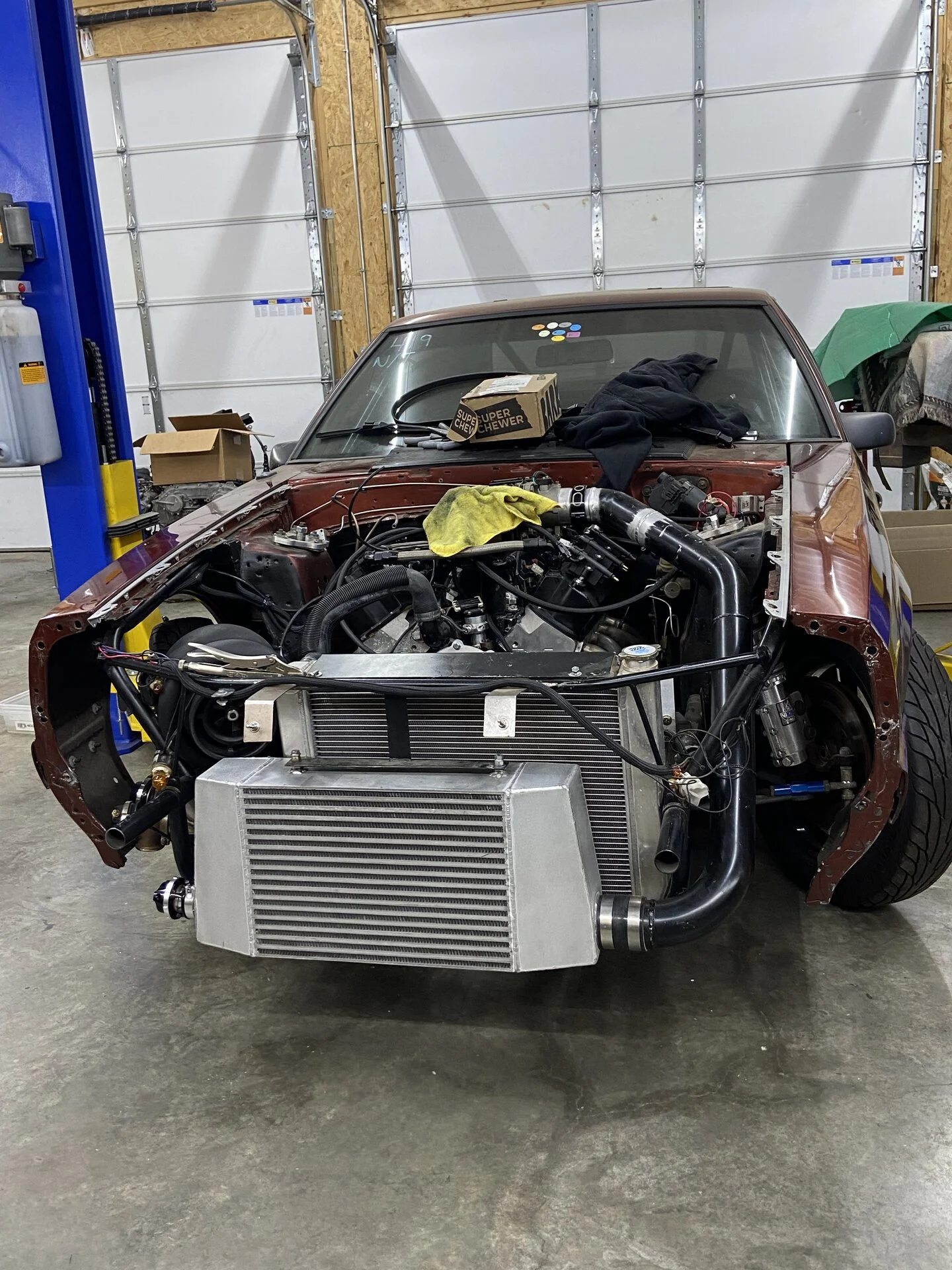

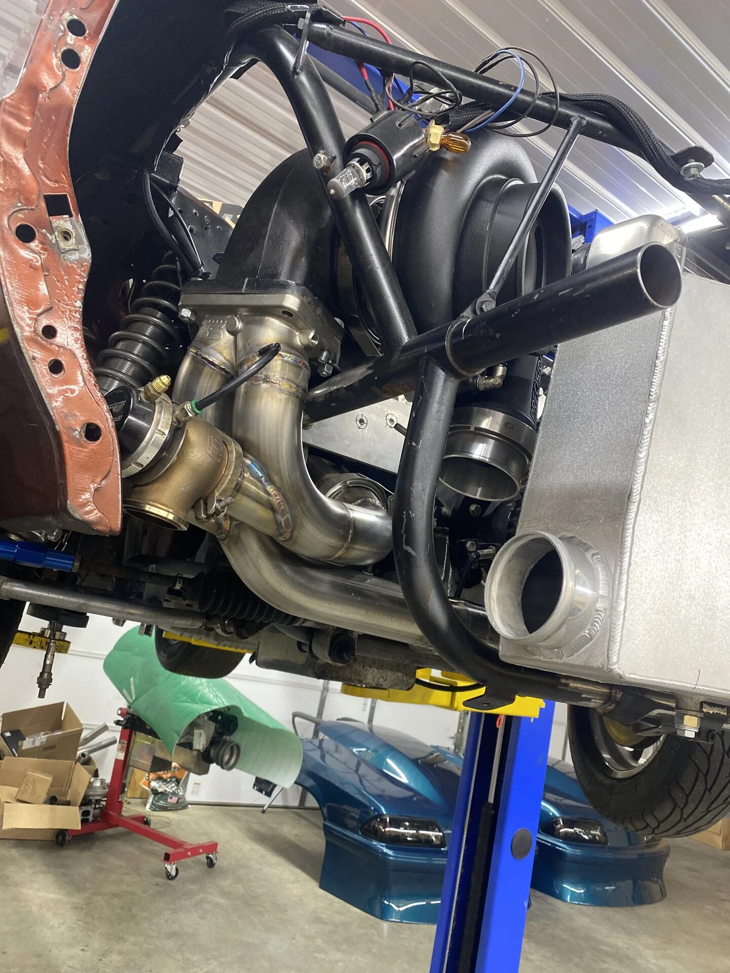

Continued working on the turbo and all. The turbo placement wasn’t allowing us to utilize the side entry for the intercooler so we blanked that off and put the BOV there instead. Came in thru the back of the intercooler with 3.5” pipe as well. Made the downpipe up and put a vband in there by the starter location because some classes I run want exhaust to b pillar while others typically don’t care so I have two lengths of pipe now for it.
