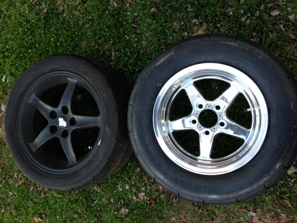

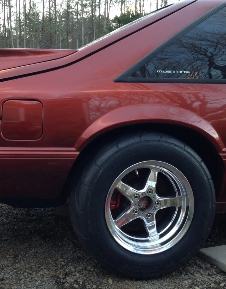

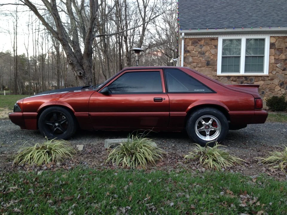

Man I have a rough time keeping up with this thread, but here is a pic, I said I was going to 15's and mickeys. I also have a set of 17x 4.5" race stars coming in too so excuse the original wheels in front. Also found my problem with the car not starting, helps when you have some good gas, turns out I let the gas in there too long and it either had water get in it or started to turn to varnish either way I had separation.
Another thing I found out is that my fuel pump was only a 190lph and not the 255lph I thought was in it. I don't know why I never changed it out, also to add to these changes I put on a set of Viking 14" 150lb springs and got rid of the other 12" 250 I had in the front originally. So enjoy my progress and stay tuned as I will try to keep up with it more.
