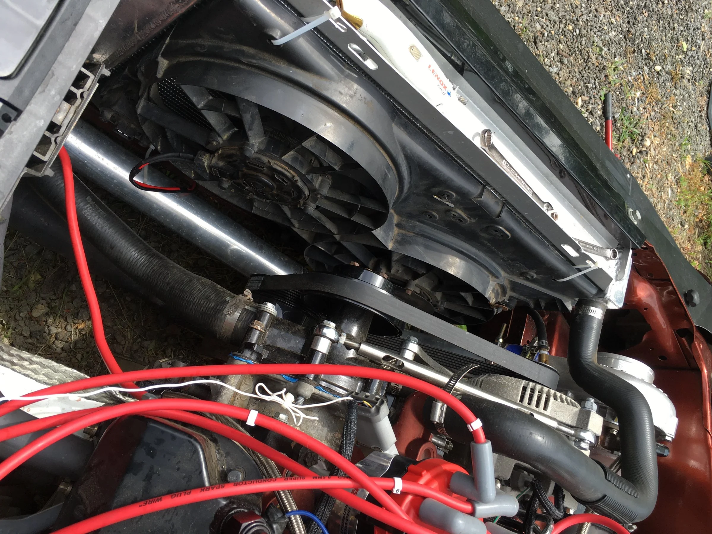

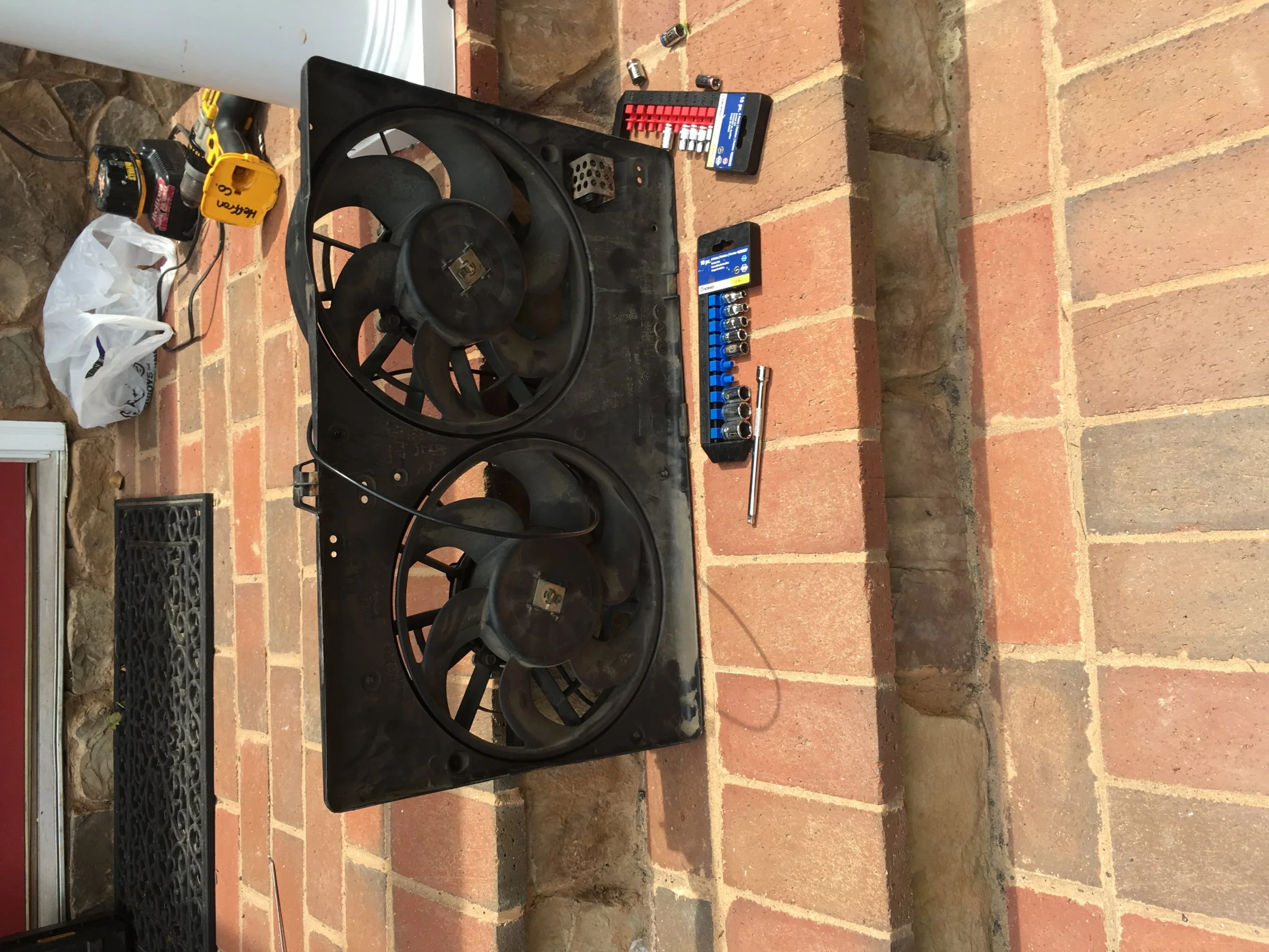

So for those who have not followed my over heating thread my car was overheating pretty good come to find out that my fans were too small only 1800 cfm. Found a contour dual fan setup at the junkyard and installed it
Test drove it and this was after 45 minutes of driving I'm relieved to say the least.

Yeah man wish I could fit a Taurus fan though they flow an estimated 1000 more

What kind of size difference is there? Looking at your pics the contour fans appear to be the same size.

The contour fan is 3.5" thick
The Taurus fan is 5" thick
The mark 8 fan is 6" thick
