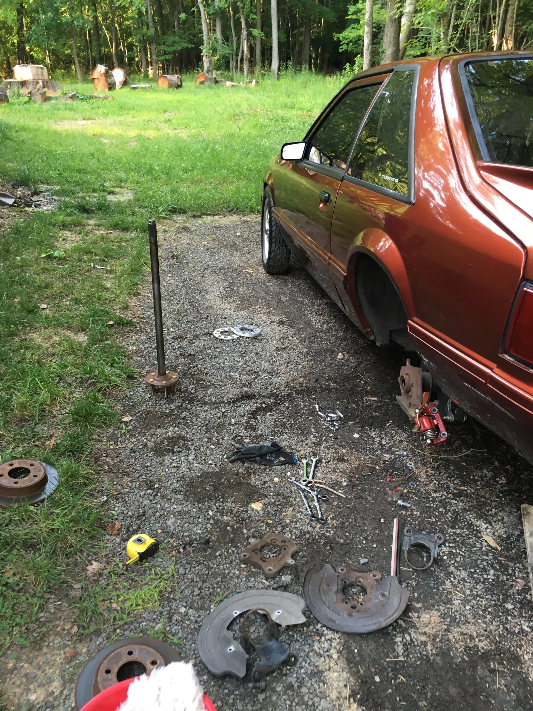

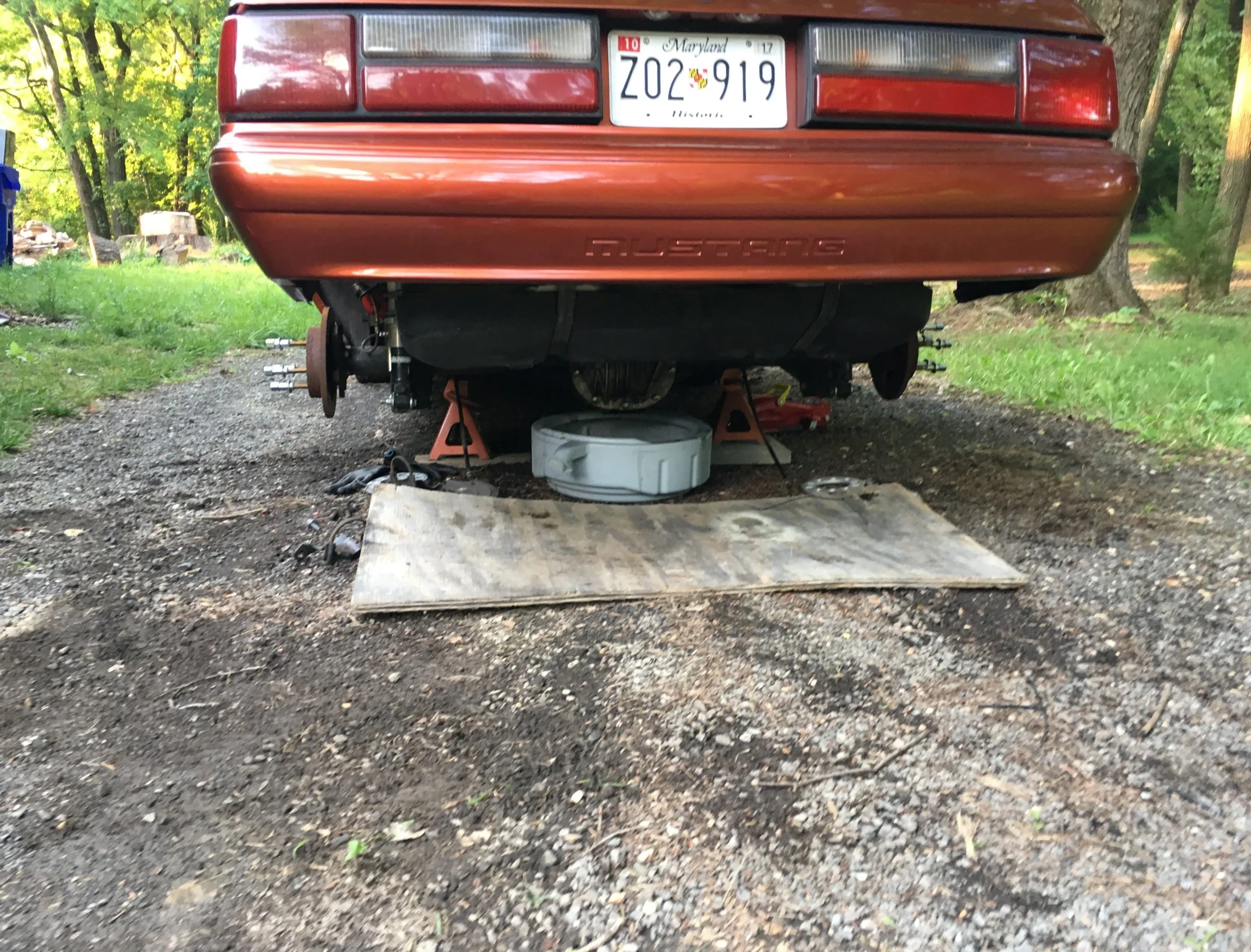

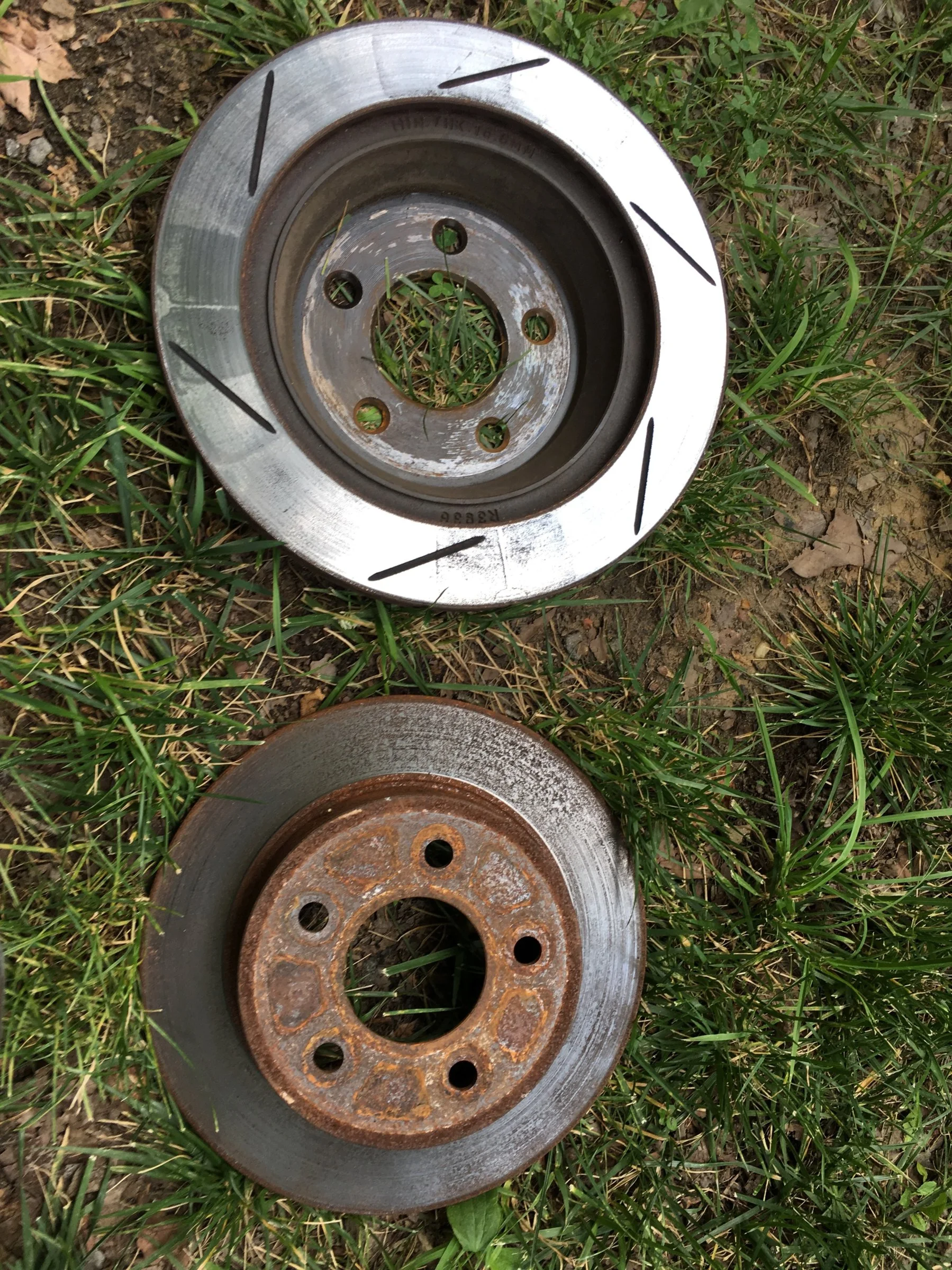

So working on the car some researched and with @Mustang5L5 help found some rotors and gonna get some north race cars brackets and I will hopefully be able to take the spacers out of the rear wheels

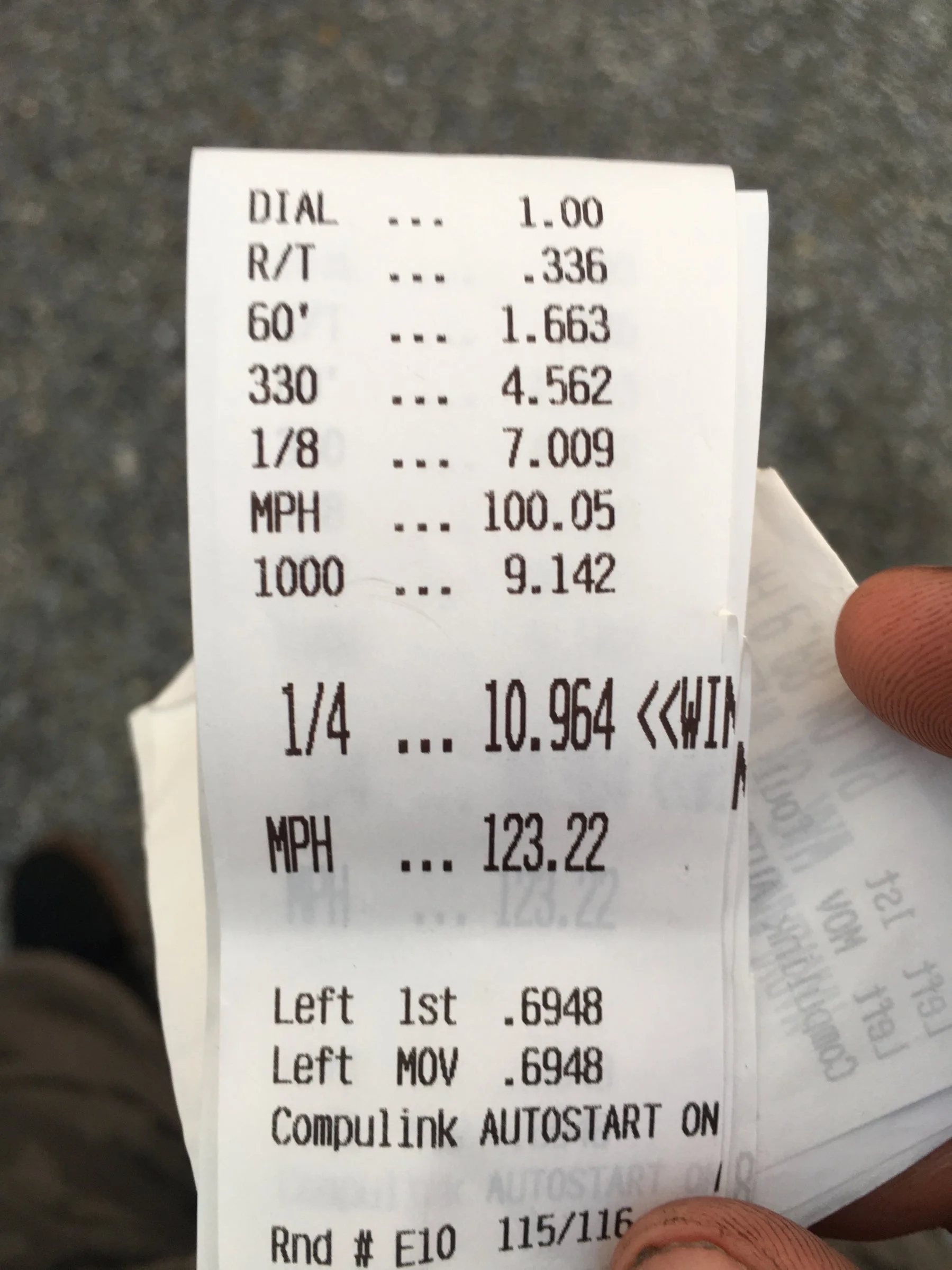

That pass went 10.84 at 116 I let out of it and started braking at 1000'. Pass before that I ran it out and went 10.94 at 126 here's the slip on that one

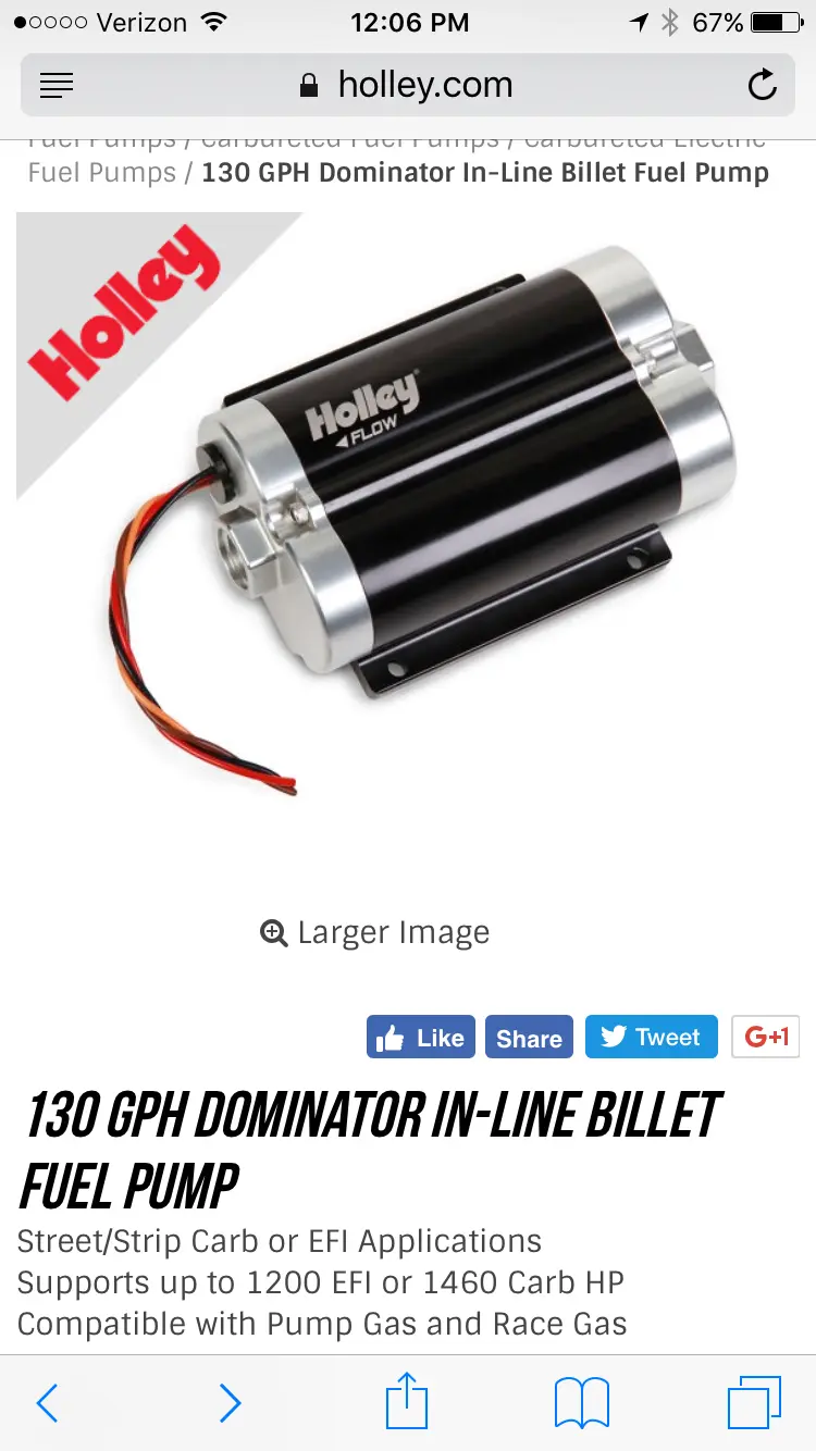

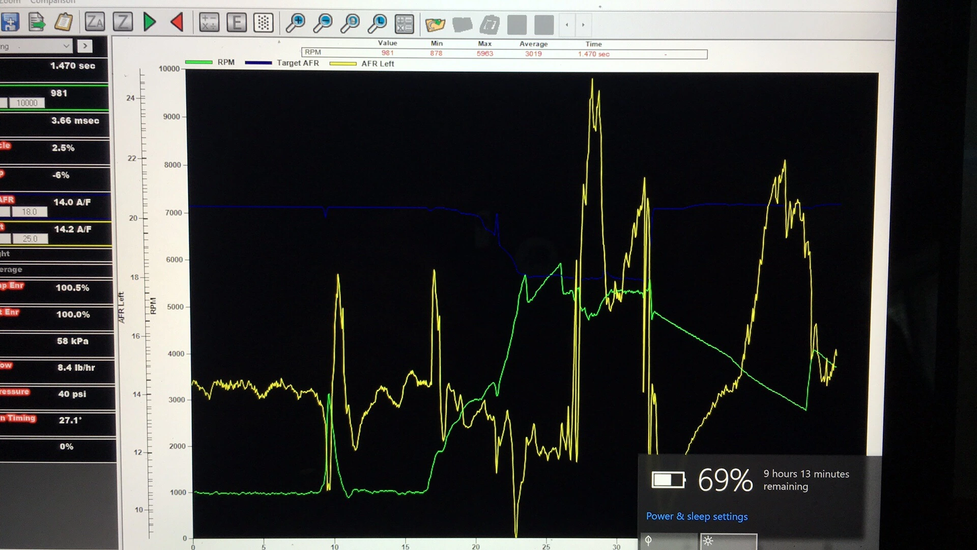

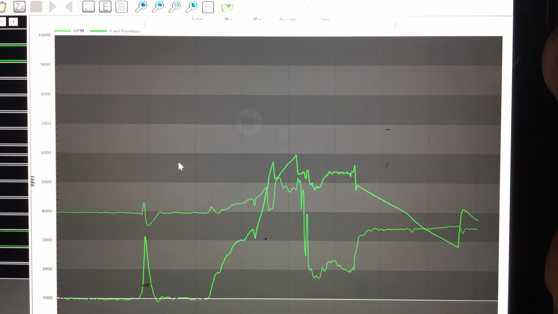

Trailered the car down to Mir Saturday on the hottest day of the year for some grudge racing and found the breaking point in the car. Only have a 255lph fuel pump feeding a 10psi 347 stroker turbo motor. Safe to say my a/f readings were a bit lean you could say
You can see as my rpms go up my fuel pressure drops down. Looks like a new fuel system for me!! Lol
Going with a Holley dual pump system that Kris recommended to use and new lines and rails.

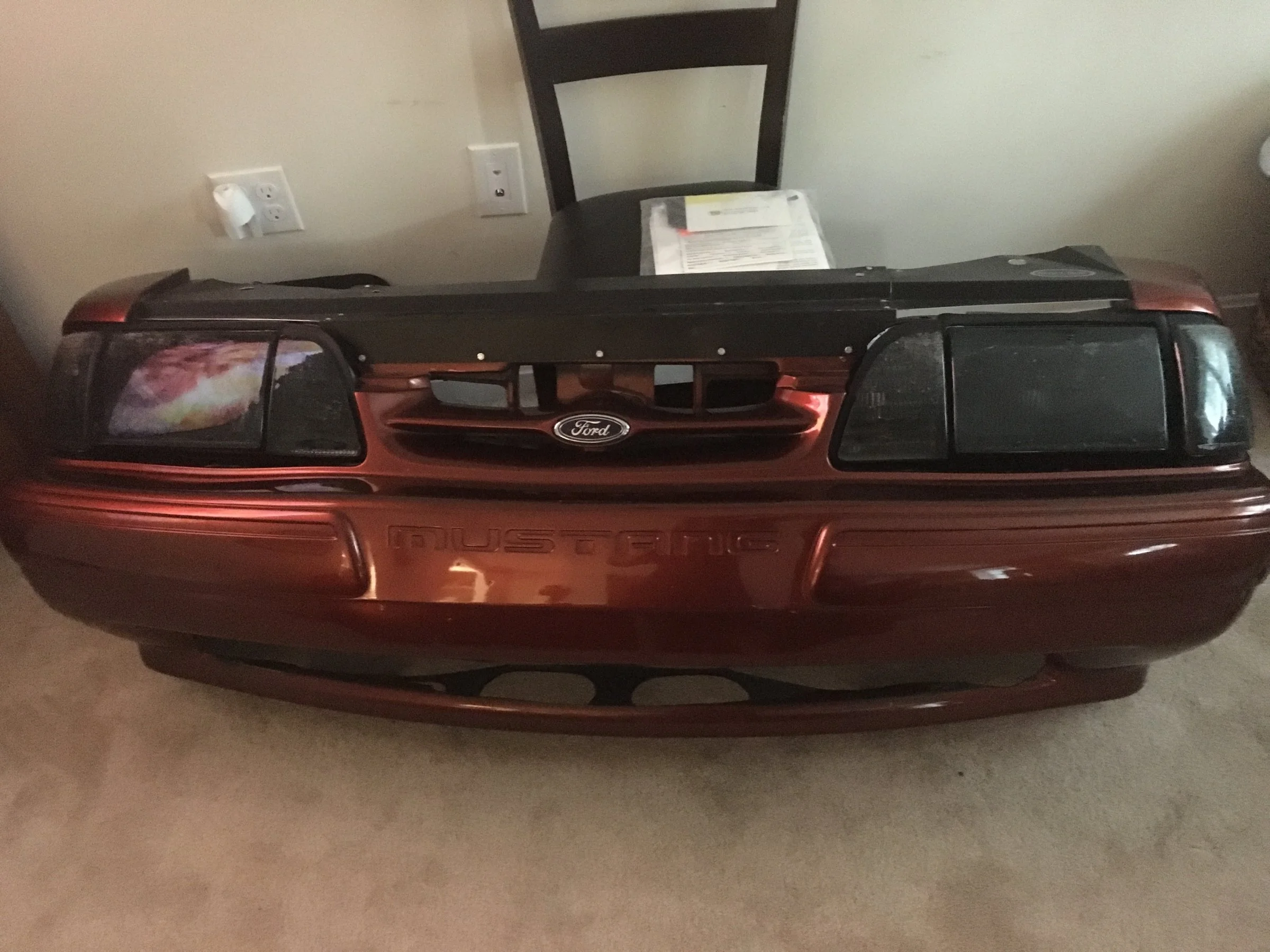

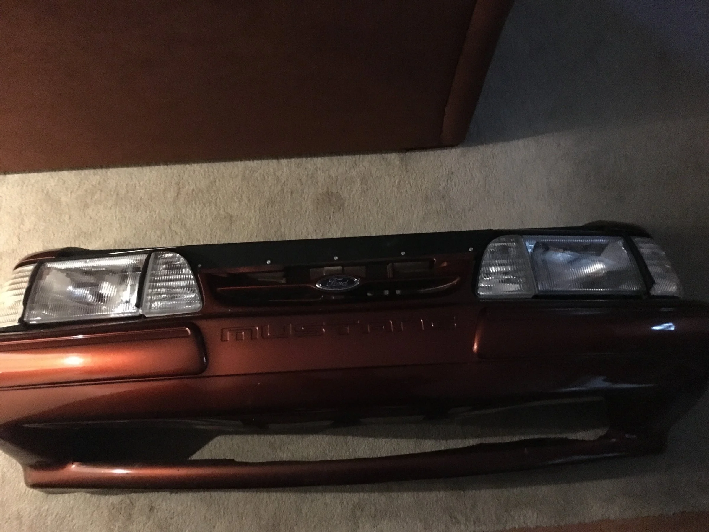

Well took the bumper off again to change out my headlights don't ask me why but my tinted ones were starting to crack so I didn't like it and wanted a change of look so went with just regular lights for a while.
Here's what it was before
Here it is now
Now I don't have one on the car yet as it started to downpour here in maryland
