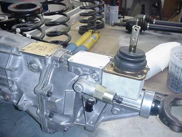

Yeah well picked up a t-56 6 speed from today. Along with an aluminum flywheel and clutch set. :D
Now does anyone have a clue if it will fit in the tranny tunnel of my 67'???
How about a cable clutch from modern driveline?? Or similar?
I can't quite figure out what that gold colored solenoid looking thing is for right next to the shifter anyone know?
That's the reverse lockout solenoid. It's to prevent accidental shifts into reverse. There are a few ways to address it but two most common.
1. Do nothing, leave it alone.
2. Connect it to the stoplight switch on your brake pedal. That way it's only activated when your foot is on the brake.
You will have to do tunnel mods.

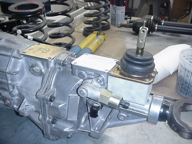

I believe the solenoid is the reverse assist solenoid. You can run without it. Many of the guys swapping in T-56s into Fox bodies make extension boxes to move the shifter back. I have yet to see one with the solenoid re-attached.

DOHC- It's an Electrical Speedo set up. Puts out the same paramaters to the eec from what I understand just doesn't drive the speedo the same way. I'm using an auto gauge electric speedometer anyways.

Is the tranny really that much wider than say a an AOD or t-5 that required to tunnel mod to fit?
I like how they did that shifter got any info on it? I had planned on using a set up similar to mustang +'s restomod shifter handle extension already but can see myself doing that one instead. That way I can have a steeda tri-ax shifter.
you will have to cut tunnel or it won't fit . just done my 66 fastback t56 http://mustangandmore.50megs.com/pages/Tremec.html
They started out with a solid block of aluminum and milled the box almost identical to the original T-56 shifter box. Then they fabbed the pieces to attached a solid drill rod to the oriignal shift rod to extend it back to the new box. They used the original shifter handle assembly in the new extension box.
Most people use a setup similar to the M+ one. A couple of the Griggs race cars use a similar setup as well.

Never though of that brake switch I'll decide how it goes. Maybe I'll just leave it alone.

I know that solenoid is used for the skip shift in camaros and trans ams. Never heard of a reverse assist solenoid. Either way, you don't need it.
As I understand it, the solenoid attempts to prevent you from accidentally slamming it into reverse. It's call an "assist" because it can be overpowered (so it's not a lock out).
However, I admit that I am by no means an expert on the T-56. I merely went off e-mail correnspondance I had with several people who had swapped T-56s into non T-56 cars back when I was deciding which trans I wanted to go with when I did my swap. These people called it a "reverse assist solenoid" and gave the description above.
Just my $0.02
Yeah it doesn't lock it out. It works by having a little force when going faster than 5 mph. So you don't accidently go into reverse.
If you leave it alone and unplugged to anything it'll just take about 20 lbs of force to get it into reverse.
