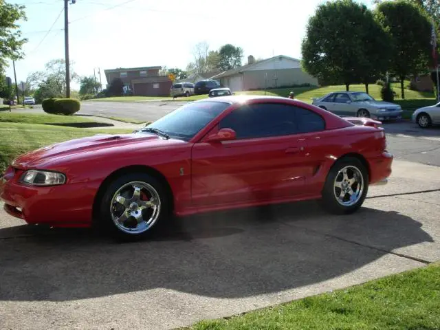

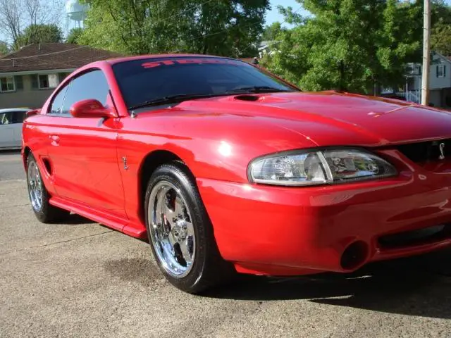

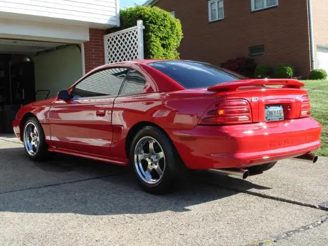

Pics of the car:

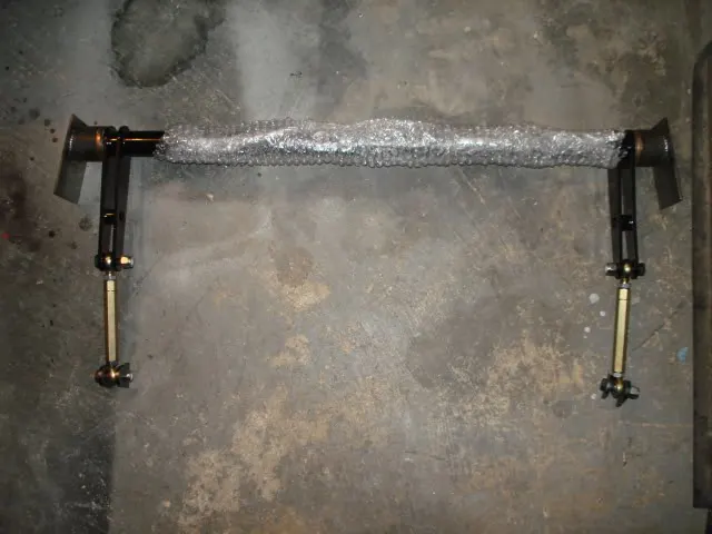

One of the pieces that will help this project along.....
Team Z Extreme Duty Anti-Roll Bar
A good Anti-Roll Bar when adjusted properly will help the car leave straight without binding the suspension and causing spinning, wheel-hop, unloading, etc...
You still need good quality upper and lower control arms when using an ARB.
