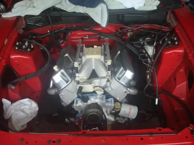

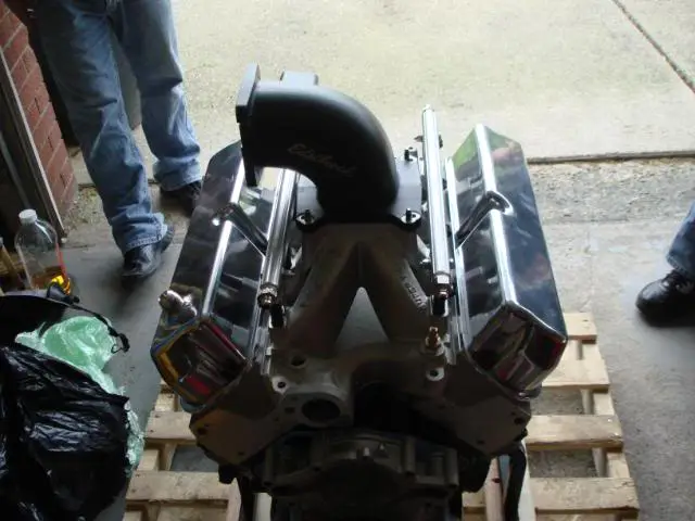

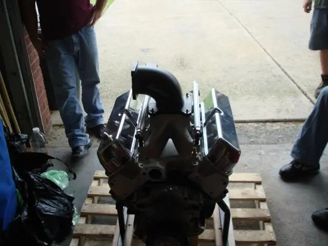

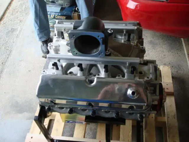

"Project FordStrokers 385 Pinks All Out" Norwalk OH
Going to have to re-name this:
"Project FordStrokers 369 for Pinks All Out"

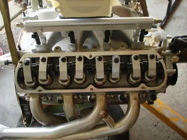

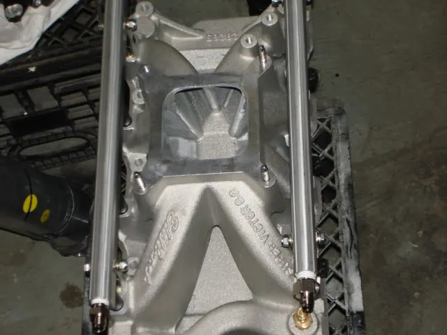

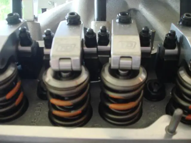

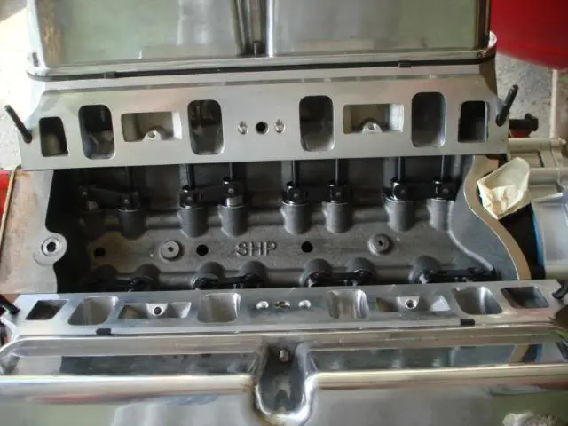

Dart 8.2 deck block
FordStrokers 4340 Forged Steel 3.400 stroke crank
Scat 4340 Forged Steel H-Beam Rods 5.400 w/ ARP 2000 Bolts
Probe SRS 2618 Forged Pistons (Flat tops) 4.155
Clevite 77 Bearings throughout
ARP Main Studs
Canton 7 qt. Oil Pan
Were getting close and im very excited!
Thanks again to Jim & Nicole at FordStrokers!
Also calling tommorow to order my new custom cam!

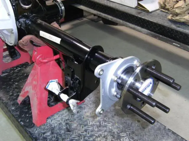

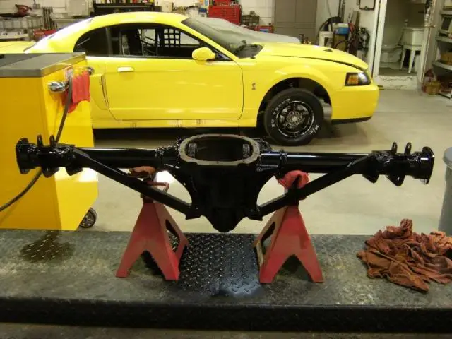

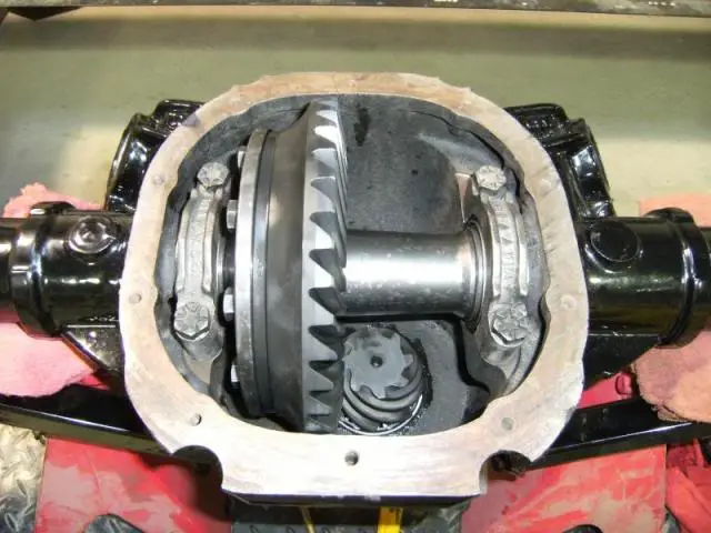

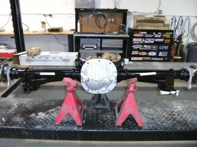

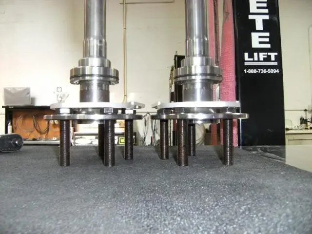

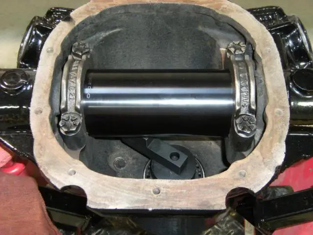

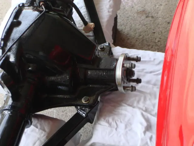

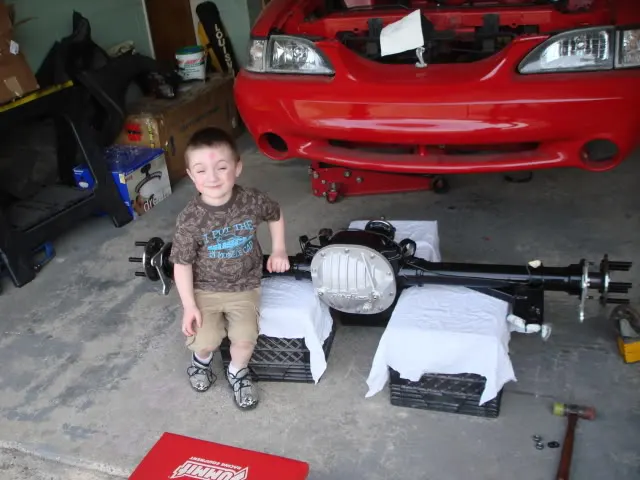

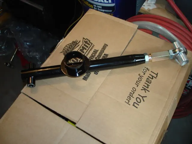

Here's my 8.8 braced & welded rear-end with all parts coming from Dave @ Team Z Motorsports - Suspension Kits and Components for hardcore Mustangs & more! and all of the assembly and labor coming via Mike @ Late Model Performance & Chassis Dyno Services!!!
Im extremely happy with the service and support provided by both Dave & Mike!
