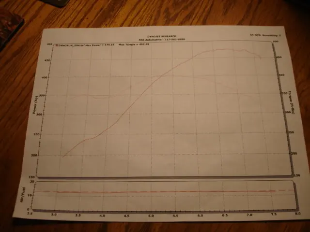

Peak hp was at 6800 and peak tq was at 5200
Peak hp didnt fall off very much through the next 1000 rpm up to 7800
There are some vacuum concerns that I need to get fixed.
Im going to get them taken care of, put some time on the engine then probably re-dyno it.
great numbers i bet it will make more with some break in time
Im sure it will, but all im truely worried about are the numbers it runs at the track!:D
very nice Rob. How close are those numbers to your original thoughts?
Thanks bud! I was hoping to break 500 rwhp but wasnt able to as the cam I have is very small and probably to streetable for my combo....:shrug:
Down the road after Pinks I might throw a big cam at it and see what she'll do!
you are saying a cam that pulls to 7500 is small? i would love to see what you call a big cam lol
You gotta remember that cars come from the factory nowadays that rev to 7000 all day long with 100,000 mile warranties....:shrug:
Its be no means a small cam, its a descent size cam for a street car which idles and drives perfect.
I could however put in a huge cam and make more power but throw all drivability out the window....:eek:
Im not quite ready to take that step just yet......lol:nono:
