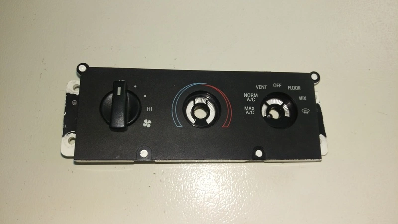

I bought an HVAC control panel used from a guy on Corral. I thought it would come with the blend door controls and the vent controls. It didn't, so where can I get those? The vent control doesn't have any detents anymore, it just moves and is very sloppy.
Confused on what controls you mean. Pics?

The part or parts that are behind the HVAC controls.

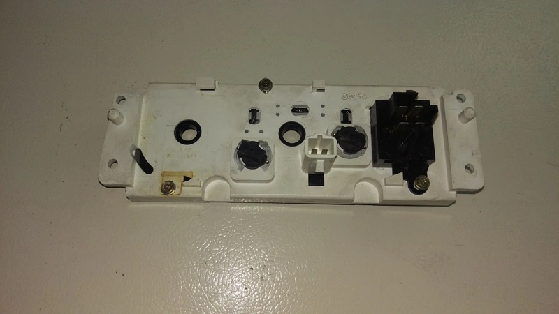

I need the parts that go behind the control in the pictures. The part in the pictures is what was sent to me, I need the rest of it.

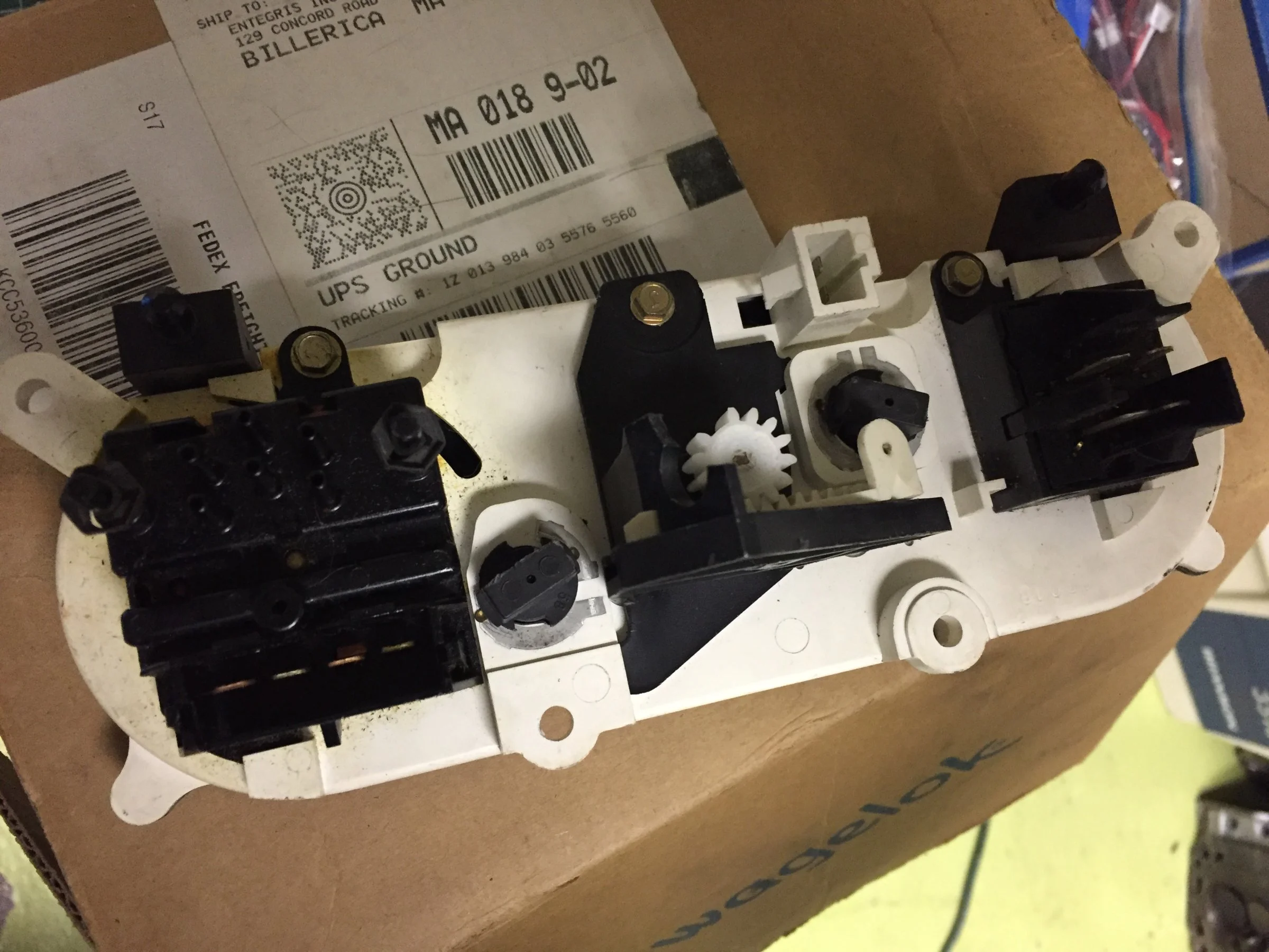

Ahh.
To be honest, if I were buying that hvac setup I would expect those parts to come with. When I bought a 90-93 set on eBay, they were included.
You'll have to find another unit to get the parts from. Unsure if the 87-89 years are compatible in terms of those parts on the back.

Correct, and the bolt pattern is different so they won't work in 90-93 dashes, but the parts in the backside could be compatible.
Look at your pics, I think the black parts on the rear are compatible

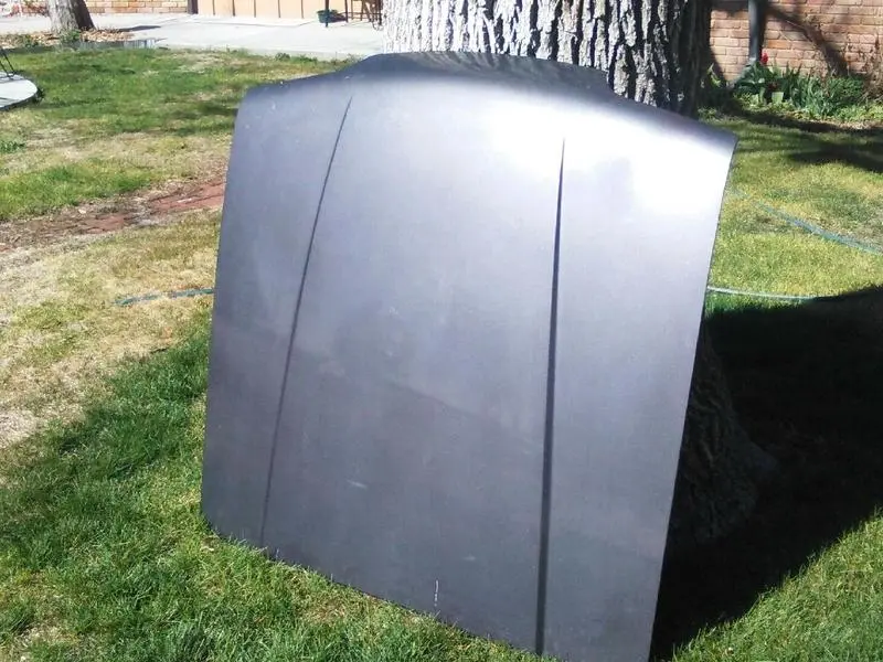

Found this hood on Craigslist for $50. It's off of a 1992. I don't have it in my possession yet, and a friend is picking it up for me. It's about 55 miles away in Greeley, CO. Looks very straight and is in far better condition than the hood on my car. Hopefully it fits better too.

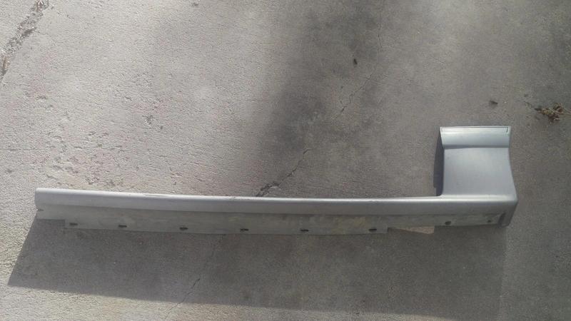

Picked up the hood yesterday. The guy was really cool, he even threw in a passenger side skirt for free. Turns out he was parting out a car, and the hood and side skirt were all he had left . The hood is in amazing shape, I think I can get away with sanding and painting it white when the car gets repainted.

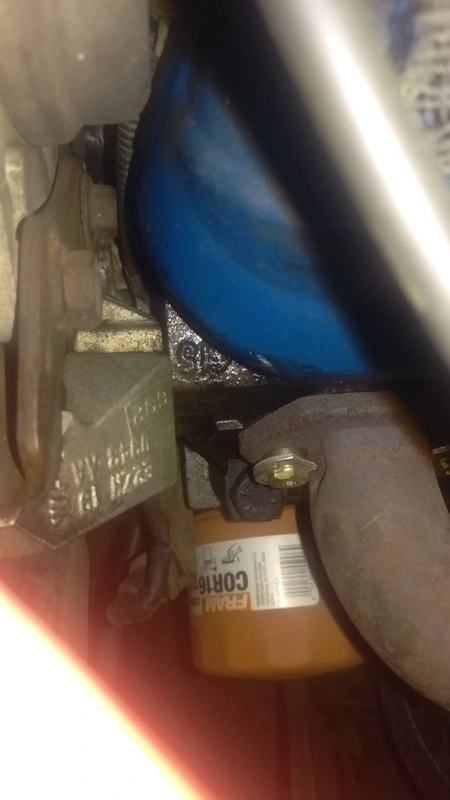

I was tinkering around today on the car, and decided to look in the oil filler cap. What do I see? ROLLER ROCKERS!!!! From what I could see, they look like Ford Racing rockers. They're silver, and look like this...
I'm beginning to wonder what's been done to the engine. It has Hooker equal length shorty's, roller rockers, the timing cover is for a carbureted engine, the engine is black and valve covers are blue. I'm not sure the heads are stock E7TE's.
Here is a picture of a casting mark on the corner of the head where one would normally see "GT" or "P". Instead I see what looks like "12". Please ignore the Fram filter, it was there when I bought the car. I have a Motorcraft filter for it on the shelf.
