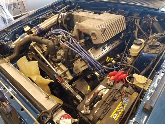

All oem tensioners, as far as I can recall. I've seen springs worn out, broken springs, pulleys wear out, and the case itself come apart. I've got a couple good oem tensioners in my parts stash right now, but I don't think I'll ever use one again. I like the March setup. I like setting the tension myself, it cleans up the front of the engine a little, and there's less moving parts to fail.
In the pic I posted of my 88, a previous owner had installed an ac eliminator bracket. It was the worst setup I had ever seen lol. By the time I got the belt off, I think I flung the tensioner into the woods by my old house.

curious- where is your fan shroud? Hopefully not in the woods next to the tensioner.
broncojunkie
Apr 12, 2014
92
24
29
May 9, 2017
#49
  • May 9, 2017
  • #49
The fan shroud didn't fit too well with the new radiator. Instead of shimming the radiator to line up the shroud to locate it properly with the fan, I just left it off for now. I have a 3g alternator and electric fan I'm planning on using. I haven't got around to it, but it's on the list...along with a 5-lug swap, cleaning up some wiring in the engine bay, subframe connectors, and a few other odds and ends.
