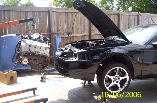

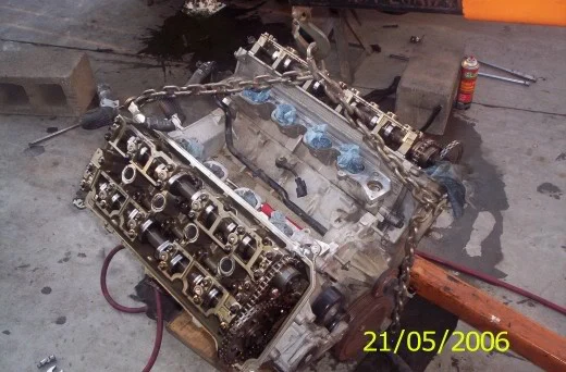

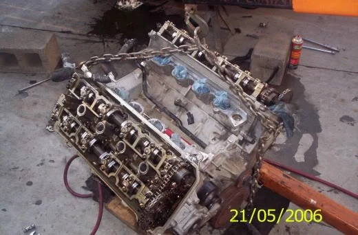

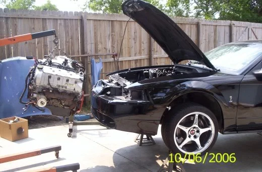

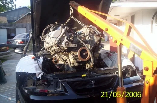

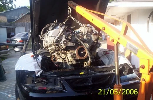

i yaned my 99 cobra motor out from the top, i left ps hose's hooked up just unbolt it from the block and lay it to the side, the a/c leave it charged up just unbolt the 3 bolts form the compressor to the block.no gnds at back of motor just some sensor wires that need unplugging. i know it a mother ducker.as far as what holes to use to pull motor ill post a pic for you hang one
heres going back in with intake on.
here pulling with intake off.

thomas91169 said:
dam with the hood still attached? thats like the first thing i remove if i know i will be doing prolonged work to the motor compartment. it always seems to piss me off in the most in-opportune times.
I wish I removed mine.. the hoist knocked a hole in my hood.. :nonono:
I have had engines out of my cobra four times. First time I dropped the k-member with trans, the next three times I went out through the top after taking the trans off. I am by far quicker taking the engine out through the top. When it comes to the hood I take off the drivers wiper arm and have someone hold up the hood while I jack the engine out of there, the hood will go straight 90deg so it won't get in the way.
