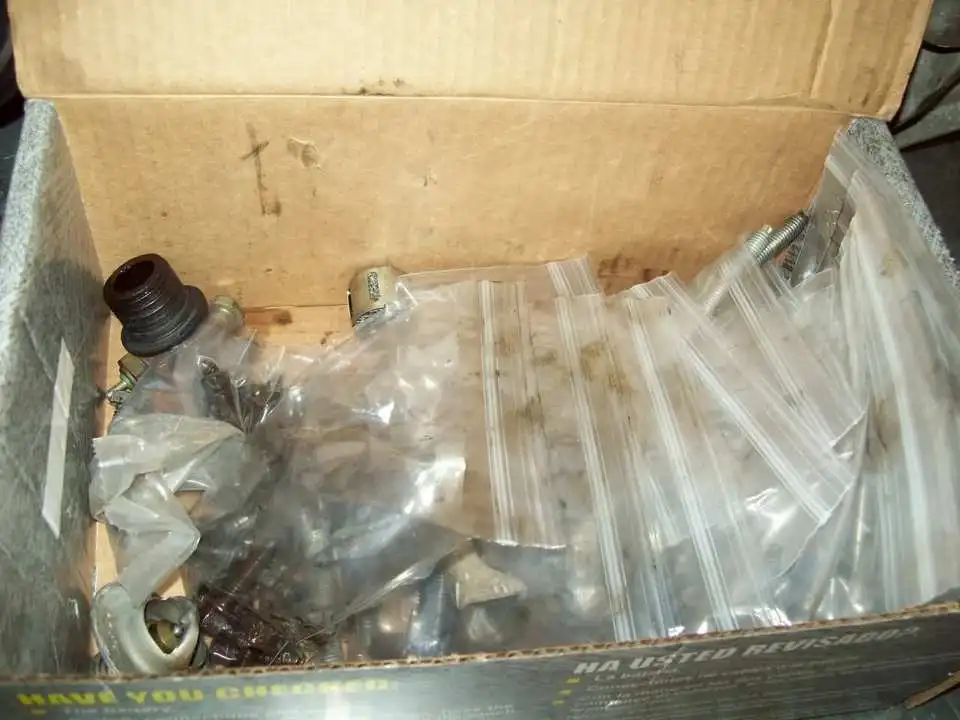

Forgot to add.....since it is your first time....get some plastic bowls / bags and label and separate all the bolts that you pull out....screws/bolts....keep them with the parts you pull off. After a few pulls you remember but it will take a little more time at the beginning but you want be searching for a "certain bolt on install.....
Hope my babbling helps

I am in the process of doing this right now. I didnt build the motor though.
1) Get plastic baggies and a marker and put your bolts in the bags and write what they went to on them.
2) I put a piece of masking tape on all electrical connections with what it was writtten on the piece of tape. easier than searching through pics.

I would take digital pics, get the glad baggies and a sharpie for labeling bolts, and BUY AN ENGINE TILT for the picker if you are pulling the trans at the same time. Be prepared for fluids. Get cat liter, or oil dry. Trans fluid, power steering fluid, coolant are normal. I would get laquer thinner as well. I like to soak all the parts in it to remove the crud and it cleans everything so well.

x20 on the bags with labels of what bolts go to what.
I did this mostly for the engine/tranny and everything inbetween.
I would have done the same for everything in the engine bay but I got 2 cars worth of nuts and bolts so It shouldn't be a big issue.
