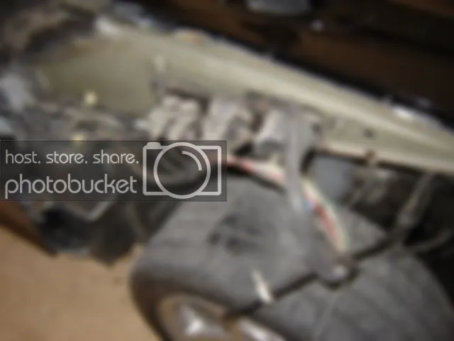

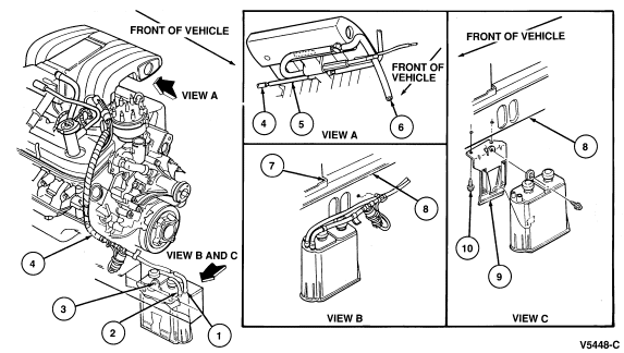

Background, bought a 95 cobra vert from another member with a massive vacuum leak, and other issues I 'll cover in my thread in gen talk but I have a question about the lines pertaining to the purge canister right now, replaced that vacuum line from the intake to the solenoid to the canister (I think I know why the stuck it inside the fenderwell, more on that later), line from tank is good, new line from intake/solenoid. There is two nipples that are T'd together then runs toward the front, down to and stops at the frame pointing towards the engine compartment.
Is this just a vent? It shows no sign of ever having a hose connected.
Yeah, the big hose towards the front is just a vent to get the stank farther away from the cabin. I included a diagram, and a near worthless picture.

I found that out, that's why I posted the question. Even the Alldata info was not clear.

The only reason I know is because when the Cobra came back from the body shop, they routed that line into the engine bay. I had never seen it, nor noticed it before, knew it didn't go there, and we had to figure out where it went.
