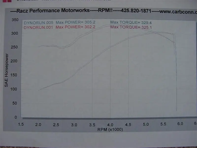

I finally got around to putting the cobra on the dyno today. Last August, right after I put the car together, and before the tweecer, it put down a dismal 280 rwhp and 300 ft-lbs.
Today it redeemed itself by laying down 305 rwhp and 329 ft-lbs. I am pretty happy with how it did.
Combo:
AFR 165 CC pedestal mount heads
Cobra intake with ported lower
70 mm throttle body
80 mm MAF
FTI custom cam
1.6 scorpion rockers
Shorty headers
OR X-pipe
Magnaflow catback
Tweecer RT

the graph looks alot like the KillerCanary fellow's. Yours hung on for about 10 more hp at the peak however, but he didnt get the <3000 torque dip. Sounds like a very small difference in cams.
Glad you are happy with the combo... Im sure it pulls nicely :)
