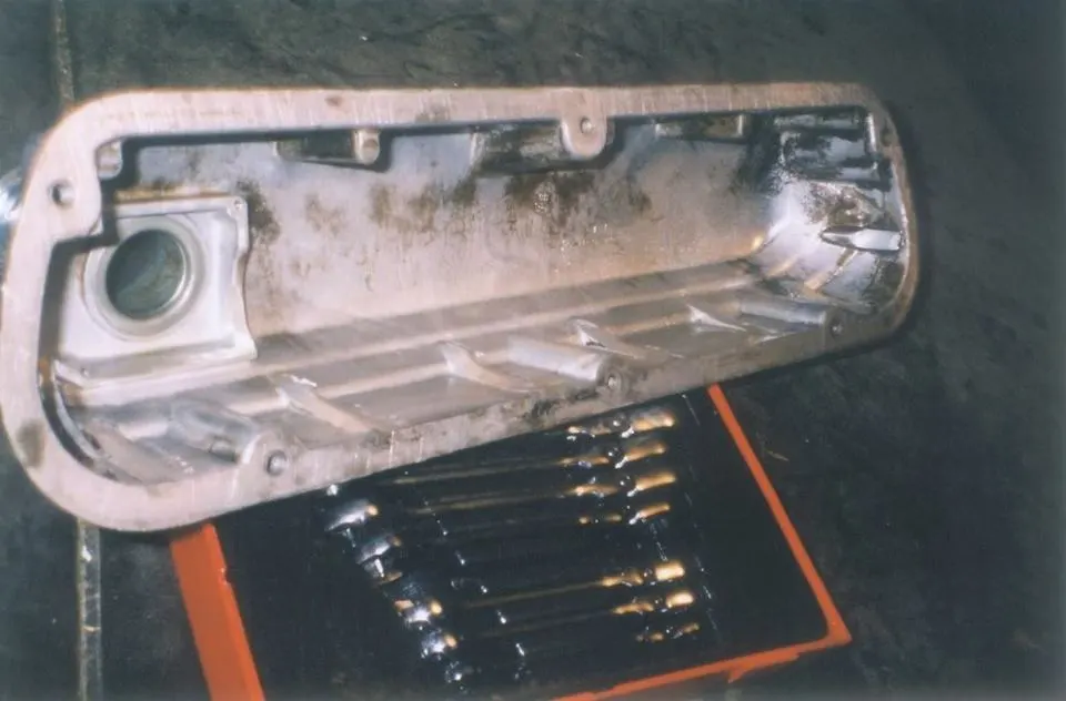

This seems to be exactly what is happening, as most often the addition of a valve cover baffle (and no other changes) will completely eliminate oil control issues in this line.
All the baffle needs to do is block the splashing oil from getting up the filler neck.
EDIT: Don't think of it as oily air being pulled through the TB/VC line. Instead think of it as oil being flung into the TB/VC line by the rockers.
If you have ever adjusted valves with the valve covers off you know how messy this can be.

if this helps you guys visualize. Here's my valvecover, I had to remove the baffle and grind the ****er out to clear my rockers. You can see how the original baffle kept the oil from being slung up by the rockers. I personally don't have the oil problem from my VC->TB. If it does develop, I don't see how it should be too hard to rig another baffle, inside the filler neck.
