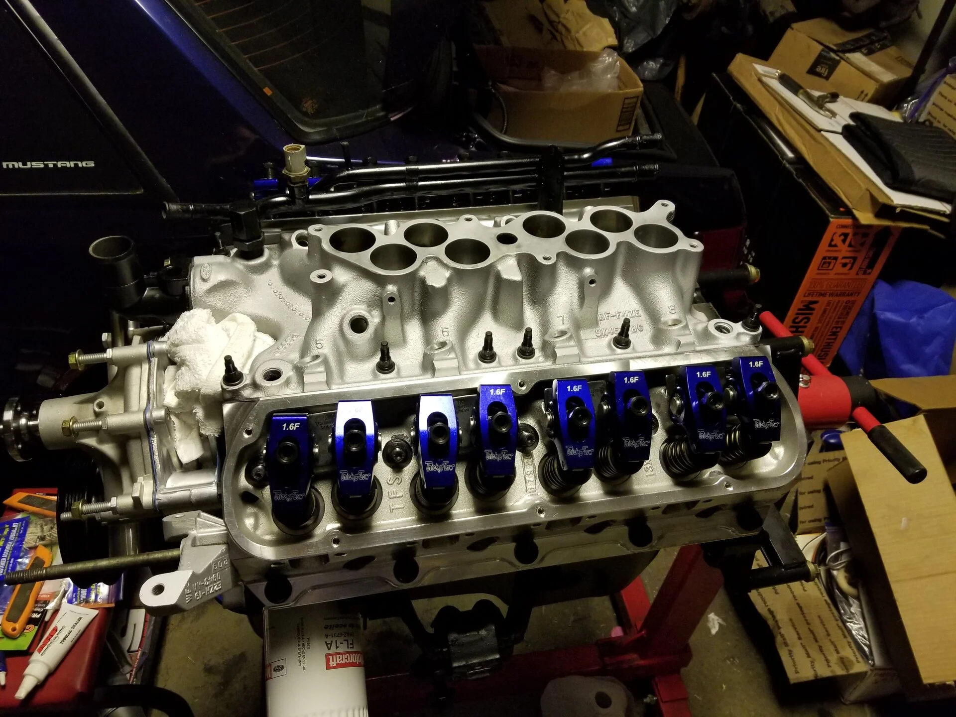

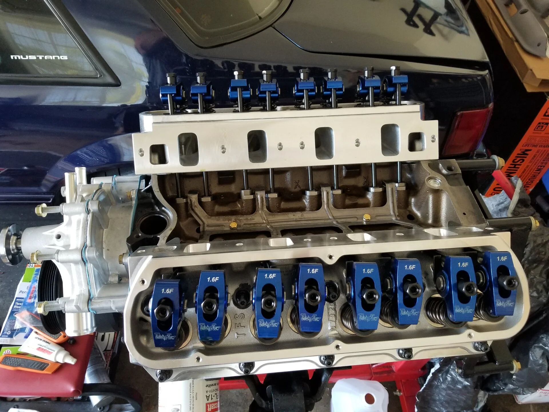

Love the GT40 intake and I run the same heads on my motor now. I hope you have better luck then I did with an S Trim on my factory block...

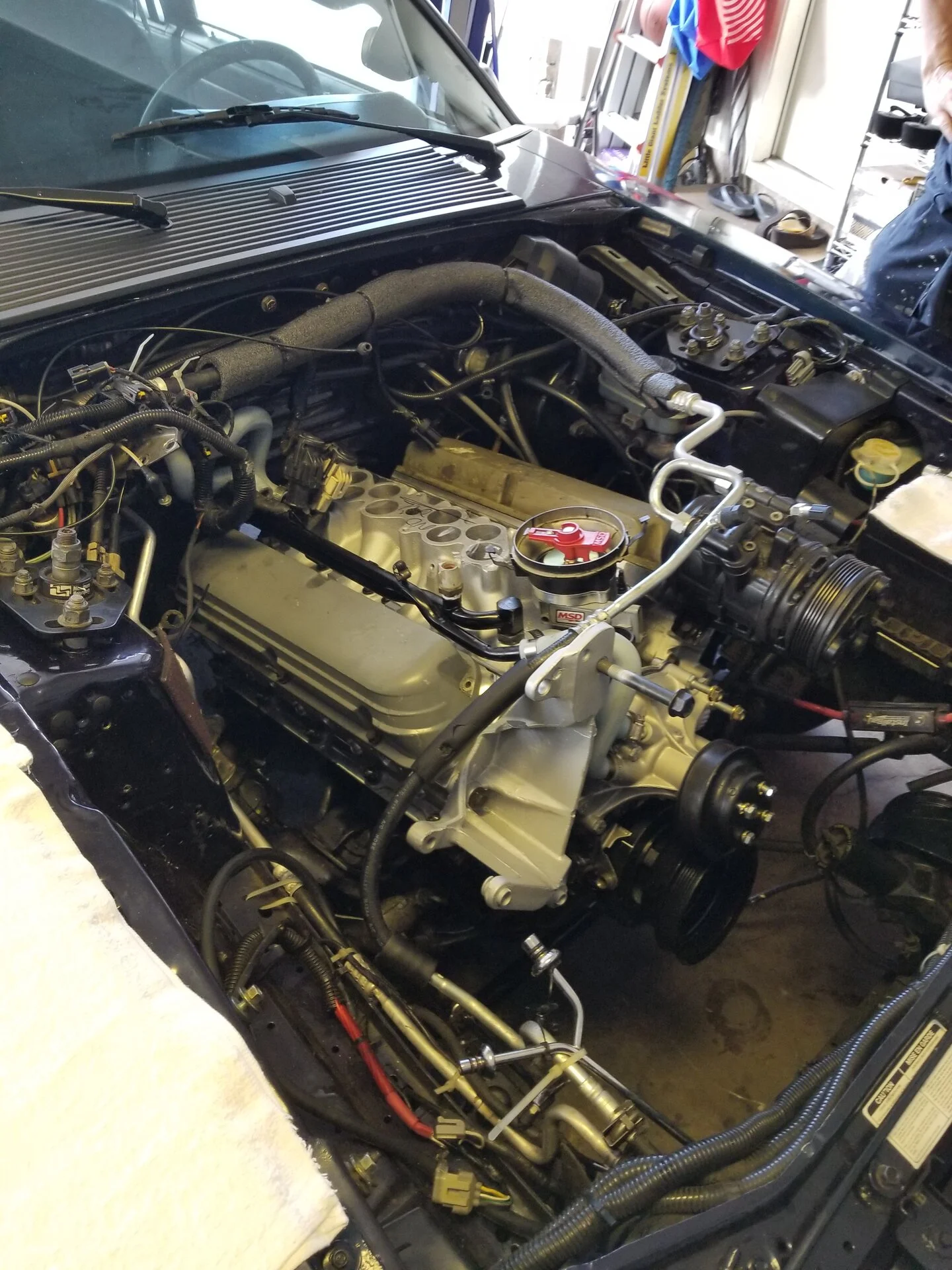

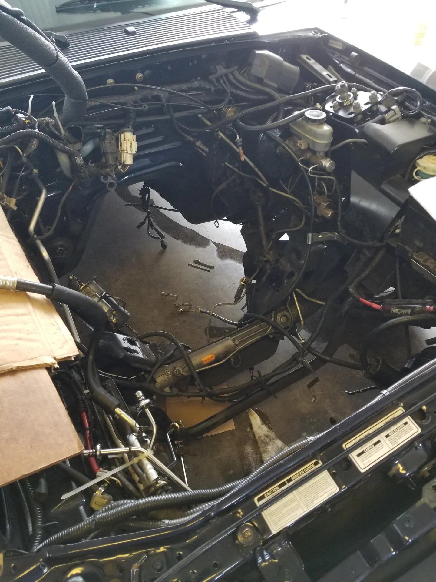

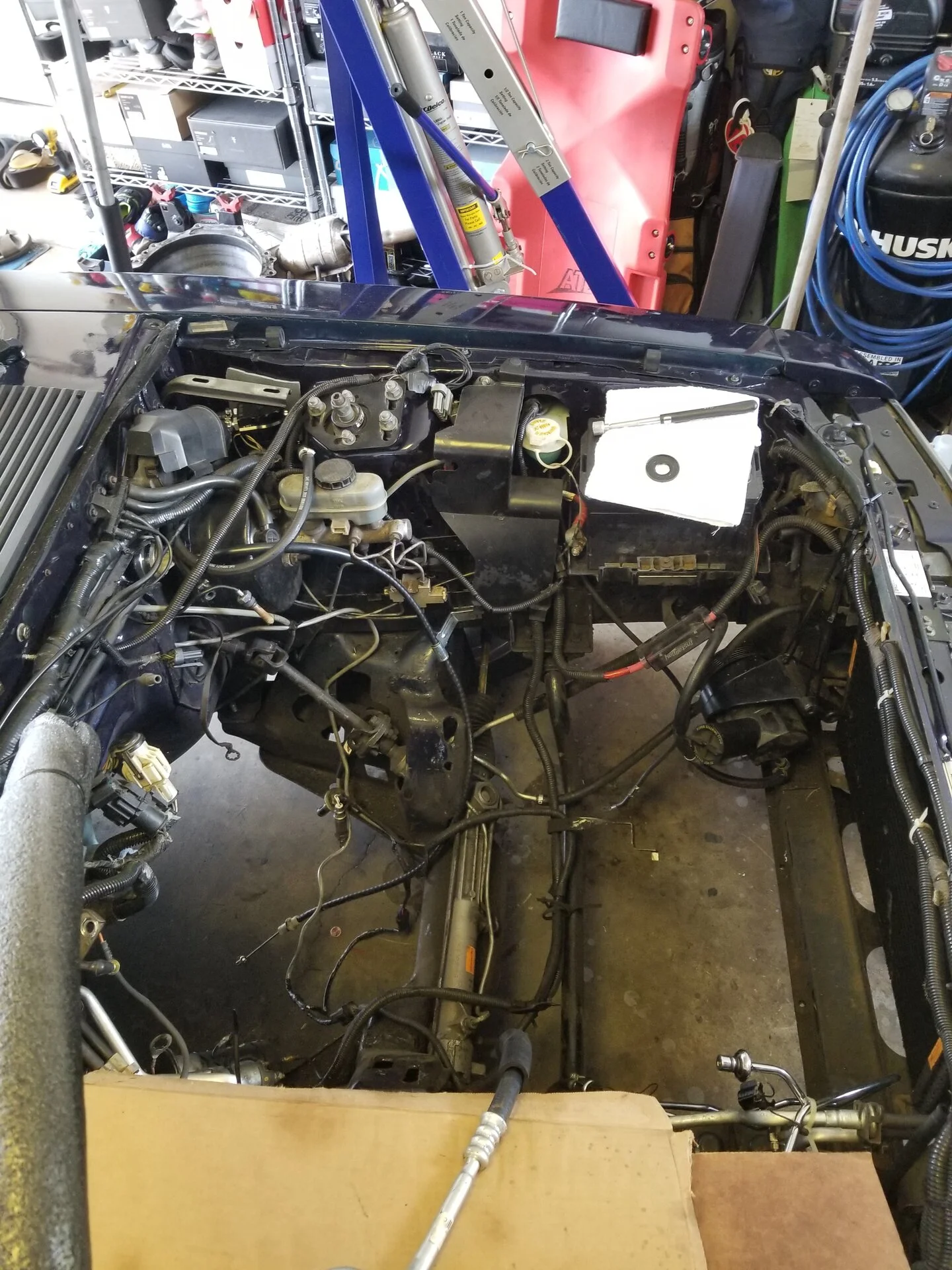

Old one out. New one will go in tomorrow.
I really envy you guys living on the big rock. I had to order valve covers, mine just would not work. Those $130 trick flow covers that you guys get shipped free.....$209 to me. That is $79 dollars more I have to pay for the same thing. It sucks.

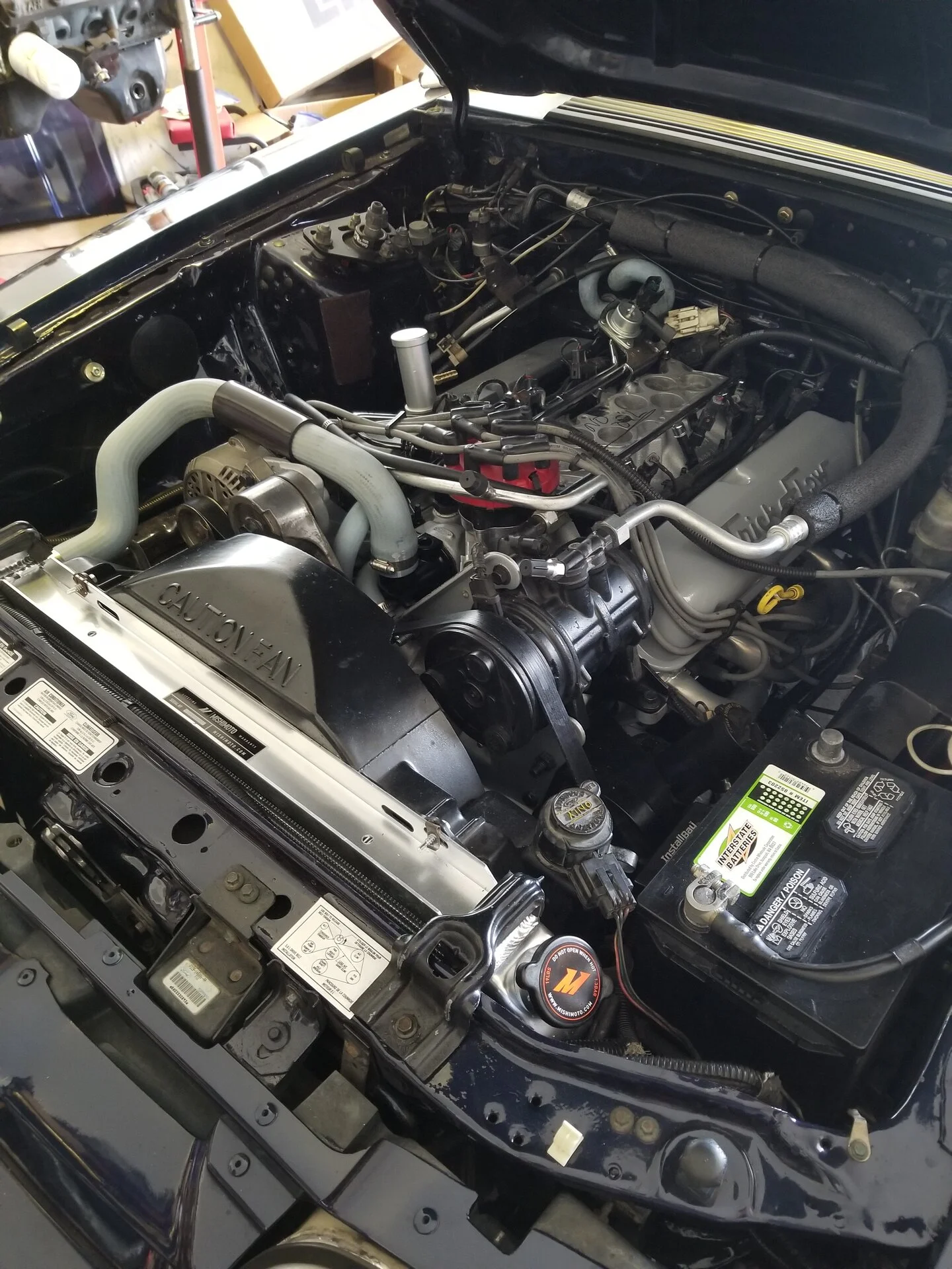

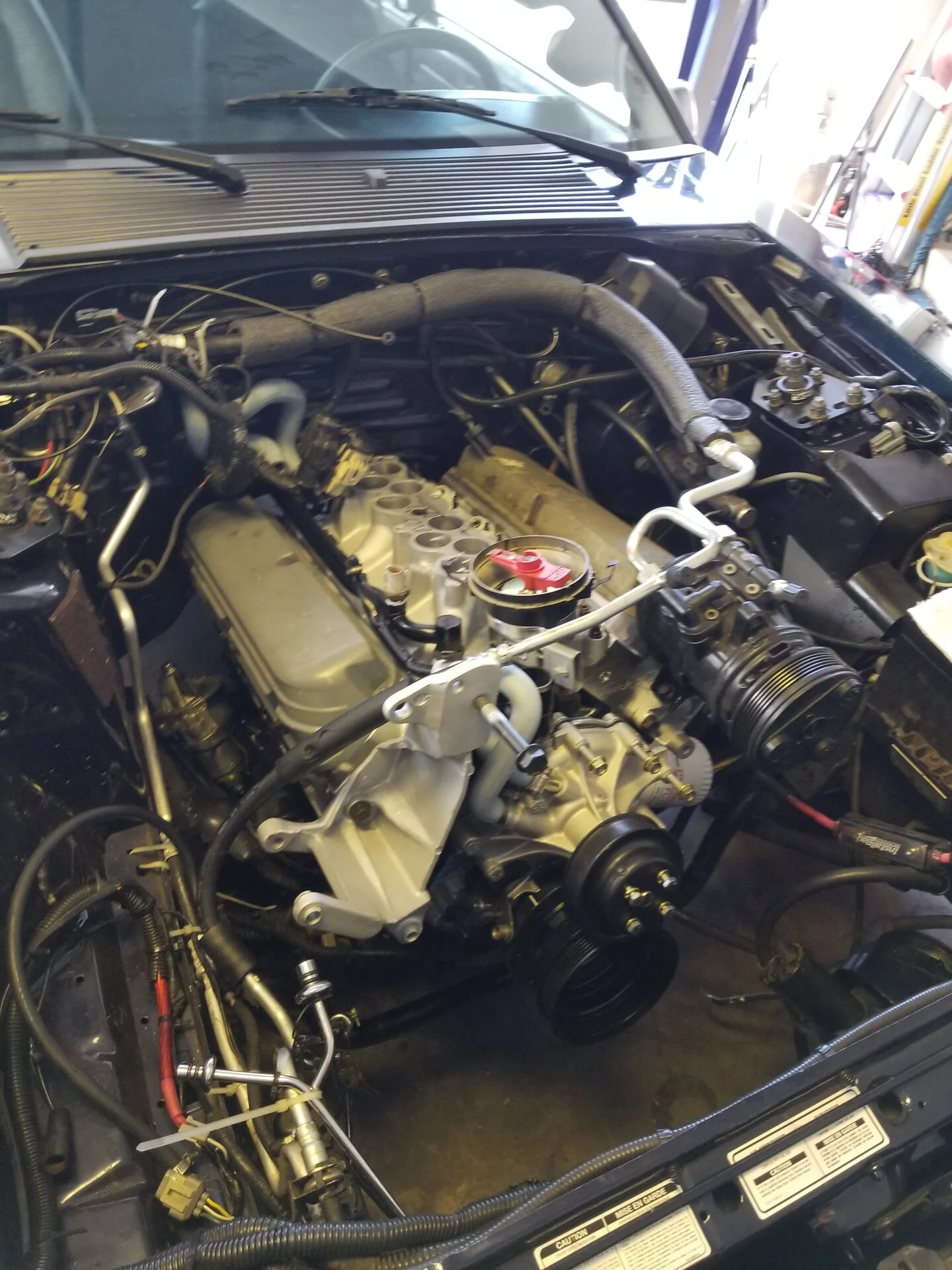

I do wish the ac hose didn't cut across the top corner, I've thought about getting the hose modified with a nice right angle to clean it up, that shouldn't effect the efficiency. RIght?
A gentle bend 90 deg fitting instead of a hard right should be fine.

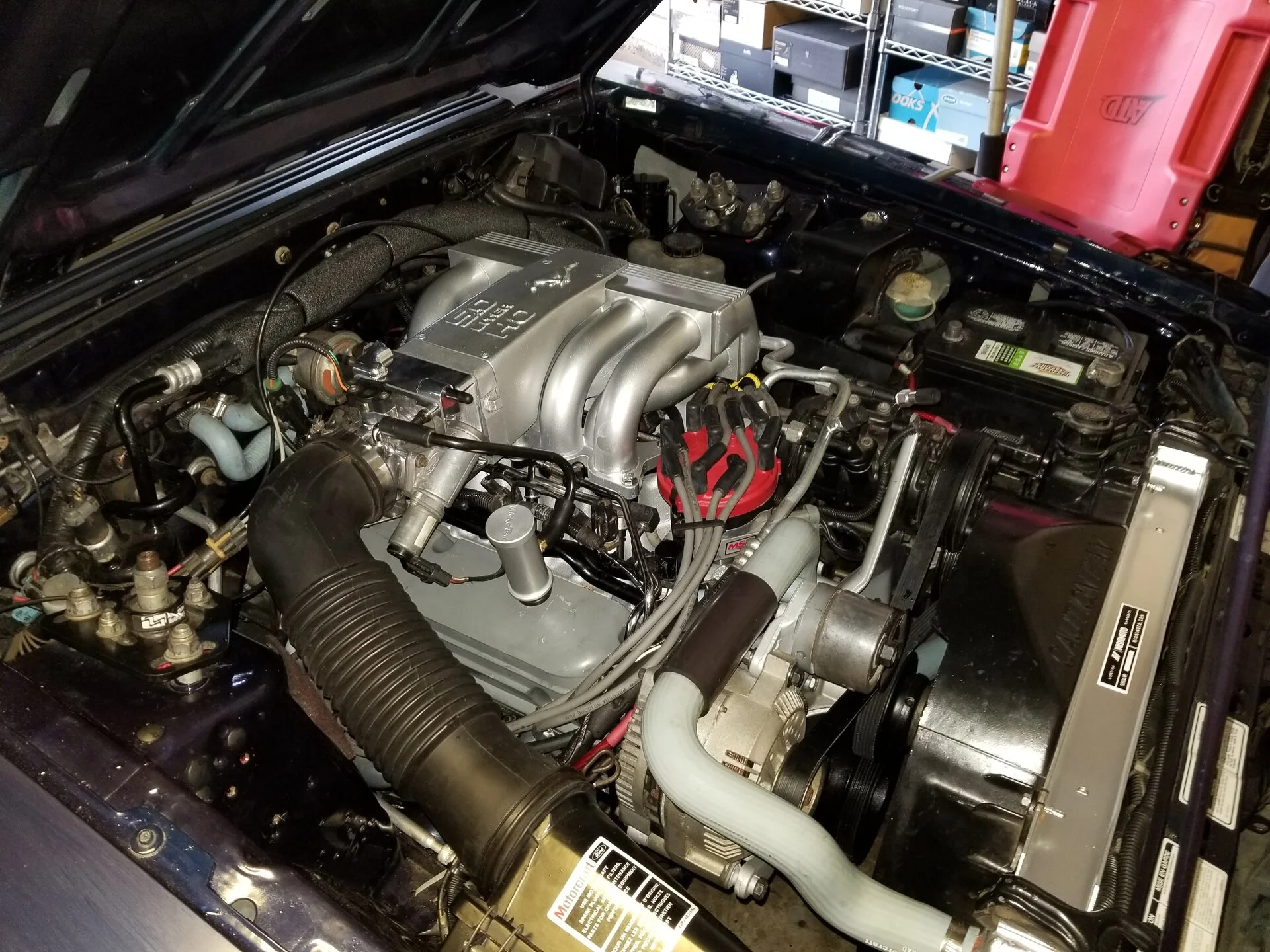

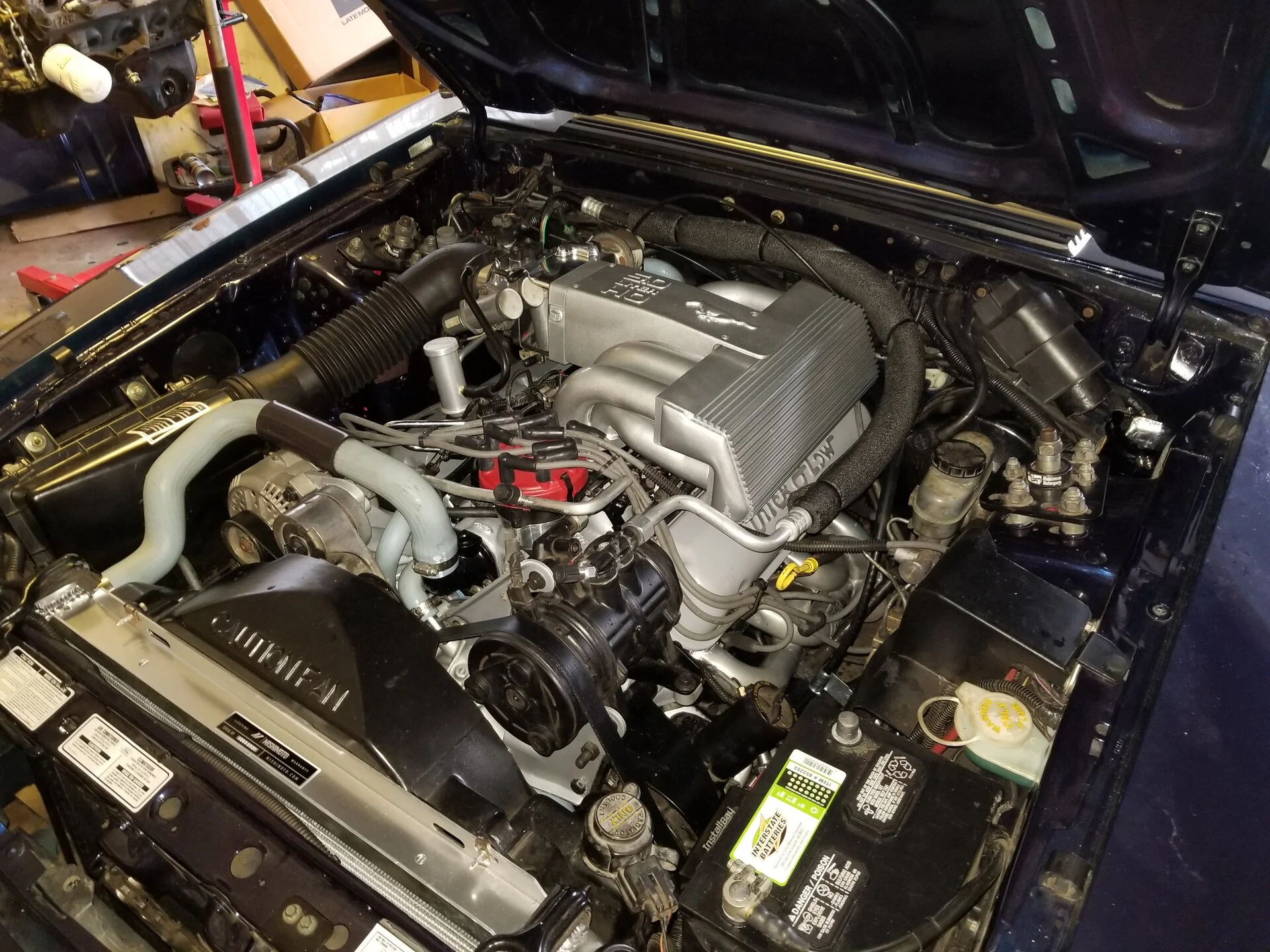

Engine is in. Looks like poop with those old valve covers. My new ones arrive tomorrow. Primed the oil, pressured up the fuel lines and checked for leaks maybe tomorrow or Thursday I will get it started. Any advice on break in or just start it, drive it and don't beat on it for a while?
