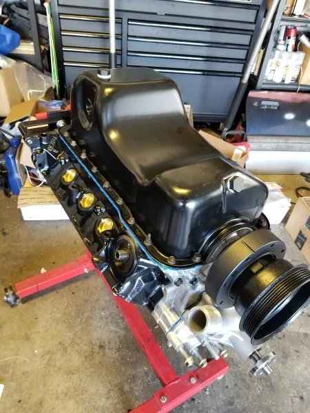

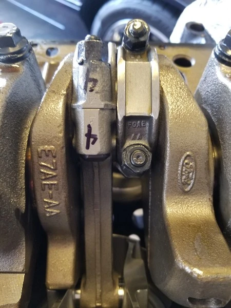

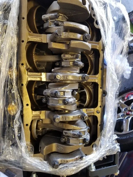

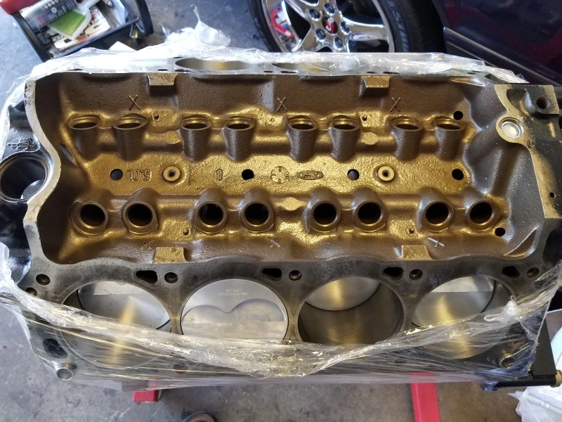

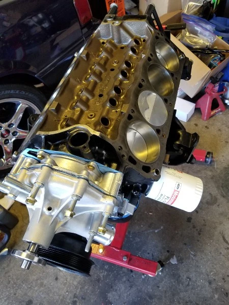

Just got my shortblock back from the machine shop. It's a .030 over 306, forged pistons, stock crank. I had them assemble the rotating assembly and I am putting the rest together. I need to order my heads still, going with the Trick Flow 11R 190 heads, and at some point in the not too distant future an S-Trim will be added.
Unwrapping

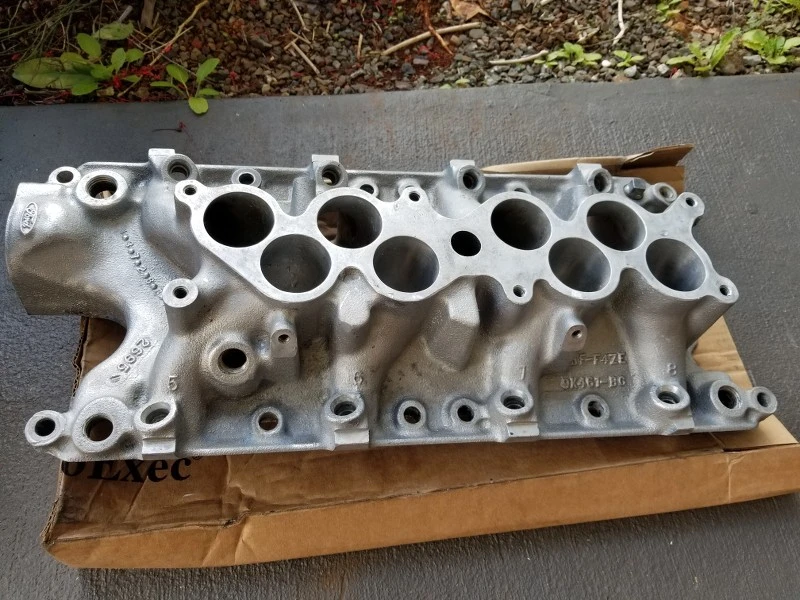

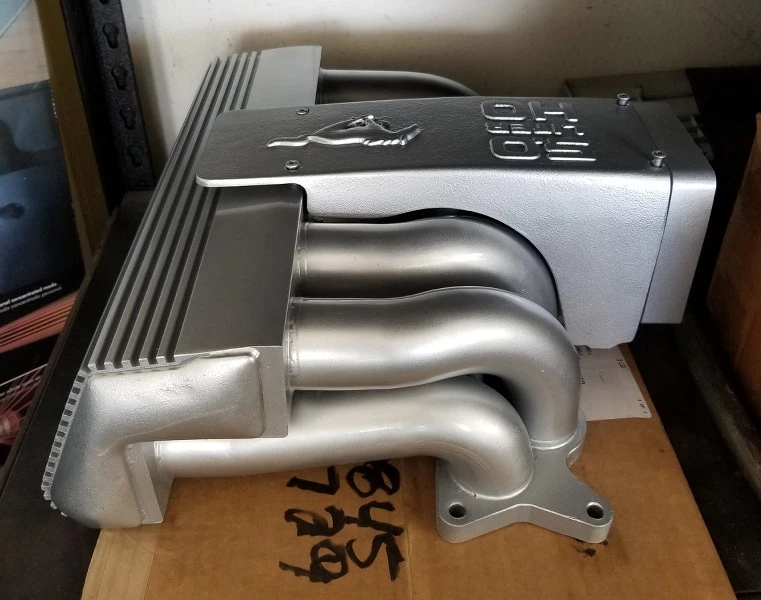

This engine will go in my 93 coupe. I am using this intake....Yeah, I know..there are many better intakes etc. but this is a street car only, and I love the GT40 intakes.
The lower is a true 1994 Cobra lower for what it's worth..

I have ARP head studs, and the majority of the fasteners are ARP.

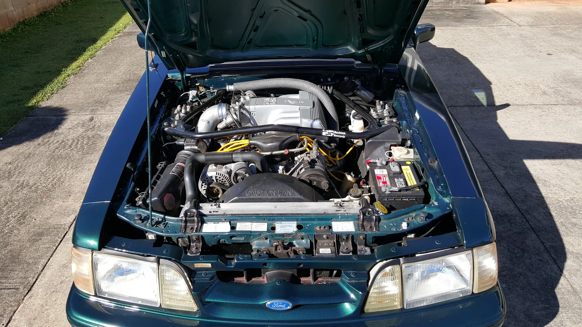

And they say I am a 'collector'!!

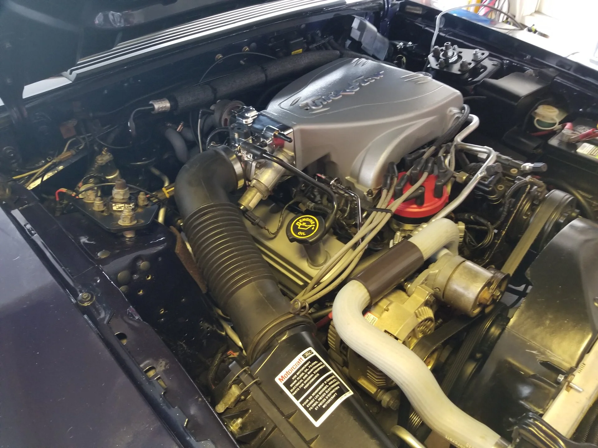

I do wish the ac hose didn't cut across the top corner, I've thought about getting the hose modified with a nice right angle to clean it up, that shouldn't effect the efficiency. RIght?
That intake looks ported. GT40 intakes are really good across the board. Tmoss advertises 250cfm after port work. However, if you are sticking with that intake, and putting an S-trim on it, and you haven't ordered the heads yet, you might look into a cheaper head since the intake isn't going to support an 11R 190 anyway.
I don’t think so. I don’t think they make a longer one though. Nice GT40’s @Mstng93SSP! Wish I had one!

Based on budget I could save about $400 by going with the TFS 170 heads. I just wonder if I will regret it.

I guess that all depends on what you want to do with the car, if you would ever consider swapping that intake later, etc. We did the GT40x heads on the Cobra. They flow 249cfms, and the Cobra intake ported maxes out at 250cfms. It's a Ford head, everything bolts up perfect out of the box. The TF 170cc head flows 257cfm out of the box which is right there too. It's only going to make as much power as the tightest restriction. And hell, if you are putting an S-trim on it anyway, it won't matter.

I’d still get the 11r. The valvetrain is a step in the right direction as opposed to the fast as cast 170s. The 190Cc Has more modern valvetrain as far as spring diameter and valve stem diameter. They’re a good head to grow with.
Can't you go to a place that makes hydraulic hoses and have a longer one made?
we deal with an ac shop that does a lot of hose repairs for us, I will be talking to them when the time comes and I'll update the boring thread I have going that two or three people keep up with if only to see me catch something on fire at some point.

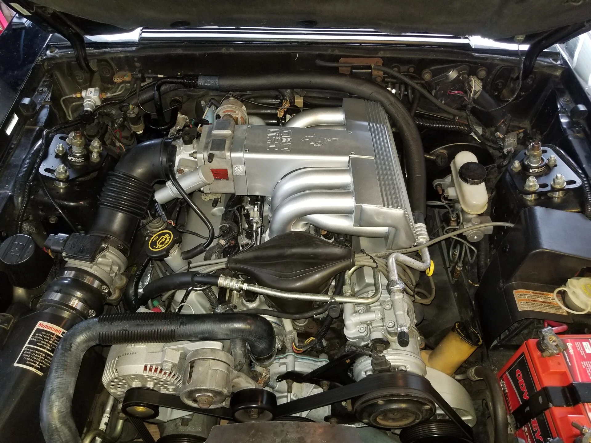

In one of my convertibles I have the Ford x306 aluminium heads and a XE264HR-14 cam. I can't say anything bad about those heads. They have performed well in that car. As far as intakes go, I have a trick flow on my coupe right now. I know it performs better than the tubular gt40, but I am just over the look of it. No offense to anyone using one. I am going to sell mine to recoup some of the cash I have laid out for this engine.
