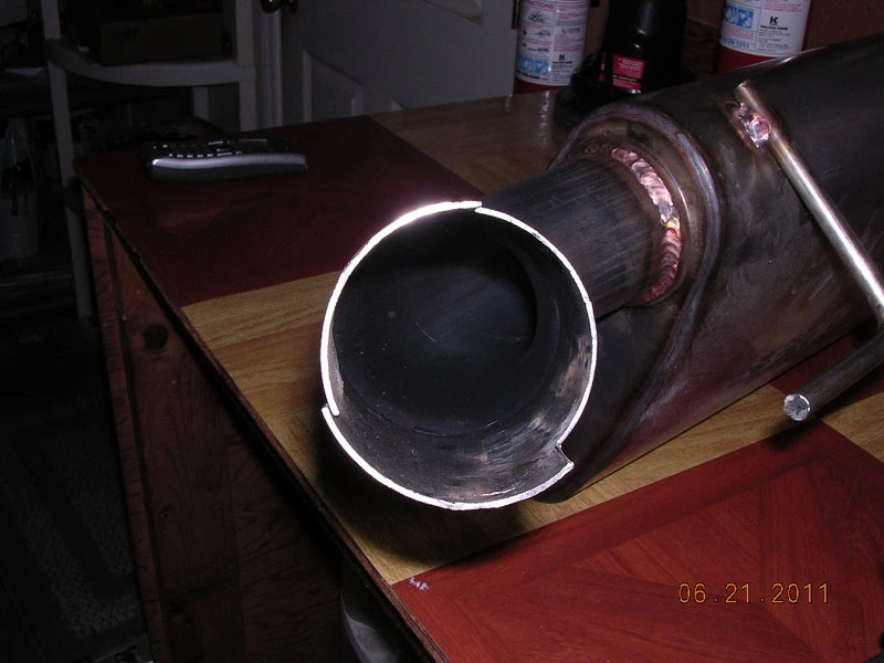

It wasn't the spacer in the clamp, it was going down in the saddles of the spacer just fine. The problem is the sloppy fit of the pipes. They are 1/8 inch larger that the stock Ford pipes and can't compress enough to even hold themselves on let alone create a leak free joint. As you can see from this picture the slit in the pipe is completely closed, even overlapped itself, and the pipe still fell off with a jiggle. If I'm overlooking something please let me know because it sure would be nice to get these to work.

Steve, it may be the angle of the pic, but something doesn't appear right. If you don't mind, can you take a pic of the inlet more from the side and give me a call tomorrow morning. Please email the pic to [email protected]
I promise we'll figure this out right away. :)
Brandon
Got the new set as promised but it's the same deal. The Pypes pipe fit a standard 2.5 inch pipe very well but the stock Mustang pipes seem to be undersized, 2.458 to be exact. Even with 2 slits and the clamp bottomed out tight with an impact gun the pipe still comes off. I'm so frustrated right now. Not what I wanted to be doing on my holiday weekend. Has anyone else ever had this problem? Is it maybe a certain run of Ford exhaust pipes that were slightly undersized? Maybe a model year difference? I don't think the GT/CS is any different than a GT under the skin, not like the old GT/CS.

Thats wierd. I think you must have undersized overaxle pipes. Have you owned the car since new? They were never changed? If the Pypes won't fit then I doubt any aftermarkets will. The violators had a nice tight slip fit on my 2009.

Final Chapter on this Mod
Bottom line is: My Pypes Axle back doesn't fit correctly.
I ended up taking off the mid-pipes (which were stock ford that has been installed on Mustangs since 2005) and heating and expanding them to accept the violators. Not a big deal for a good muffler shop or a gear head with a welder but definately not a 30 minute job in ones driveway unless you want a rattle and/or leak.
The product looks great and I wouldn't hesitate to order and install a full exhaust system, but I would expect to weld/cut/bend in order to get it to work correctly.
