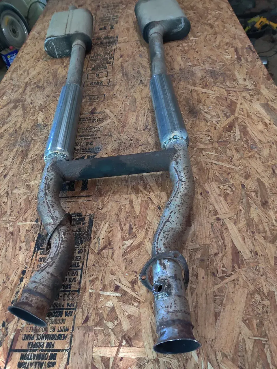

Do not use the 'fiberglass' or whatever packing used today, I'll see what my mufflers are if I can tell, I think they are Walker cheap crap but sound really good, of course there will be a little difference because I have a GT and the pipes are turned down at the end, changes the sound.
Nope, couldn't see a brand or part number, I can tell that the have a V baffle inside from the marks on the case, no other 'tell' , they are NOT flowmasters.

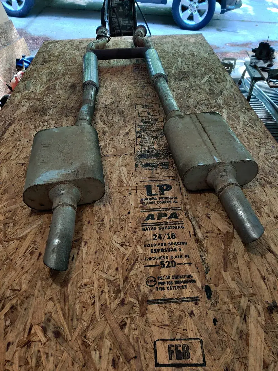

Here's what I have in my Cobra:
What I can say about the Thrush mufflers is that they are loud - that's why I added the glasspacks. I tried to get the longest glasspacks I could in the space I had between the H pipe and the slight bends.
Reactions: limp and Scrapla347
I believe mufflers are advertised as ID's unless otherwise specified whereas exhaust pipe is designated by the OD. If you look at my setup all of the exhaust tubing is inserted into the mufflers before welding.
