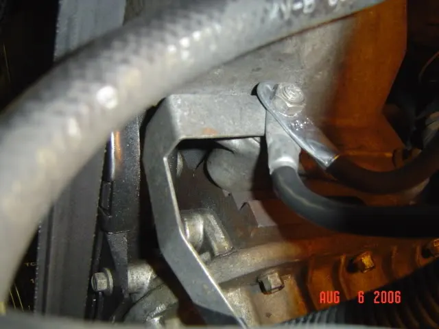

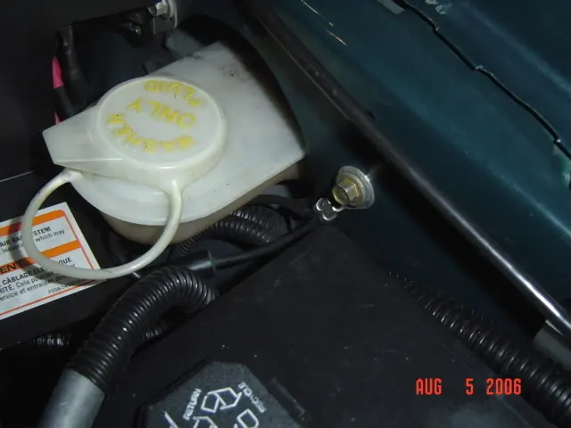

Also.. Glowstang93 mentioned to use an extra ground wire.. I hadnt seen that in any instrustions, but its a good idea.. Where does it connect to on the alternator?

The ground I ran mine from where the negative battery cable connects to the block to the drivers side fender ground , right next to the solenoid and battery. And yes mine is a 2.3, but the principles are still the same, just different routing due to placement of alternator.
