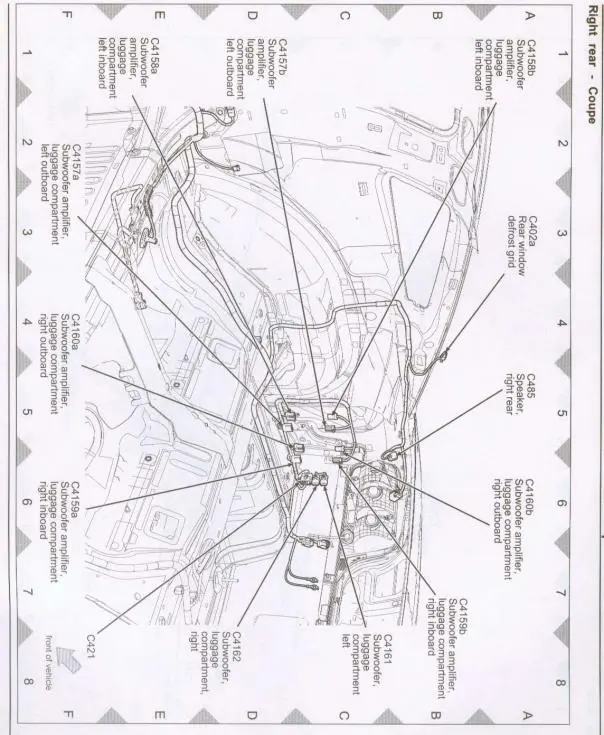

Can anyone tell me if the rear Shaker 500 parcel tray speakers are amplified? If so, where is the external amplifier?
Also any additional knowledge about the splicing of these rear speaker wires for a high level input to my subwoofer amp would be appreciated.
Amps are in the trunk here...
