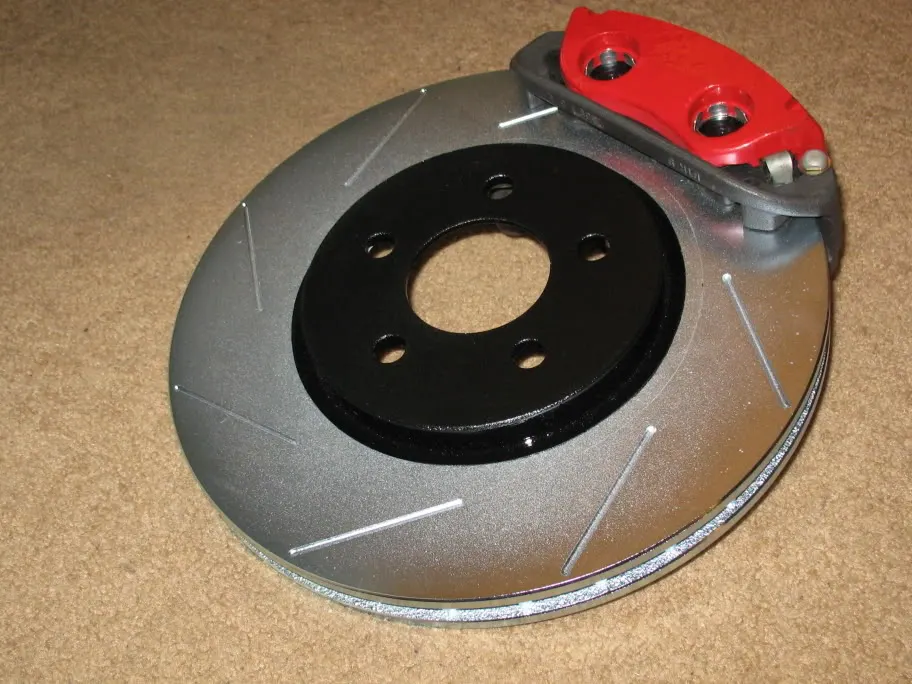

I would suggest buying this kit and painting them, they are the same exact thing just not red:
Buy Ford Racing Parts!

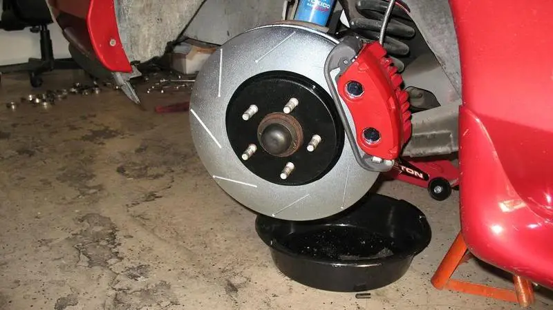

I did the same thing except pieced together the parts with slotted discs and LCR teflon wrapped SS lines for $342 shipped all together.
An no, you don't need to replace anything that doesn't come with the kit.

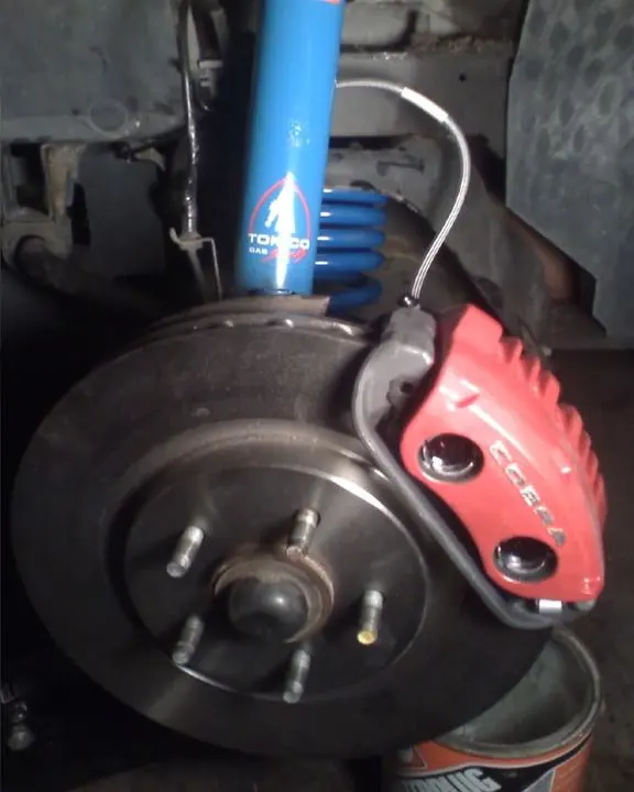

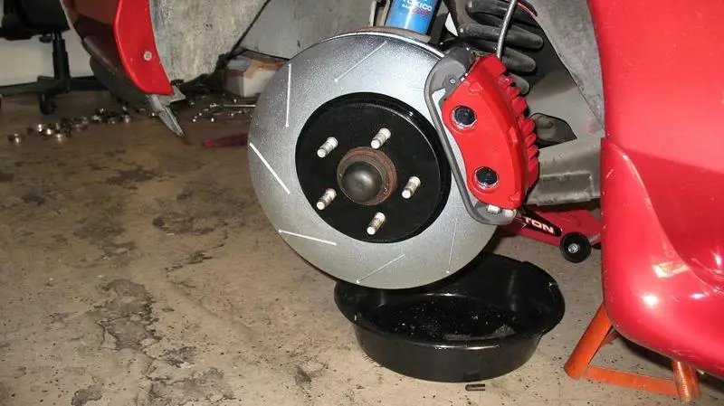

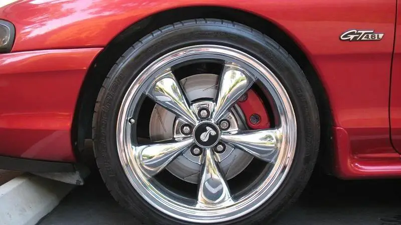

just grab one of the big bottles and that should be good, i just did the same swap CobraRed_96_GT thanks to some suggestions he made i got some rotors from a good company cheap, only i got my calipers used off a cobra and they were red already, really easy sway i think you can use a socket wrench to install it all, i didnt change my master cylinder and it feels and brakes sooooo much better than stock way worth the money

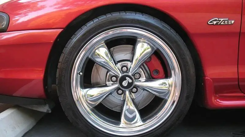

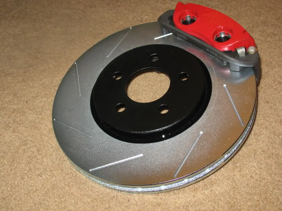

I painted mine red and think they look ok
