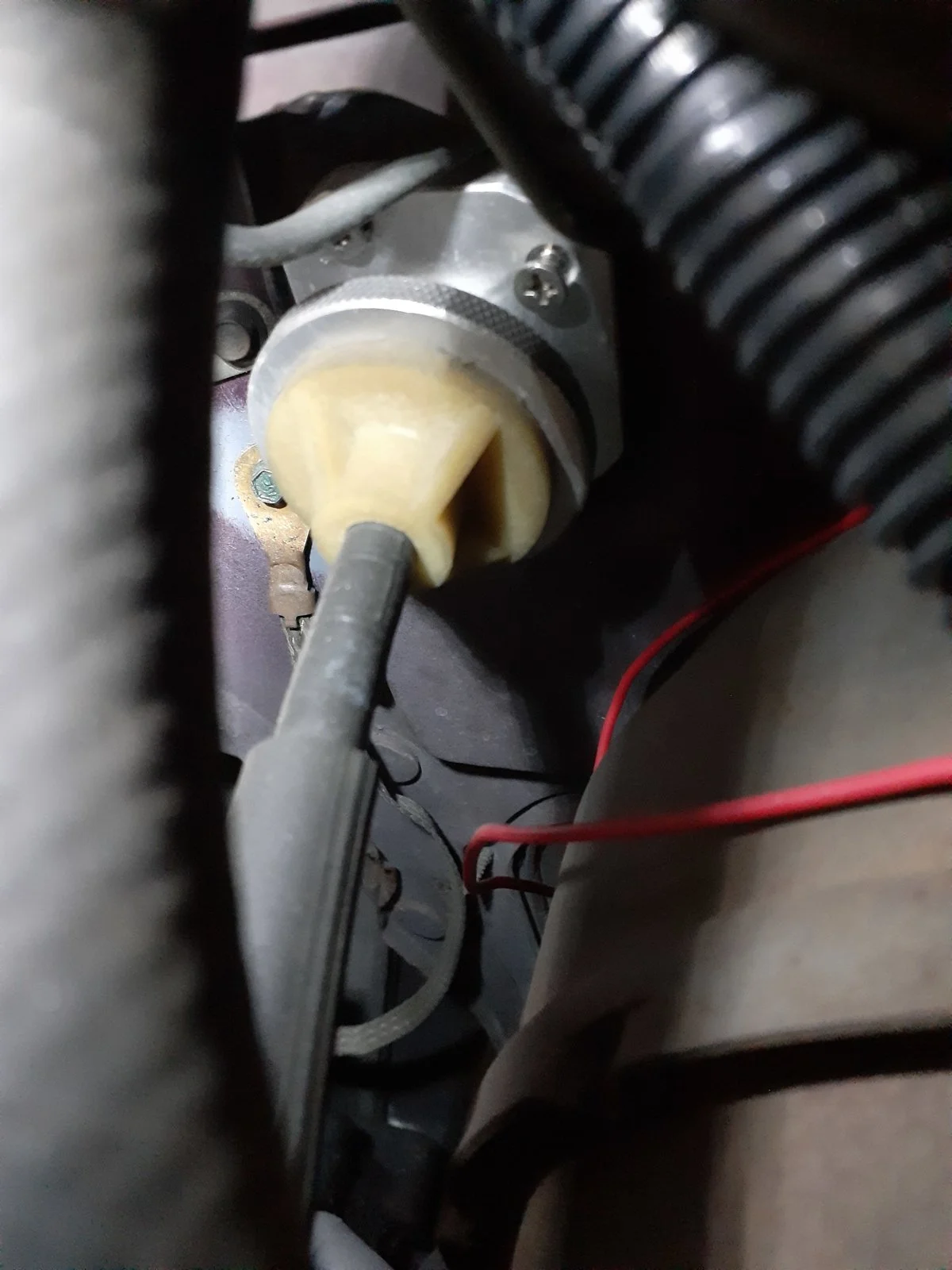

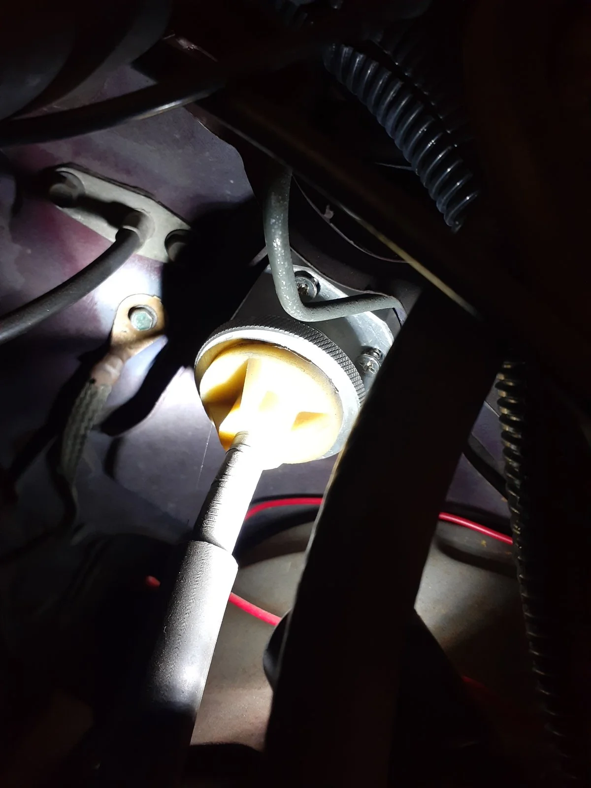

I have to replace my speedo cable and will be replacing the clutch in the spring, so while the seat is out, I figured I'd replace the clutch cable.
Prior, someone installed a Steeda double hook quadrant on my car. Cable appears orginal. It has an unknown firewall adjuster on it. See photo.
What clutch cable should I get? (Steeda adjustable? )Any idea if the firewall adjuster is any good or who made it? (has loose screws I have to address).
Thanks for your help

A firewall adjuster is a firewall adjuster. I've tried quite a few and do not favor any over others, perhaps with the small nuance that some adjusters have slightly better grips that are easier to force around. The fact that yours is already there and free is reason enough not to buy another.
On the cable, Maximum Motorsports is the highest quality cable complete with a dust boot at the clutch end to keep it internally clean. The steeda adjustable is cheaper and equal to it in every other respect that I can feel, except that it has another adjustable end at the clutch fork and no boot. With a firewall adjuster, you don't need that, but it does allow for even more adjustment. And, since it reaches out a little further and you can take off the end, you never have to pull the clutch fork forward to insert it. Also, the steeda, with it's huge adjustability will work with any clutch quadrant, but the non-adjustable MM requires a compatible quadrant.
I have both on my cars and a spare of both in the garage. So, I feel like I can fairly represent both, whereas many out there will say MM is the only way to go, because they do not have experience with the Steeda. One thing I can tell you, though, is that if you go cheap out on a parts store clutch cable, you're going to regret it. They stretch out, making your adjustment setting inconsistent, and they start to fail and bind up making the pedal really tough to push. It can make you hate driving your car.
Anyways, either of those will make you happy. I am not aware of another non-OEM cable that will hold up without stretching or internally binding.

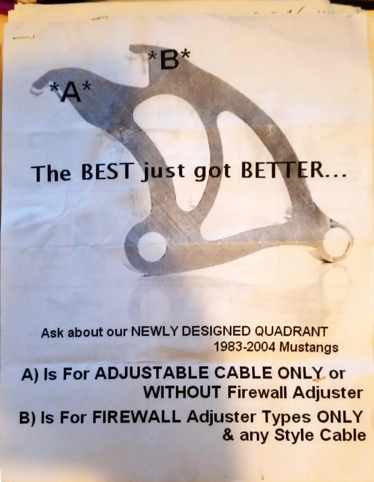

One more point to make... The quadrant you choose can impact your clutch cable decision. A single hook quadrant may not be designed to accommodate both types (adjustable & non-adjustable) of cable. Take a look at the attached picture I took of the page that came with the quadrant I most recently bought from Promotion Powertrain. I think you said you have the steeda quadrant, which if memory serves is a double hook. So, I believe you'll be ok with either type of cable. Just wanted you to be aware in case you run into an issue.
More on quadrants:
Some, like the old UPR Triple Hook, have a reduced radius, which makes the clutch pedal easier to press, but it also reduces the total amount of cable that it can take up if the pedal is positioned the same way. Others retain the stock radius. When I switched to a twin-disc clutch, I was having disengagement issues and switched back to a stock radius to make sure that wasn't my issue. It wasn't, but since twin discs have a soft pedal anyways, I was happy with the stock radius quadrant pictured below.

Yes, I have the steeda double hook quadrant. If the firewall Adjuster I have is ok, then I'll keep that and just buy the steeda cable. That's the way I was thinking.
I believe with the steeda cable you have to use the "longer" hook on the quadrant.... correct? (The one that is farthest from the firewall)

Yep, that seems right to me, from the diagram. I guess, based on the picture I embedded, it will be optimal to put it on the farthest hook, but it's not a "must". The steeda will work on either hook. When you get under the car and see how much adjustment you have on the clutch fork side, you'll see what I mean. The game now is functionality & then preference. If it works and you like it more on the 2nd hook, then do it. Just make sure it fully disengages when pressed and that the preload is ~5lbs or less when the pedal is up.
