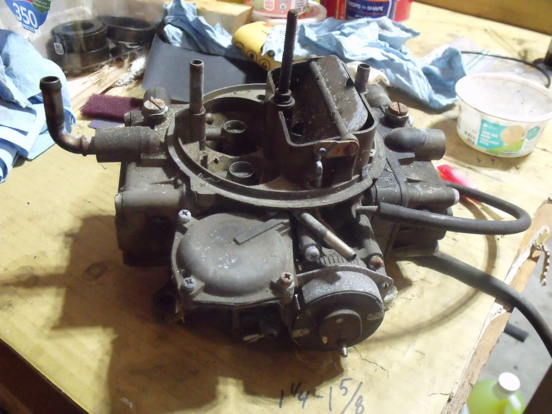

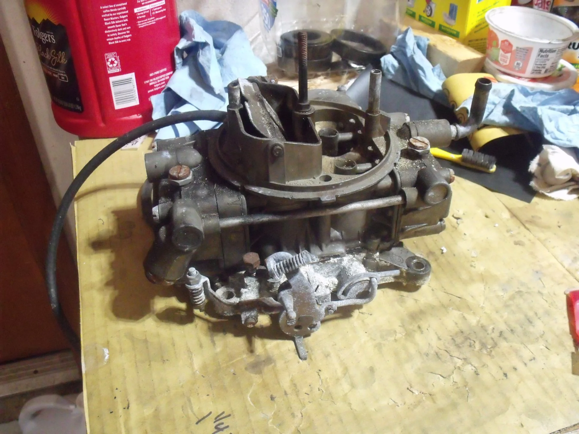

I have a very original 1984 Mustang with 85k miles.
When I got this car, it had its original Holley 4180C carburetor. The car was hard to start. Had to pump the accelerator about 20 times if the car sat for a few days.
I had the 4180C overhauled but the hard starting was still there. The shop that did the overhaul of the carburetor finally determined that the metering block had a leak.
My car ran just fine after the 4180C overhaul, but I did not like having to pump the accelerator ten or twelve times to start my car after it had been sitting.
I finally decided to replace the carburetor in my car with a new Holley 4160. My Mustang now starts instantly regardless of how long it sits.
Questions:
1. What is the value of my original Holley 4180C?
2. Is there a plus to keep the original Holley 4180C so that it can stay with my Mustang when the day comes that I sell my Mustang?
Attached are some pictures of the 4180C carburetor.
Yes, I'd keep it. Any original hard parts should be bagged and stashed for future sale/resto.
Sounds like the original carb has a accelerator pump issue.
Thanks for your thoughts. Because my car is so original, I suspect that it will some day go to a serious Fox notchback collector, so I had been sort of inclined to keep its original carburetor with the car.

I had the original carb on my 67 Dodge and finally gave up and installed a new one... NIght and day difference... Like the General said, keep the new one with any other original parts you take off of it.....
I have one of those carbs off of my 83... On the shelf it went...
There is some value to the original carb. I have a couple on the shelf that I have picked up for about $100 each when I was planning on a V8 swap into another car.
The higher value would be to keep the original parts and have them stay with such a car for the future.

Thanks. Keeping the original 4180C Carb with my Mustang is probably the right answer.
My car ran OK with the 4180C but it runs even better with the new 4160. And my car now starts instantly even if it sits for a week.
