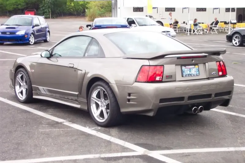

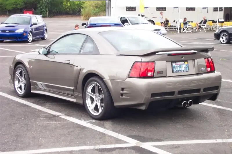

As someone who has owned both, I like Chicane's exhaust MUCH, MUCH better! I've contemplated purchasing Chicane's and swapping...that's how much better I like them.
My '01 (old car)...
My '04 (current car)...
