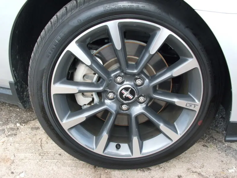

Az Pete said:
Not an issue running different sizes front and back, I will next tire purchase. Just won't be able to rotate. As for the clearance, not sure there.
i like your wheels! i think its the premium wheels package for 2010+ right?

Az Pete
Mar 30, 2005
711
18
49
Panama City, Fl.
Oct 24, 2011
  • Oct 24, 2011
My wheels are the stock GT/CS package wheels. The background is dark gray and "GT" is cut into one spoke.
i love the wheels ! imma try and find me a set of those!
