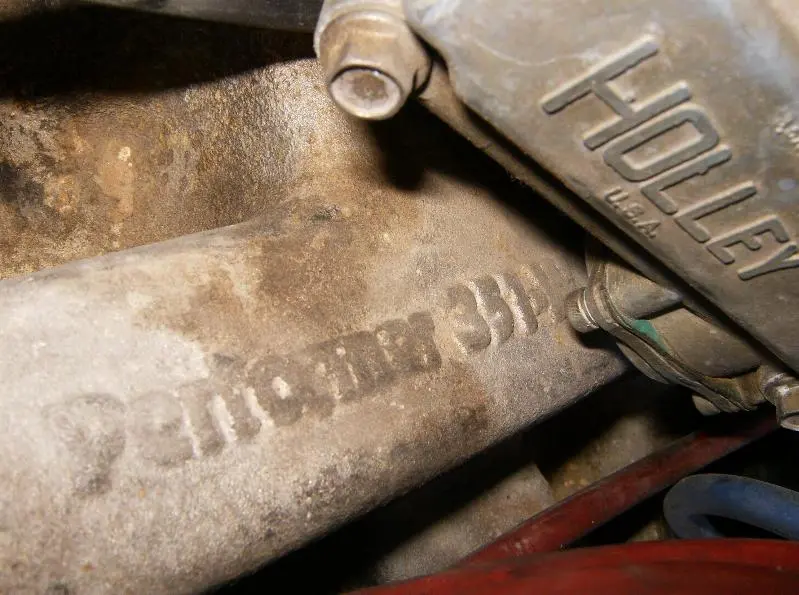

I have a Performer 351-W intake on my engine. It was on there when I bought the car. Is there a way to tell how old it is? Or were they made for year after year with no discernable difference between them? I can take more pics if it will help.
Would its age affect its performance ? If so,what can be done to make it perform better.
Also,for the carburettor (Holley 4V),how can I tell which one it is,like 600,650cfm etc?
There are some numbers on it,but I don't think it says that info.

The Performer never changed much.
Doesn't matter the year of mfg...
The Holley model can be determined by the "list" number on the choke horn.
Should say something like "List- 3310-3" or similar.
That would be the number needed to figure exact model.

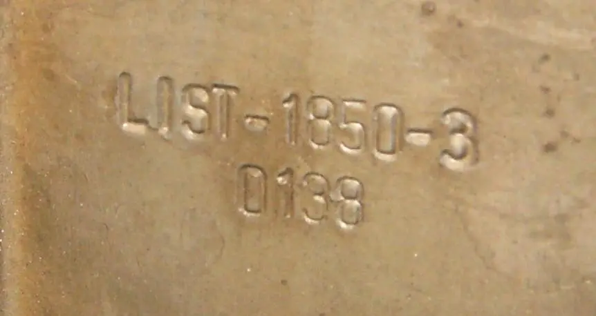

below is a pic of the list number on the carb.From a quick Google search it says its a 600cfm.
Yep.
600 vacuum secondary, single inlet...
Very basic carb. Not my personal fav, but it's reliable.
The "-3" after the list number means that it is the 3rd generation, or evolution of that model. The 1850 is up to something like -8 nowadays, so that would be a pretty old carb. Probably lacks PV protection, umbrella valve in the accel circuit, and some other minor updates.
The PV protection is the critical one.
If your PV is blown, it will drive you up a wall.
If you don't know to look for it, you can chase your tail trying to figure it out.
That would cause the car to run poorly AND seriously fail a sniffer test.
