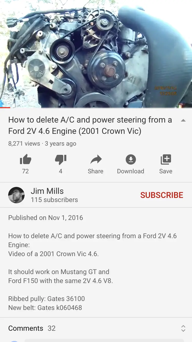

Awesome that’s good to know. I only drive the cars on the weekends so it’s not often and all my driving is on the highway. As far as deleting the pulley do you recommend a electric water pump or just a shorter belt ? I have a picture I found but I wasn’t sure if it would actually work when under load
