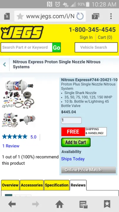

Here is a picture of the exact kit i will be using, plus a window switch

On a stock ECU/no Wideband (at the moment, that may change) what would be your personal method of tuning for best results without blowing this thing up?
I will be more than likely driving this car on a daily basis, so I would like to stay as safe as possible while achieving optimal results. Staying with a smaller shot would be fine with me if that is what i have to do...
At this level, there really isn't any tuning required. Go with the recommended jet size for the size of the nitrous hit and go to town. The system will have one jet size for fuel and another for nitrous that will come in various sizes depending on how big the shot is.
