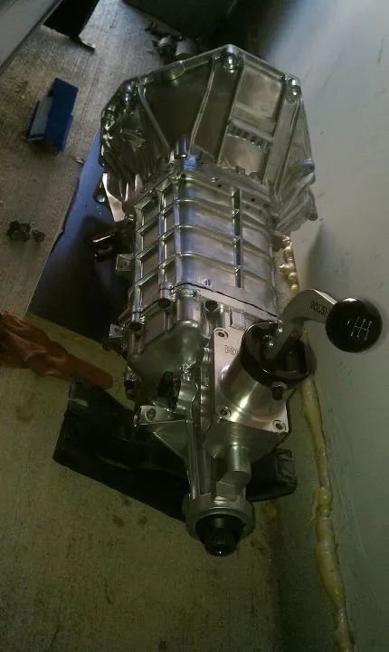

Your right bro. The Cobra uses the T56. But if I'm not mistaken its still the 11" flywheel used? Just an 8-bolt instead of 6-bolts on the GT's.
That's the 3650 trans. With the Roush Roadrace shifter. And I had the case hightemp Chrome painted?
Now I know what some will say its a transmission? It's up under the car? Who's goin to see it? An your right? Who will. I just had the time while it was apart to sand the case down an prep it good an shoot it with the paint? Thought what the hell.
