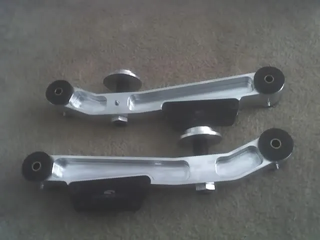

1 more question.
Looking at a picture of the LCAs, how can i adjust them with the allen on the bottom?
I mean, it's got a loaded spring sitting on top of it, how will it defeat all that force?
http://www.stangsuspension.com/store/comersus_viewitem.asp?idproduct=1372
Its actually not an allen head, its a half inch drive (you can use a half inch socket wrench drive).
The spring perch itself rotates, and the spring perch is greased, so it does allow you to raise/lower the perch pretty easily... but you really have to jack up the rear end to make it easy. Its not good to put stress on the adjusting perch, threads, etc.
ALSO, click the second thumbnail on your link, then hover your mouse over the picture, you'll see a nice blown up version of the threads and perch, etc.
