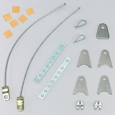

When you pull a wheelie, the travel limiters limit the amount that the front wheels will extend down. It sorta keeps the car from trying to "roll over backwards" and when it comes to the top of the travel, sorta plants the rear tires as it has stopped the transfer of weight. It's a tuning agent really, and an inexpensive one at that, sorta like clamping your leafs.

Okay, lets see if this works. One end is attached to the chassis, the other, to a control arm. I think you can see how you could easily make a set. These are competition engineering's and run about $53 from Jeg's or Summit.
These are Art Morrison's and run about $45.
catalogs
