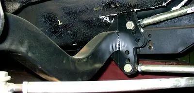

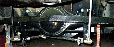

Everything in my rear suspension is stock. The quads are gone and I have adjustable shocks. Stock control arms, no torque box reinforcements, no c-clip elims, stock posi. In my search for a cost effective rear setup, my friend was telling me about this 4 link he had been putting in. I think that I am going to do it. The brackets and links are 189 from chassiworks heim joints are 155 from jegs. Plus shocks and springs. You also need to buy a 3x2 crossmember.
I have been talking to a lot of stangers about a lot of possibilities. By the time I buy battle boxes (just an easy name), control arms and springs, this makes a lot of sense financially.
This is on a dodge duster, it would be installed between the frame rails on a stang.

looks like it would be a good setup. are you looking for a lot of adjustability or just a good solid rear suspension? you might think about getting some ladder bars if your not concerned with tuning to much, but even then, there are adjustable ladder bars. Moroso/competition engineering might offer some for a mustang. i just looked in the catalog but there was no listing, there number is 203-453-5200 if you wanted to check it out. i just ordered some ladder bars/springs from them (well through a local place, but it is moroso's product) and will be putting them in soon if all goes well. i was going to go with chassisworks until i called them and talked to some guy who was just no help at all. his customer service skills blew. so i said screw it, im not messing with them.......ok now i have written to much. hope this helped
The ability to tune does not hurt any, but mainly I want a good solid rear setup. I still have some parts tallying to do, but I think this will come out cheaper or the same price as fixing my rear suspension up to make it safe. I am at a low power level, but the stock stuff wont hold up forever.
