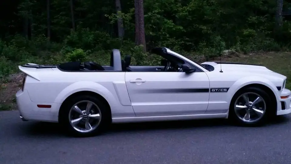

So I'm guessing a bar like this won't cut it?

You might want to consult the scca rules for a definitive answer, but without a lateral support holding the hoop in place the hoop by itself is worthless. Rather than powder coat, since its hard tonweld when coated , any competent painter can match your car color exactly. My roll cage is painted to match the car and the paint has held up well

That was the first thing I asked when on the phone with the track manager. Unfortunately the styling bars offer no structural support and wouldn't pass inspection.
