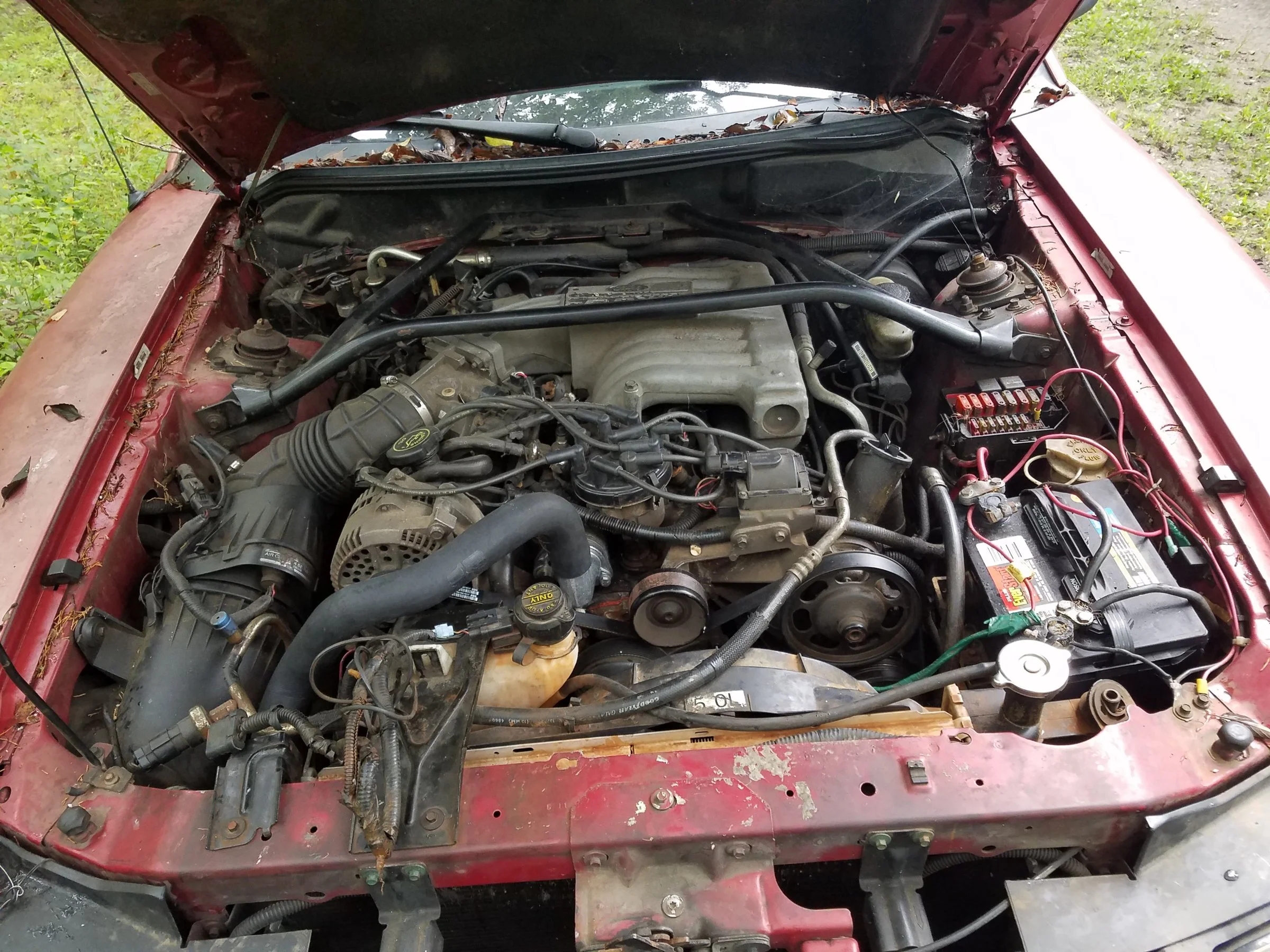

I bought a 95 gts to fix up and is currently a mess. The fan works when connected directly to the battery but I don't think it's turning on when it gets up to temp. On the dash the temp gauge looks higher then it is and rev gauge doesn't work at all. The guy I bought the car from was trying to fix it when he gave up and sold it. The wiring in the engine looks bad and probably needs to be redone. I don't know a lot about cars and any advise is appreciated.
Can we have some wide angle pictures of the general cluster:leghump: we are dealing with here? These cars are old, and we actually deal with quite a bit of old hack jobs on this forum.

Doesn't look terrible

Run the KOEO self-test which will run the fans (installing the proper scanner with the key on, engine off will cause that test to begin). This ensures most of the circuitry is working (including the CCRM), if not you can troubleshoot from there. This eliminates the temperature sensor and its wiring from the equation.
