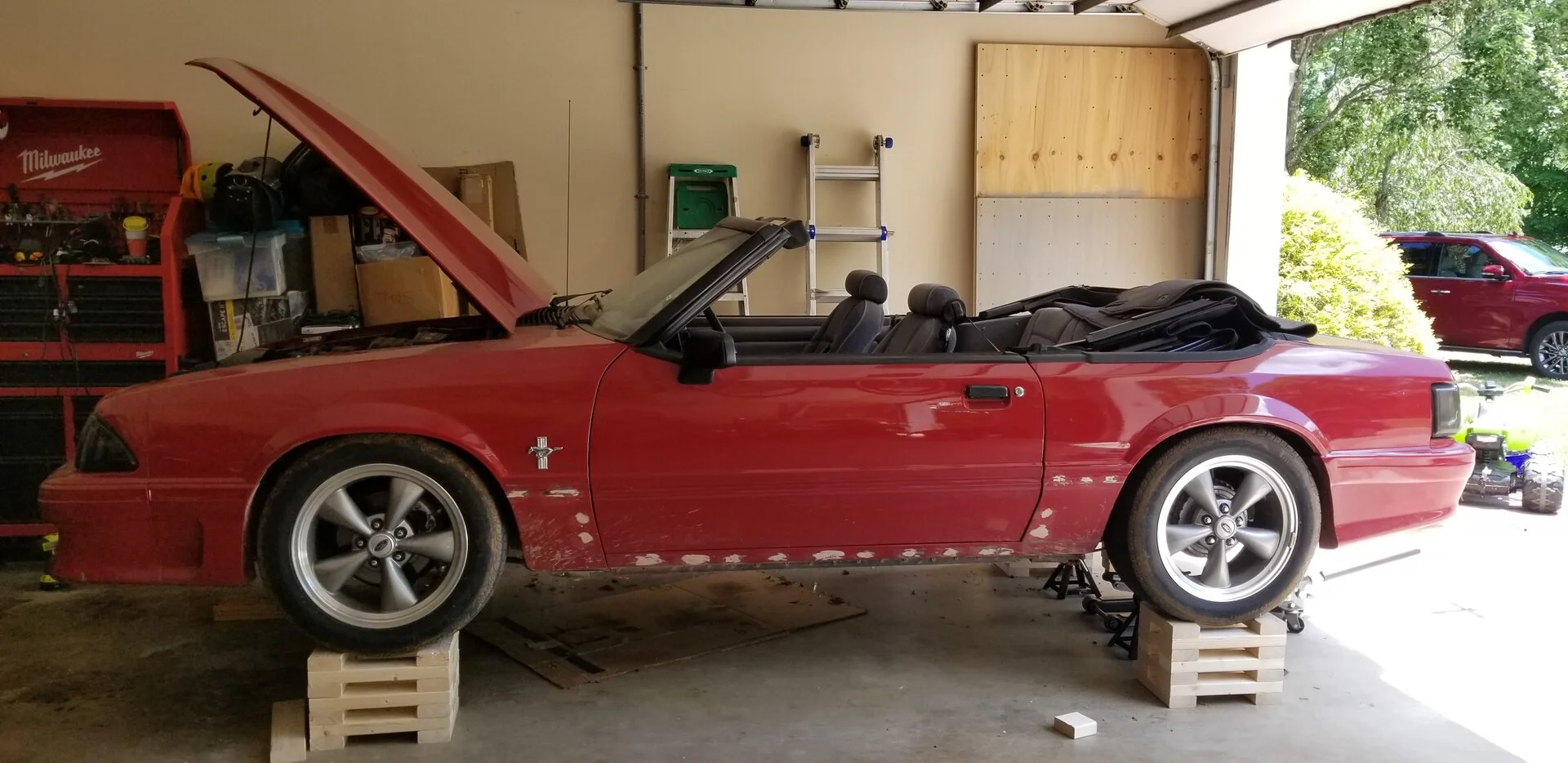

I recall seeing a thread or post here of someone who built some wooden blocks to raise the Fox - they raised it pretty high - like 18+ inches.
They built blocks out of wood, but it wasn't just stacking up 2x6's or 2x8s to make a solid mass of wood. - I think they used 2x4s on their sides in a sort of crossing pattern that locked the wheels in place.
Does anyone happen to have that bookmarked? Or have other ideas? I can build some ramps out of 2x8s of course, though that would be pretty high. I figure I need the car 7-10 inches off the ground.

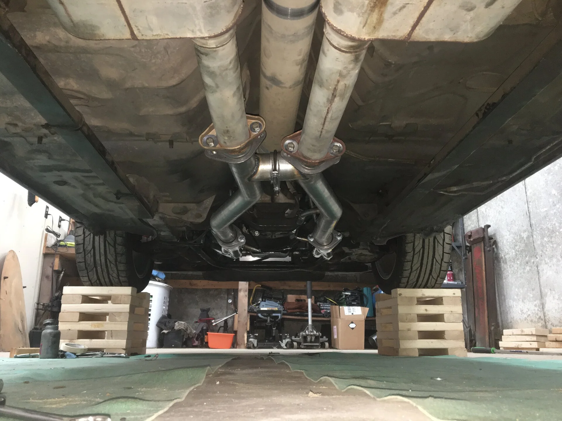

I have a set. This is about as high as I can go with my jack. I believe they’re 12” 2x4 sections.
I’ve always thought about building these. How secure are they compared to jack stands, in your opinion? I could definitely use a little more room to work under there.
IMO, they're more stable and safe then jack stands. The only downfall is you can't perform suspension/brake/wheel work, obviously. Jack stands still have their place. I use both now.

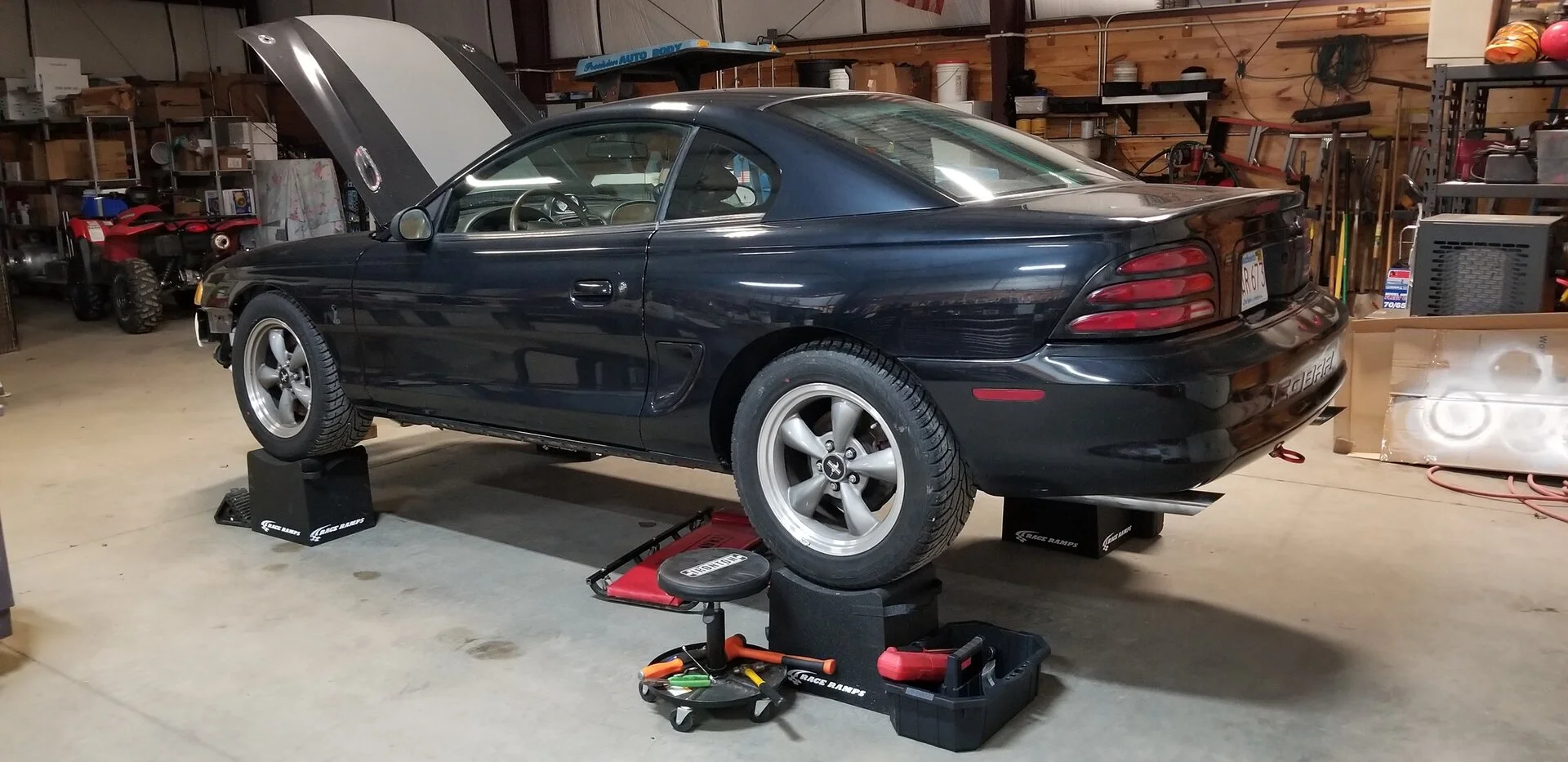

Cribbing with the 2x4's looks ok I guess, ramps though, nope. I've personally seen three sets fail, two metal (both folded the f*** over) & one composite. I'm sure it's happened, but a jack stand failing seems a lot less likely. Again, spend the extra dough for the six ton ones. Those foam blocks are interesting, hadn't came across them before.
It's up. I only made 10.5 inches tall, and don't feel like I need more. I did have to buy another pair of jack stands (I've only ever had 2).
Convertibles are a little more sketchy to get up because they have an XBrace that connects to the K-Member with some bolts that aren't flush. For the block of wood I created to put on top of the jack, I had to drill to holes with a paddle bit to let it sit flush onto the X-brace.

Its great to have the car this high and it be secure.
