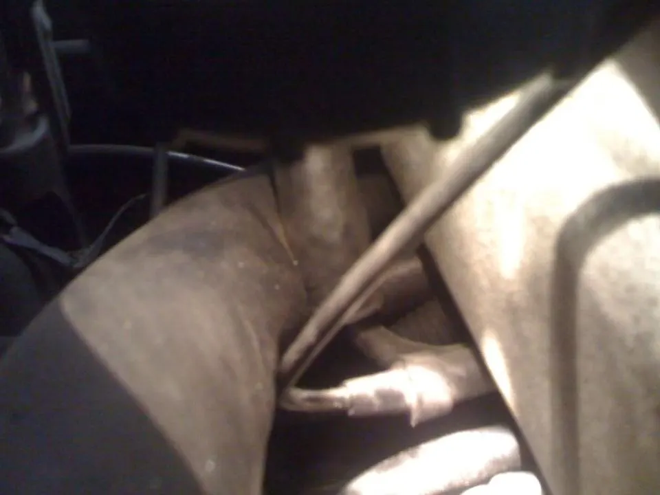

I've tried with the engine running and get nothing. I've also noticed that the vapor line that runs along the pass. fender isn't connected on the front end to anything.
Charcoal Canister Vapor Line

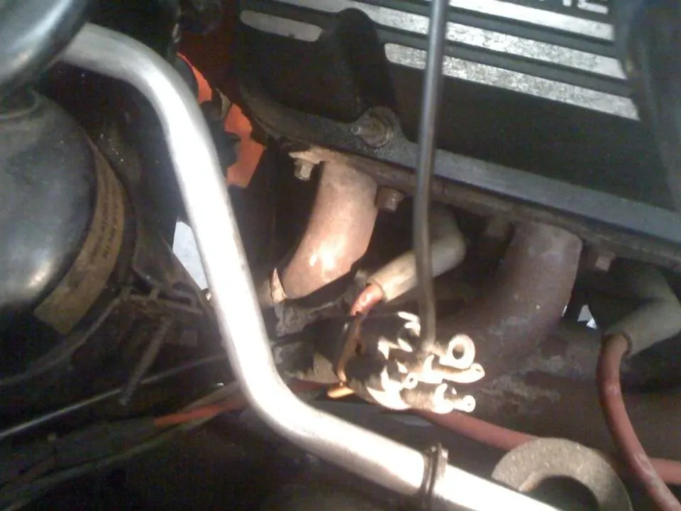

Where EGR Valve Vac Line Runs To.

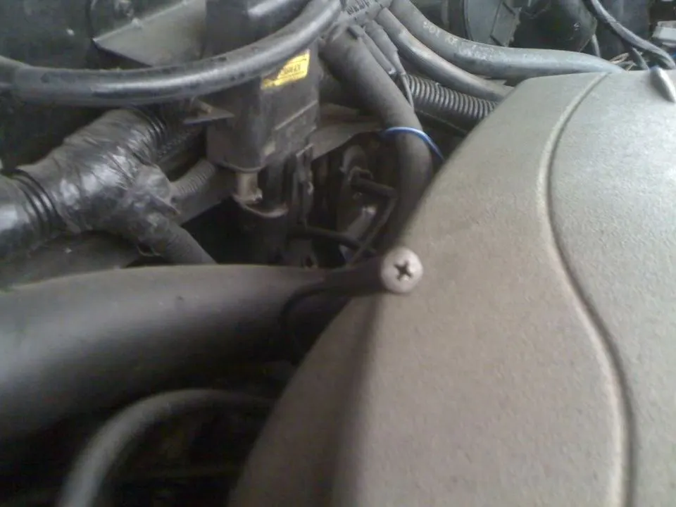

Manifold Vac Line with Screw in it.

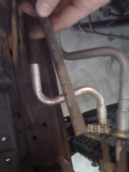

Where Manifold Vac Line Runs from (Behind Intake Manifold)
