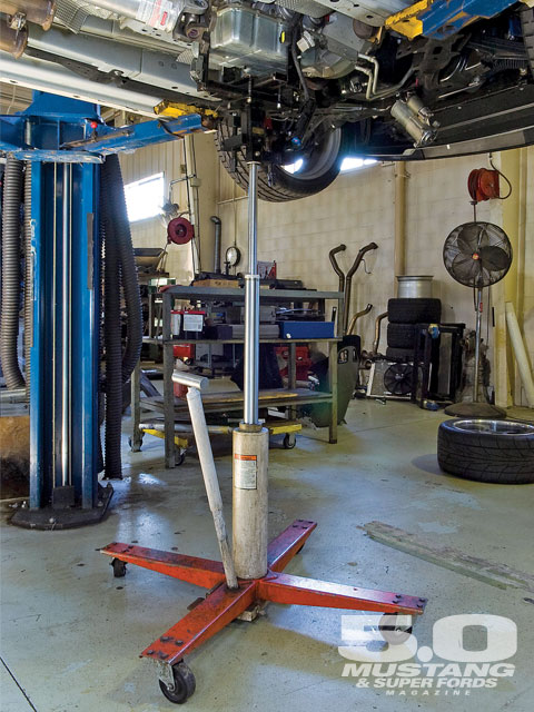

Removing the transmission is about the same as it is for any other RWD car. You'll want either a low-rise transmission jack or a sturdy board and good floor jack to support that transmission coming out and going in. As far as the wiring repair, match the gauges, solder the wires well, and try to keep the lengths the same, heat shrink tubing is your friend.

That's on a V8, but your 4.0 is similar.
Drop the pan and drain and fill the fluid and filter while you're at it if you're worried about it.
I'd honestly recommend buying a Haynes or Chiltons manual from your local parts store if you're unsure of any of it. I work on cars for a living, but the last time I worked on 5R55s transmission was two years ago, and that was in an Explorer. The last time I had one all of the way out was in a 2005 4.0L Mustang back in 2014. To me there was nothing difficult about it, but I work on stuff every day that would turn some of the savy guys on this site cross-eyed.
