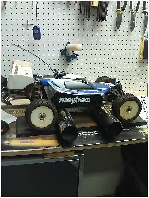

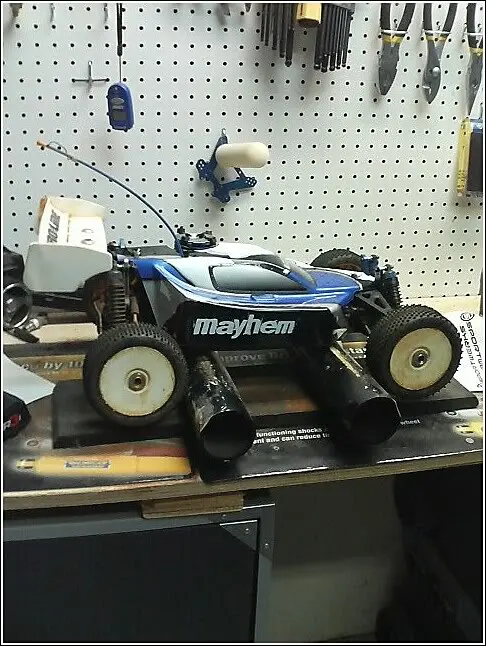

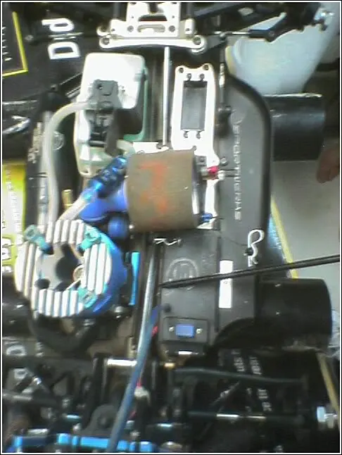

Not very easy to land. My neighbor bought one for his son and it was trashed a few hours later. He practiced touch and goes for awhile before taking it for a spin. It didn't last long. We run buggy's and stadium trucks at the local track. Much better then the air stuff.

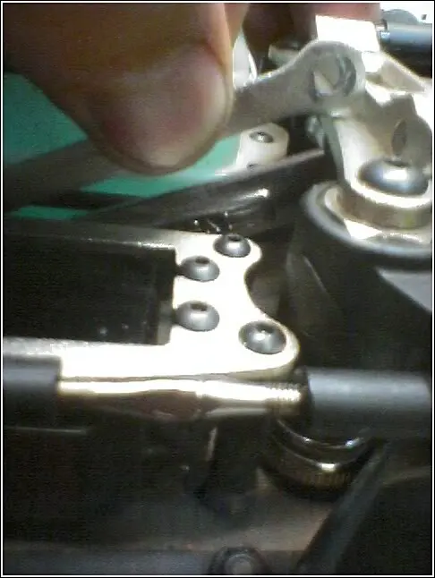

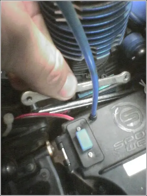

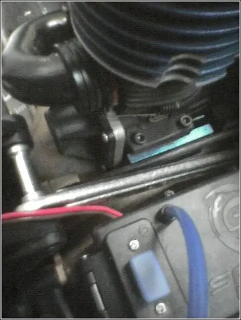

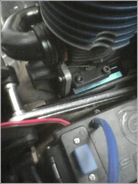

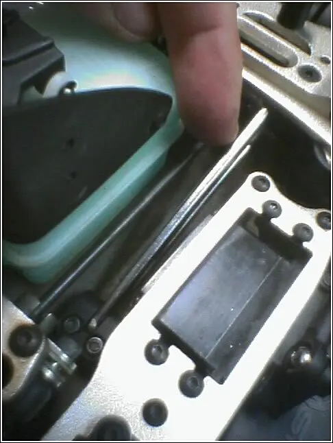

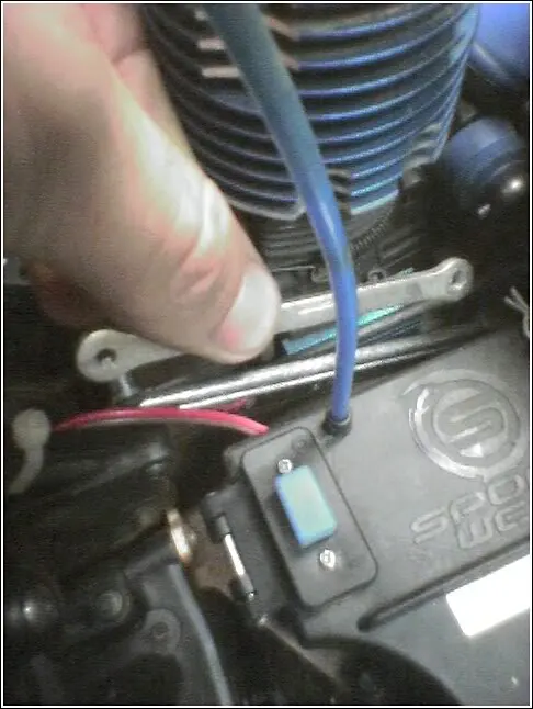

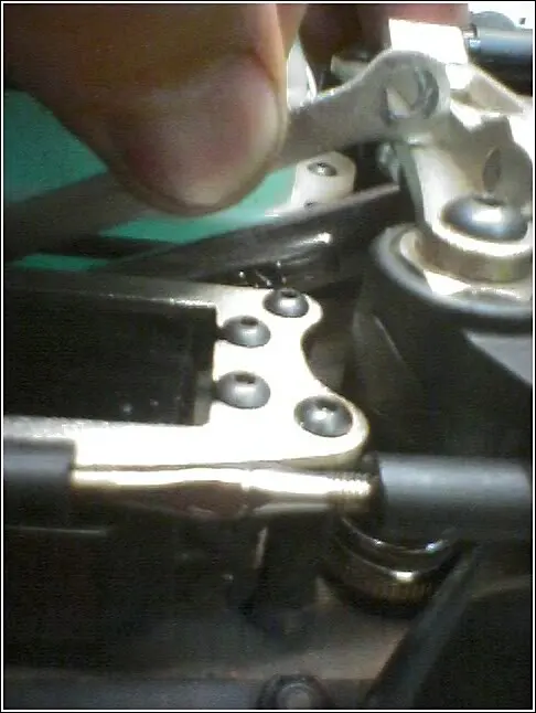

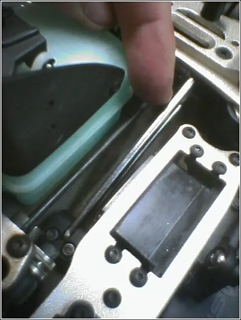

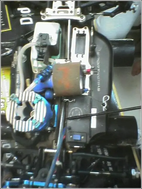

Let me show you one of my inventions. The Mayhem I posted above kept bending the aluminum subframes that run through the car (front and year) on jumps. There also a pain to change.
After fixing this twice I came up with this- Two Craftsman 3/8 wrenches. I traced the stock aluminum one over the wrench with a sharpie. Drilled the holes and grinded it down to fit. Never had a problem again.

Joe, I'm kinda confused on what you did. Did you actually use the wrenches? Or just use them for templates?
