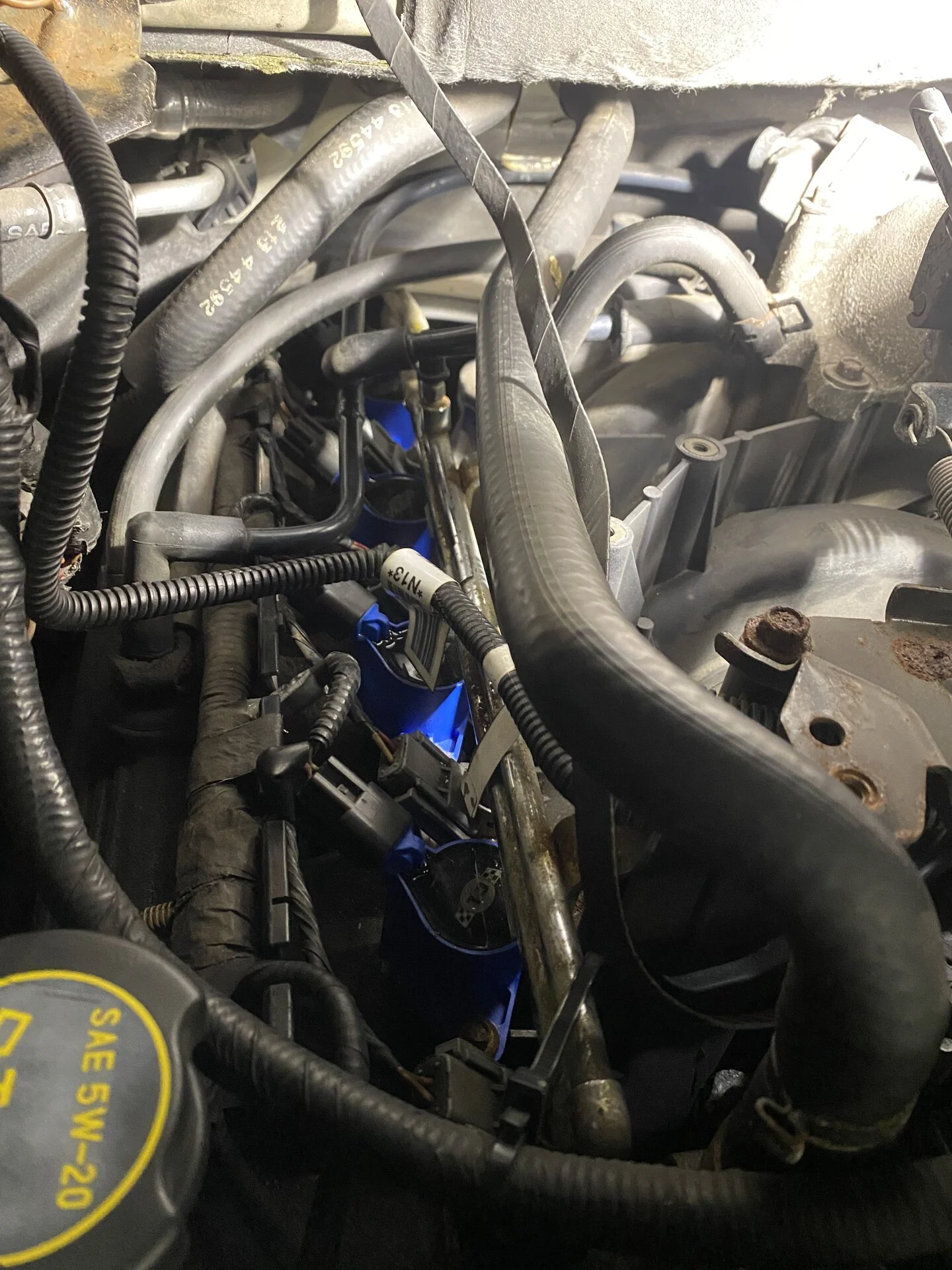

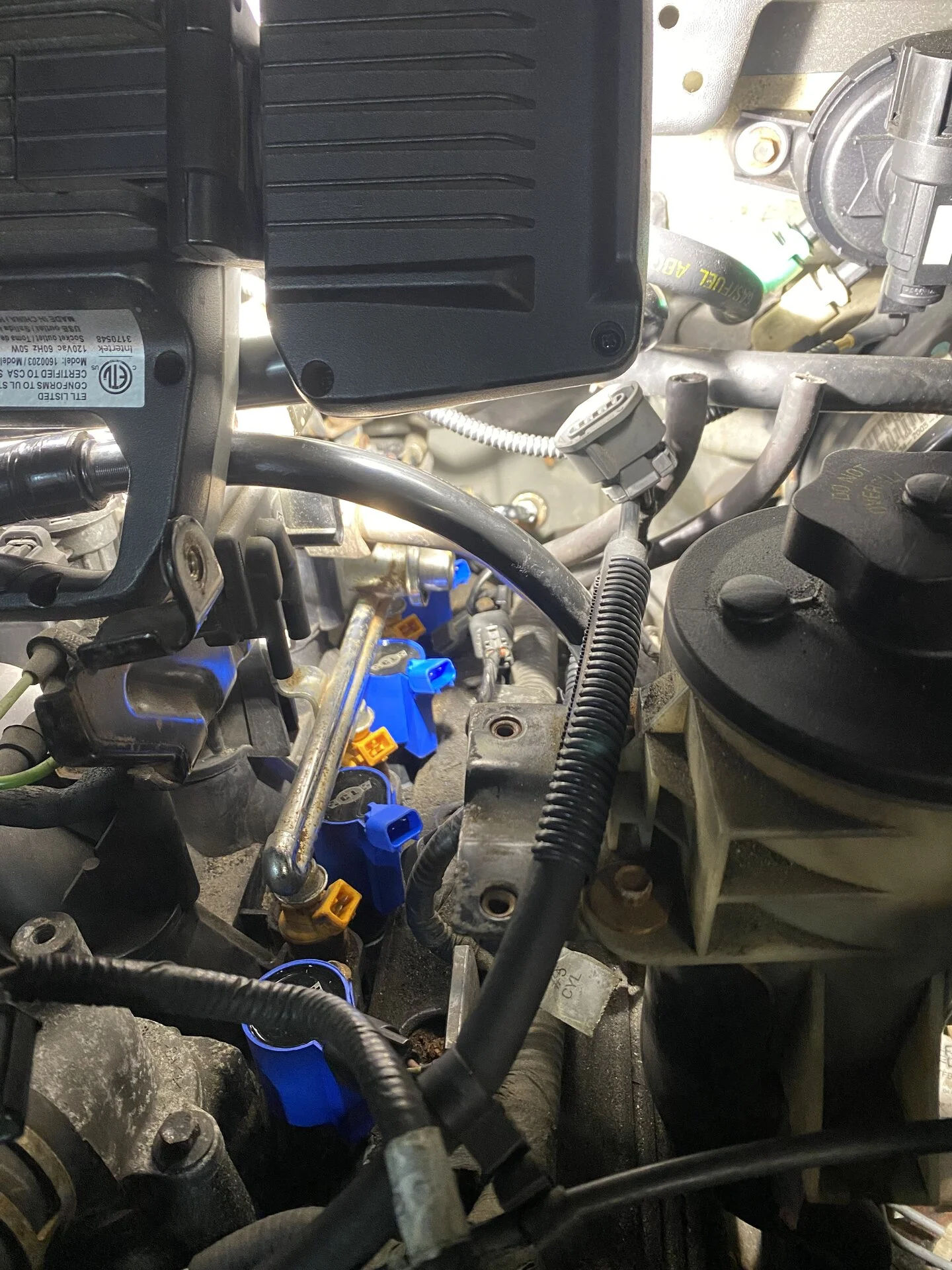

I decided I wanted to replace all 8 coil packs. Over the years, a few have been changed, but since I recently changed all the plugs, I figured….. let’s finish the tune up. Not wanting to spring for $60 a coil pack on Motorcraft, I turned to American Muscle/ American Trucks website. I read a bunch of reviews and finally settle on the C&L Blue Lightning packs for about $150 for all 8. I figure it’s gotta be better than the 5 originals, and the three that were replaced years ago.
So far, I am very happy! Truck is smooth as silk again and running great. The boots were about 1/4” longer than the stockers, so I did have to trim them a bit, but no big deal.
