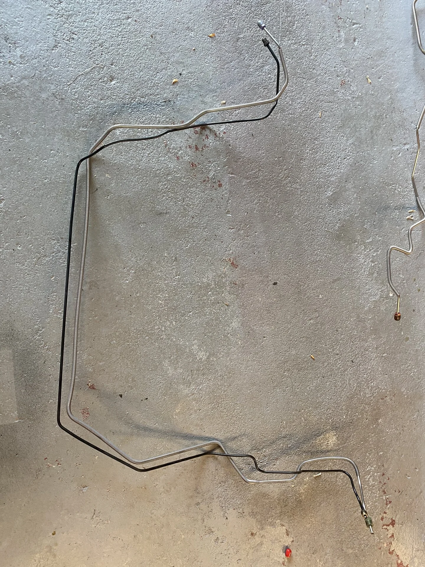

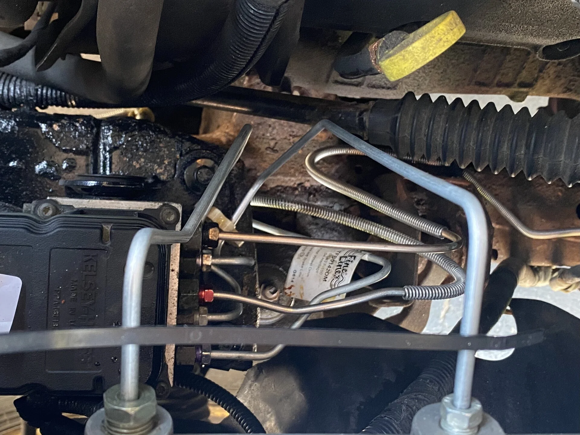

Got the rear axle hard and soft lines done tonight. They all fit fine.

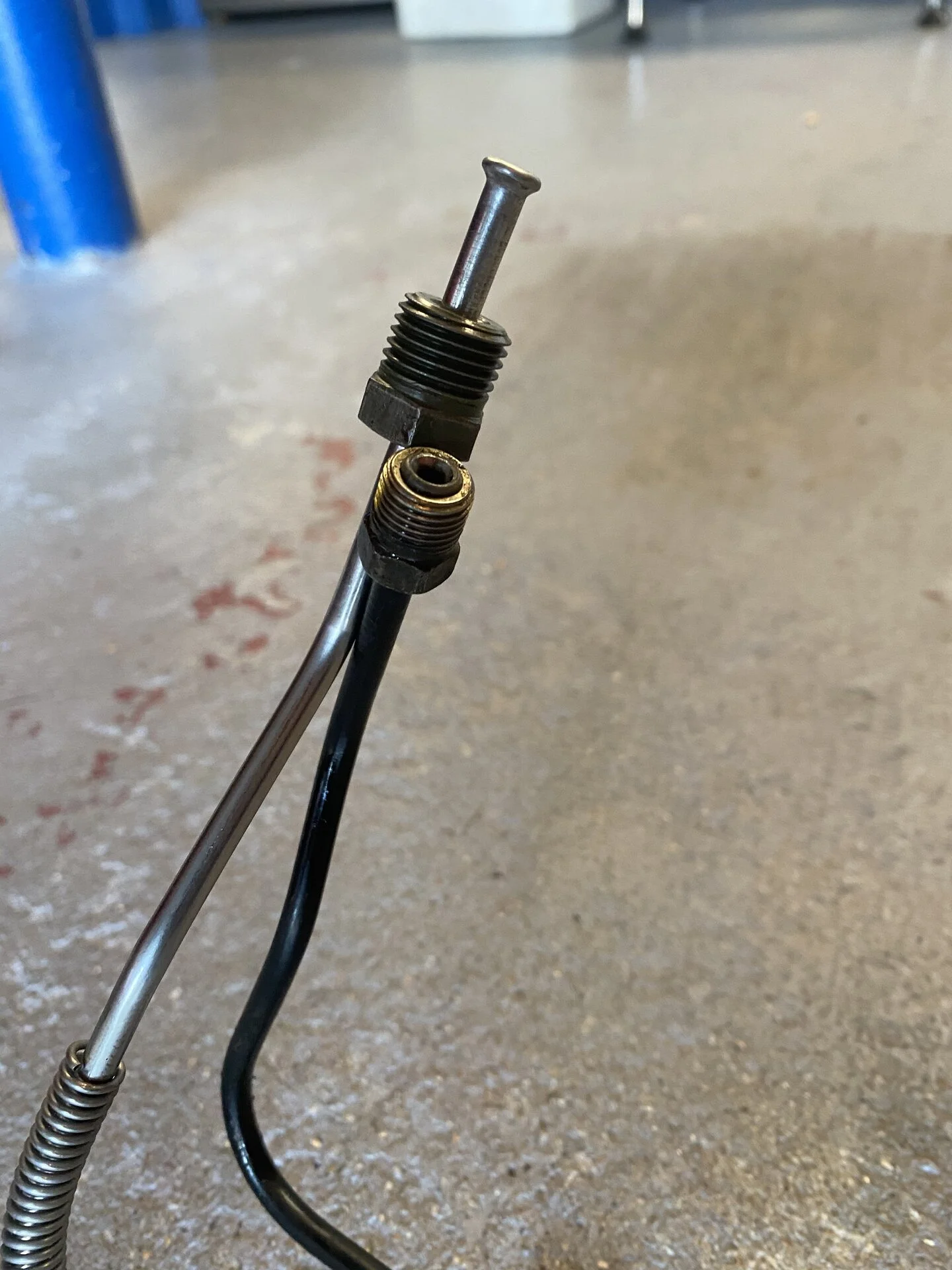

I did find my line from ABS module to pass. front has a wrong fitting also.
All I can hope is that they take care of this properly, in the eyes of customer service.
I’m getting close with this. Need to hook up the driver side front line, and the line going to the rear.
I’m installing a new Motorcraft MC as well, so I’ll need to bench bleed that, bolt it in, get the system bled, and see where I’m at.
Hopefully my used ABS module works, as they assured me it would. We’ll see!
More of what I’ve learned from this experience——— buy brake lines from SStubes, also known as Fine Lines.
Do not buy brake lines from InLine Tube. They corrected their issues, but I have not had a wrong line yet from SSTubes, and SStube lines seem nicer as far as the flow of their bends.
Good day today. Got the last of the brake lines in, master cylinder back in, and all lines free of leaks (I think).
It was a typical hazy, hot, and humid day, so bleeding the brakes gave way to floating in the pool to cool off. Friday I’ll deal with that, and hopefully have this truck up and running again!
So I borrowed this brake bleeder from a buddy of mine.
Bled out the ABS module, and all the lines, and we are back in business! No leaks, pedal feel is good, and no more slowly sinking to the floor!! I guess the used module they sold me was in fact a good one!!

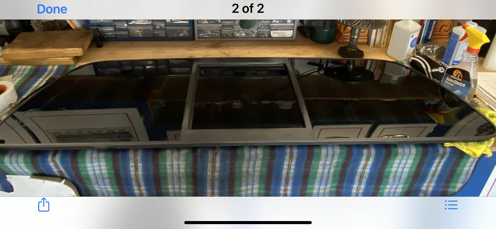

I finally took on that rear window. Was nowhere near as bad as I thought it would be. Only bad thing about the project is that I only took one pic!
Now to let it dry, wait til it rains, and hope I fixed the leak.

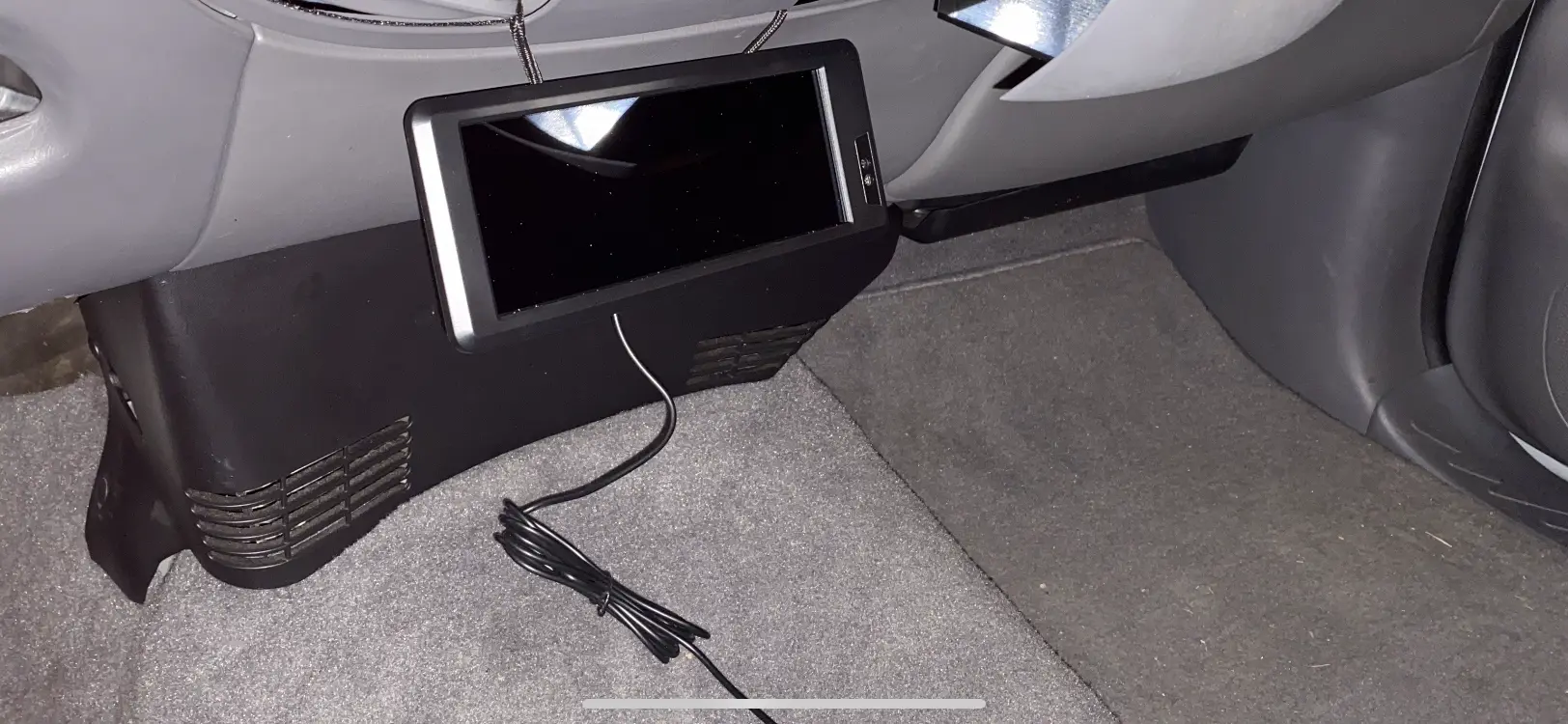

Bought a Type S back up camera for what is now my daughter’s truck.
Installed it today, and it seems like it’ll do the job. The camera is solar powered, so we’ll see how that works out. Worse case is I remove the camera, charge it on the USB. It doesn’t stay on long, so I’m hoping the battery lasts a while, especially the way the rain and clouds have been lately.
I also plan to get a female 12v socket, wire it into a power with key on fuse. Hopefully one of the several spares will do it, and they’re not all constant 12v.

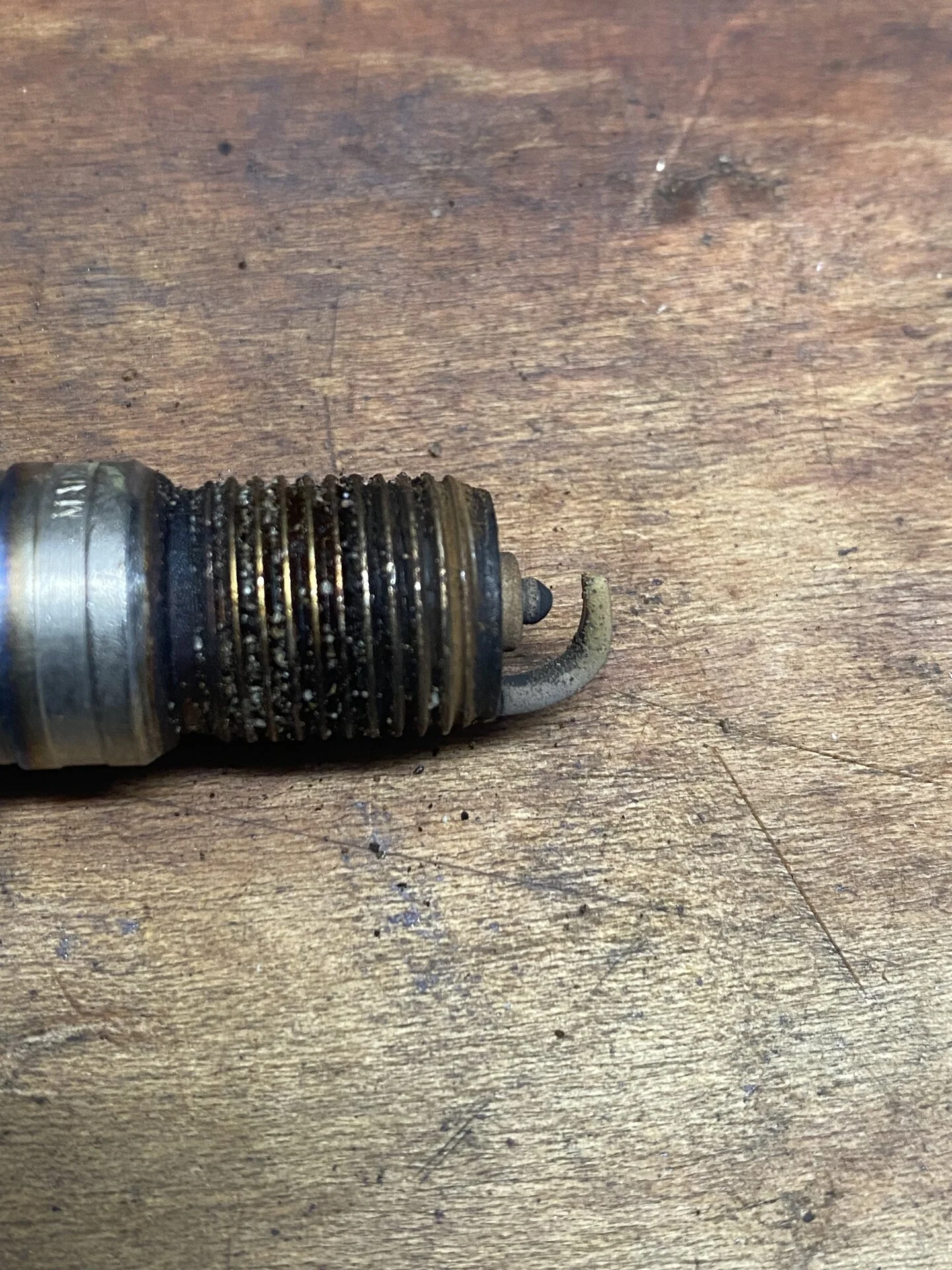

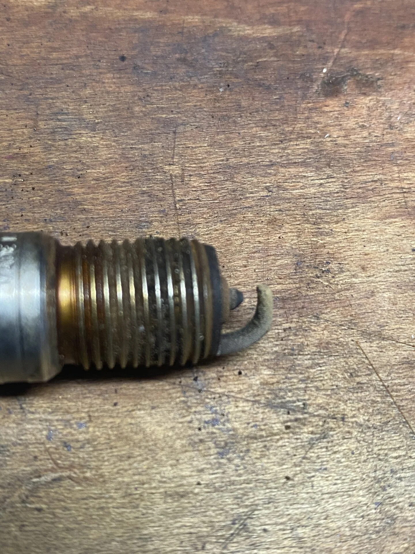

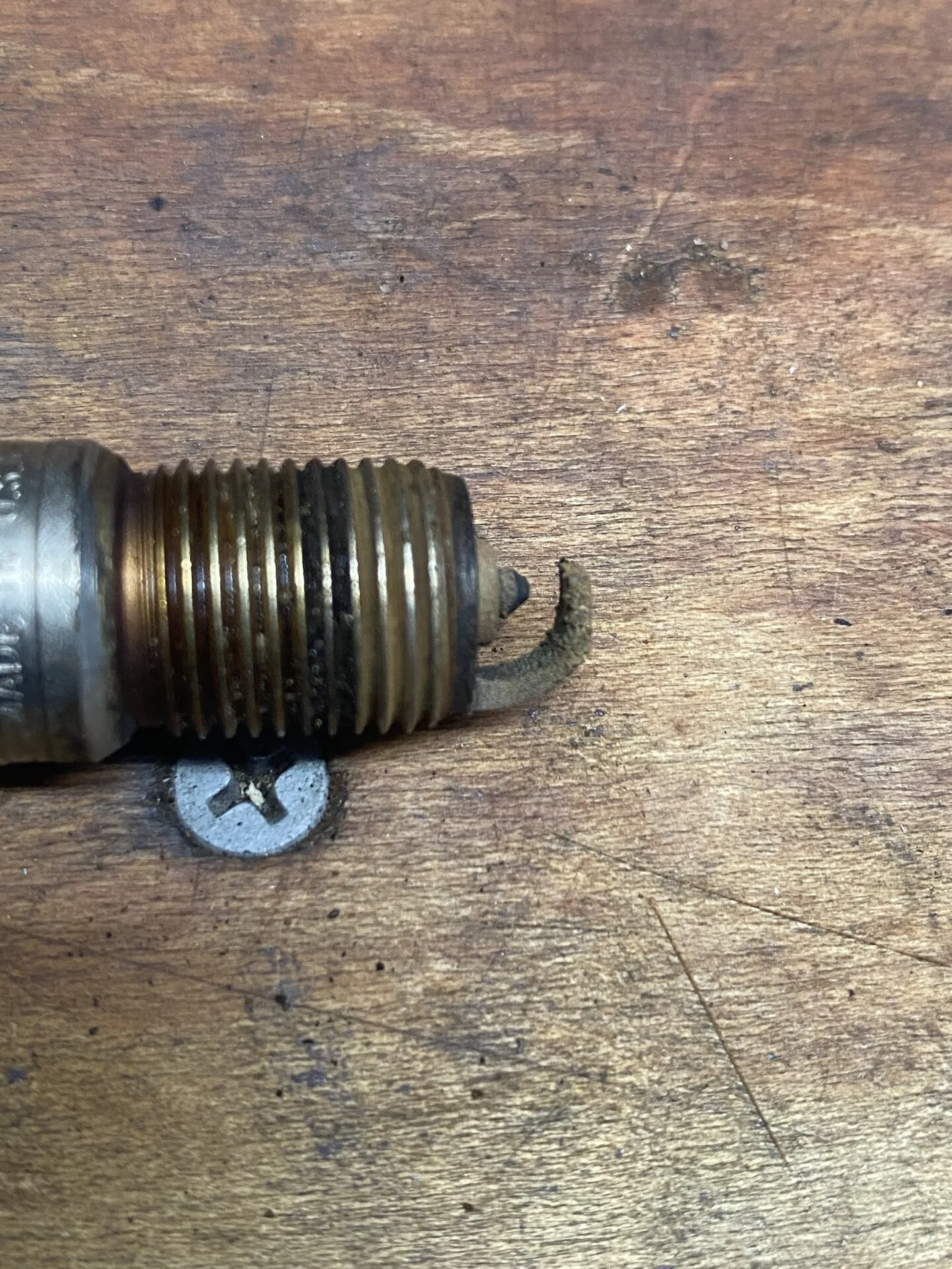

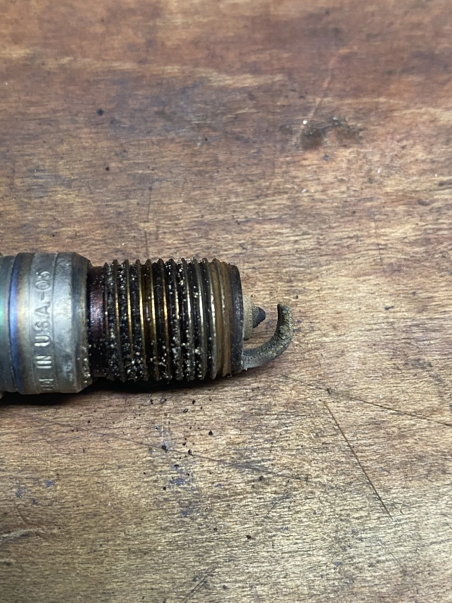

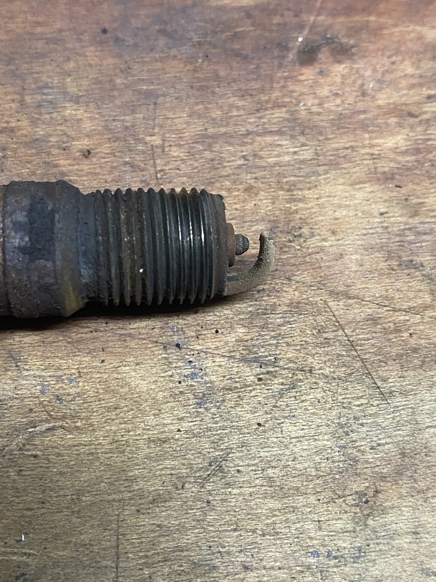

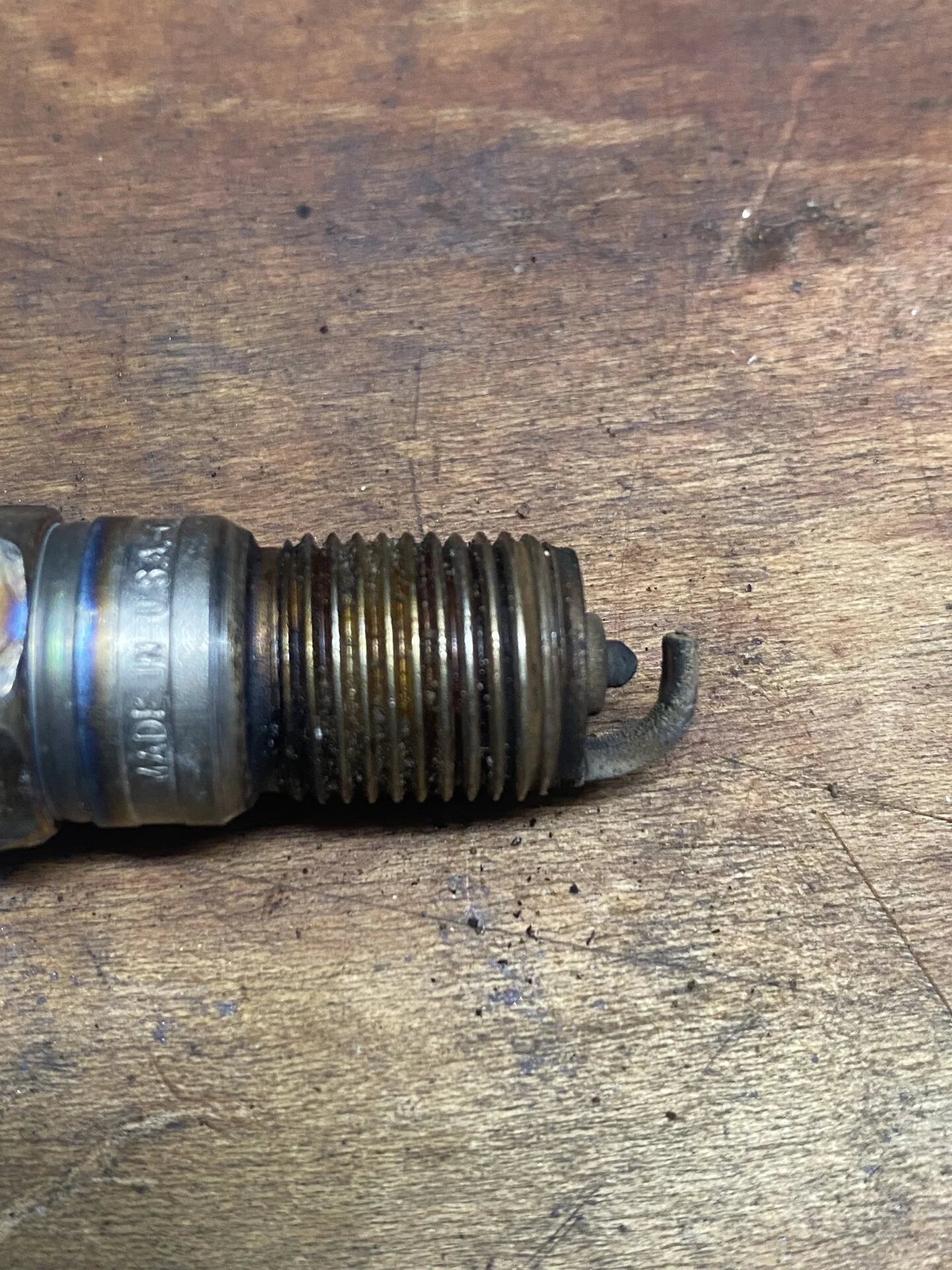

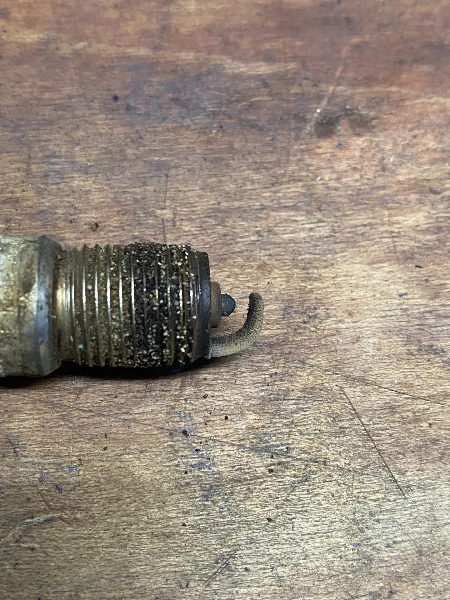

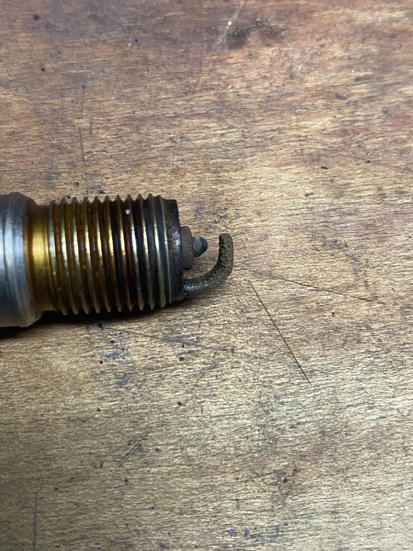

A little F150 update. I’m 6000 miles late on the spark plug change, but finally at 106,000 it started to get a little hesitation. I’ll give my daughter credit for noticing this and bringing it to my attention!!
I’ve many horror stories about changing these plugs, but after more research, it seems the ‘04 and up 3v plugs are the problem.
My ‘02 had the “not tight enough” plug issue. Blew one out under warranty many years ago. And the passenger side plugs where the head was replaced was noticeably tighter than the driver side. On the recommendation of some of the f150 forums, they went back in at 28 ft/lb.
It’s a tedious job, but I got it done with no issues, so pretty happy about that. And it runs much better!!
And you do not have to remove the fuel rail as many people say you do!!
Some pics of the old plugs if anyone is interested:
F6B6C945-3637-4775-98CD-1F319DFEAF91.webp B45827AC-2F19-4609-9E6C-DF2AAB836C5B.webp 392F4097-8B5E-4557-9767-F0AFF6F54EB0.webp 05768ECF-A33D-442E-AC7C-0A976A8CA048.webp 4D19C699-7E76-4C58-B400-A7EF5D08A852.webp
23FF05CF-1EC0-4B8E-89DD-30A463FC583C.webp 4BBF8B3F-1309-4C79-B7D4-97F3D48D6039.webp
