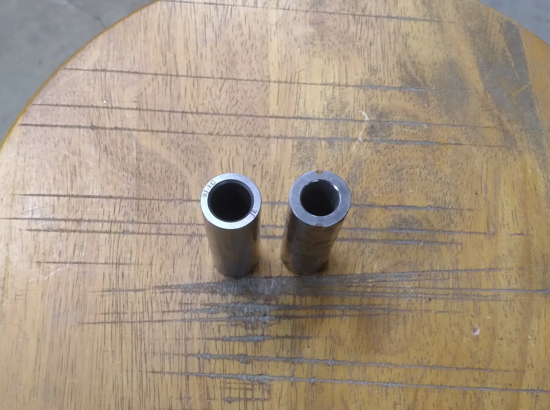

Here is a picture of the piston pin. The one on the right is an original from the first build. The one on the left is from the "builder" who allegedly knew what he is doing. This guy knew the engine was going to be over 1,200 hp and he put those limp dick pins in a set of $1,500 pistons...
For a N/A build they are a good pin, JE specked them for that piston. But if you are building serious HP, you check the option box for the pin on the right...

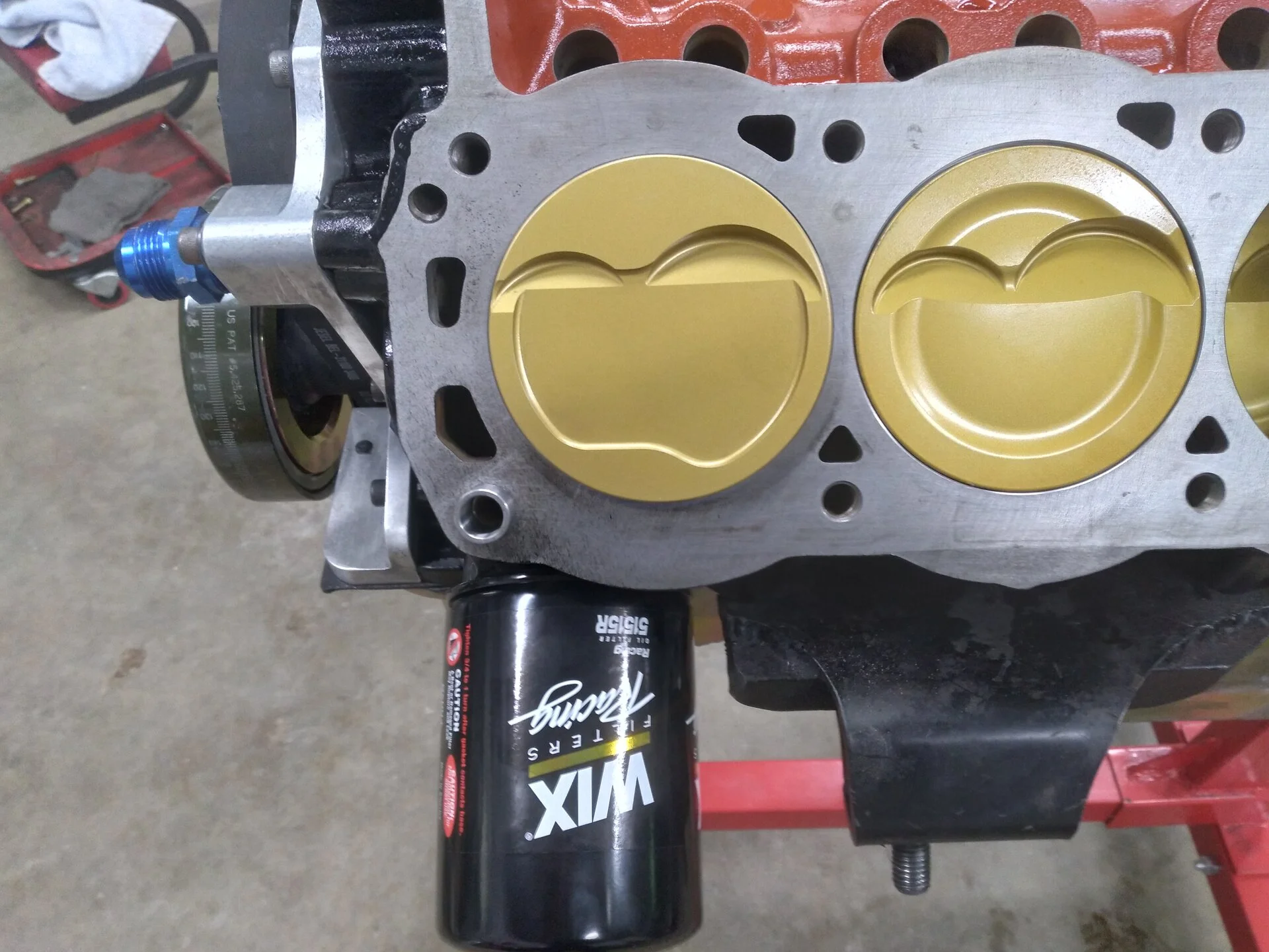

Here is a picture showing the difference between a 10.4:1 JE Piston (left) and the correct 11.0:1 piston I asked for originally.
The correct piston is from Diamond, not because I did not want a JE piston, but because Diamond was the only one that could provide the proper piston is less than 6 months.
It is hard to tell from the picture, but the dish in the piston on the left is right about .100 and the dish in the piston on the right is about .030
It is a thermal barrier coating on top and it has anti-friction coating on the skirts.
The thermal barrier coating helps protect the piston from the heat spikes from detonation should the tune be off. It gives a bit of a cushion before damage to the piston would occur.
I figured that. Did the pistons come that way, did you have it done locally, or is it DIY?
After seeing Hot Rod test a a diy coated piston with a cutting torch, I had the pistons, valve heads and combustion chambers on my most recent engine build.

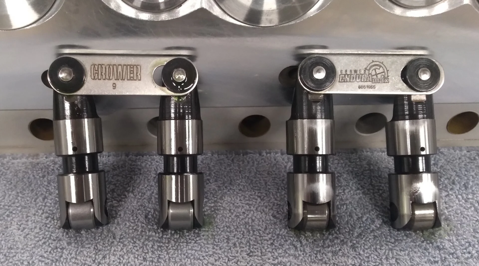

New solid roller lifters going in. "Old" ones on the right
When I went to buy the new lifter, the sales/tech guy at Crower told me not to use the ones I had been using (for over 4 years) as I did not spin enough rpm (8,400 max) and did not have enough lift at the valve (just over .720) to make the lifter work the way it was supposed. to. The Enduramax lifters have a bushing for the roller, while the other ones have needle bearings.
The other surprising thing about this is that the lifters I wanted to buy cost over $1,100 for the set and the ones he recommended are just under $700 a set. How often does a sales person talk you out of spending more money???
